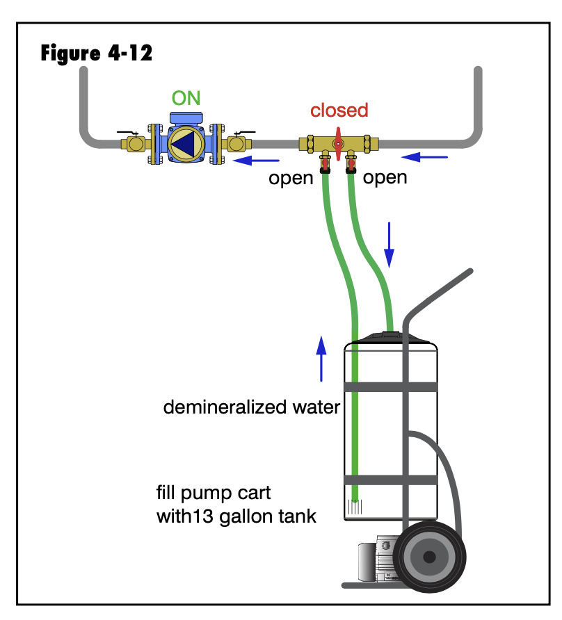

    Shut off the fill valve
    Fill the tank with about 10 gallons of water.
    Pump into one valve, purge back into the tank from the other valve/ hose.
    If there is a lot o0f air in the system you may need to top off the tank. As air comes out water from the tank replaces it.
    You can also add a cleaner to the tank and circulate that for a day, if you have a dirty system.
    This graphic shows pumping DI water into a system.

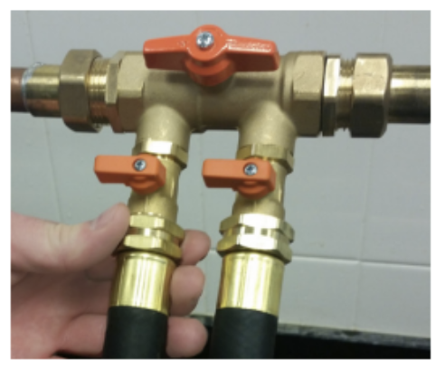

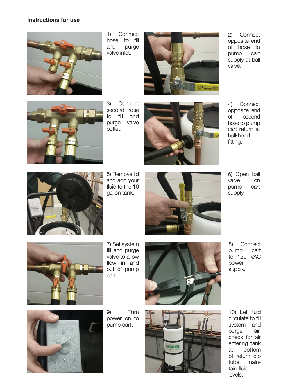

    Pretty easy instructions to follow. even has pictures:
    Looks like you need to add their three valve fitting to the piping somewhere
