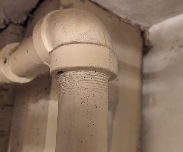

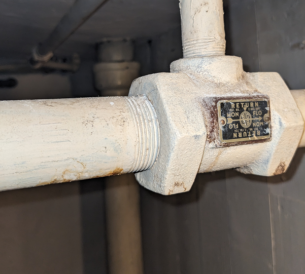

I have a Monoflo system from the 50s and I will be replacing the boiler with a Weil-McLain CGa-6 cast iron boiler. I will be keeping the Monoflo piping and radiators, but I will make some changes to the near-boiler piping. I'll be using black steel pipe and iron fittings. I'm trying to anticipate any problems I may have beforehand, so I can be more prepared when I do the install. One thing that concerns me is getting the old cast iron piping apart. I have never worked on these particular pipes, so I don't know if they'll come apart, if they'll be seized, if the threads will be usable, etc.
To anyone who has a lot of experience taking this type of piping apart, do they generally come apart easily? Are the threads usually clean enough to reuse with black steel pipe?
My other question then is, if i do have to end up cutting the pipe, how could I mend it or connect it with new piping? What are some techniques/methods that can be used? From the research I've done, it doesn't seem that I'd be able to easily cut and re-thread them. And I haven't really found any sort of compression couplings or sleeves that seem like a durable, leak-proof fix.

    You can crack Cast Iron elbows with a sledge hammer. That will get you to the threaded pipe end that can then be converted to copper to female adapter for easy repipe job.
    I have also used 2 pipe wrenches with a come-along to pull the handles together and break the pipes loose with brute force leaving you with a female thread to use a copper x male adaptor for an easy repipe
    Trying to get all the new piping from the new boiler to the existing system piping will be difficult. It can be done if you have a pipe threader, but shy of that, you can make custom length pipes with copper much easier. If you are not that good at soldering 1-1/2” fittings, then you might look into renting a propress tool and using the no solder approach.
    CGa-6 is a pretty big boiler with 122,000 NET output. If you really need that much heat, that will require a 1-1/4" one pipe main and those photos look like you have a 1" main with a 3/4" branch to the radiator. How big is your McMansion? I have a feeling that you an use a CGa-4 if you do a proper load calculation. maybe even smaller. If you are using the old boiler size as a reference for the new boiler and then going a little bigger just for good measure, then you will surely be purchasing an inefficient oversizes boiler for your system.

    @EdTheHeaterMan Thanks for the info. I appreciate it. My house is about 2,100 sq ft. The current boiler is a very old American Standard, and it is rated at 210,000 BTU. In the past, an HVAC guy mentioned it was way oversized. Also, I had a company come out and give me an estimate. They did their heat loss assessment and recommended a CGA-5. I did my own heat loss assessment, and came up with a total of 133,000 BTUH heat loss. My house was built in the 1920s, so the insulation is not all that great. Also, the main pipe is 1-1/4" and the brach pipe is 3/4". Those pics are a bit misleading.

    The pipe may seized but they likely aren't very corroded so if you break or carefully cut the fitting off a pipe or pipe out of a fitting you should be able to adapt to copper. Since it is a closed system the corrosion should be minimal unless there were leaks that were ignored for years.

    With the monoflo system you need to have enough circulator to have enough flow in the mains so that the water takes both the main branch and the branch to the emitters. The main branch has less resistance than the loops out to the emitters so it is common to inadvertently under pump monoflo systems and have issues with some of the emitters heating.

    My house had the same monoflow fittings, they came apart fairly easily with a big pipe wrench.
