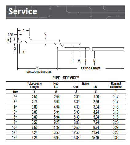

There are no indications of leakage from the flange to elbow connection, so I am unsure of doing a replacement. Further I do not know how deep the inside socket is in the elbow. If the bottom of the flange already sits at the end of the elbow, replacing it will not reduce the height and is a waste of time. Here are dimensions from the Charlotte Pipe web site. I’m guessing it is a service pipe, not no-hub and the depth is “Y” in the sketch. My most reliable local plumbing supply house is closed today.

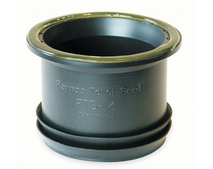

I am considering placing a spacer the shape of the toilet footprint to raise the entire toilet and provide additional stiffness, then grouting or caulking any gaps. Additionally, I came across a 4” Fernco flexible fitting (FTS-4) that adheres to the bottom of the toilet and has ridges.

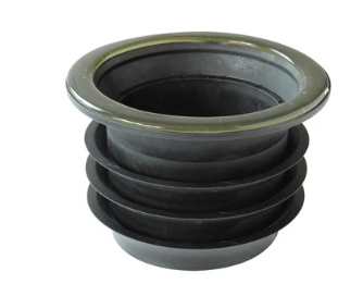

    The wax vs non-wax solution is to use this FTS-4 Fernco, which does not have anything that reduces the opening at the bottom to 3". I want the entire diameter of the opening through the fitting, no taper/horn (like I used in 1989…obviously I didn't think to cut back on the horn then). Additionally, the flexibility of the fitting will accommodate some unevenness and possibly movement, so I am hoping it will prevent a future failure for a long, long time. Here's the actual one I was able to find locally at FW Webb. It is different from the one I first found. I snaked the line yesterday to make sure there is no obstruction.

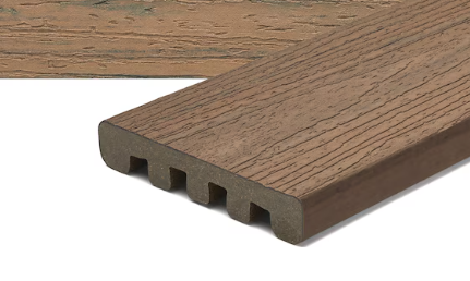

    I planned to use PVC beadboard for the raising of the toilet, but Trex may be a better choice. The downside is the beadboard would be a single piece around the entire footprint of the toilet compared to multiple pieces at the perimeter. The physical interface of the toilet to the floor is a narrow bottom edge, about 1/4", but more a line than a surface, so I think having a single piece might be more robust, even if there are two layers to get the needed height. It would certainly take less work. I'll give it a serious look this morning.
    One thing I found is Fernco says to use rubbing alcohol to remove the wax residue from the toilet and flange. The wax was black and hardened and it took at least 2 hours to scrape the hard stuff and soften what was left. Tiny pores in the underside of the toilet where the new fitting attaches are nearly impossible to get totally clean. I am sure some is just discoloration weeping into the pores.
    I don't mind overdoing some things to make as absolutely sure as possible I won't have to do the job again. This is one of those cases…the adhesion of the adhesive on the fitting to the toilet is critical. The mechanical ribs to the inside of the flange nipple to the cast iron should be as good as anything else, especially considering there will be no reduction to 3".

    If I use Trex, I might use 6 pieces because of the closeness of the bolt holes to the edge of the toilet. Additionally since Trex is tongue and groove, I would have to cut back the tongue (easier than cutting off the groove) so there is solid material below the perimeter of the toilet. Just something to think about, if I can't find just plain boards. Either way, I found a flexible 1/2" x 3/4 base cove molding in a light color, close to the color of the toilet that can hide whatever I do.
  • SteamingatMohawk
    SteamingatMohawk Posts: 1,159
    This should work. Although it looks like it is capped, but it is probably better than what I had been planning go use.
    The width of the toilet is about 10", so I will use 4 pieces with some trimming on the inside to fit the width.
