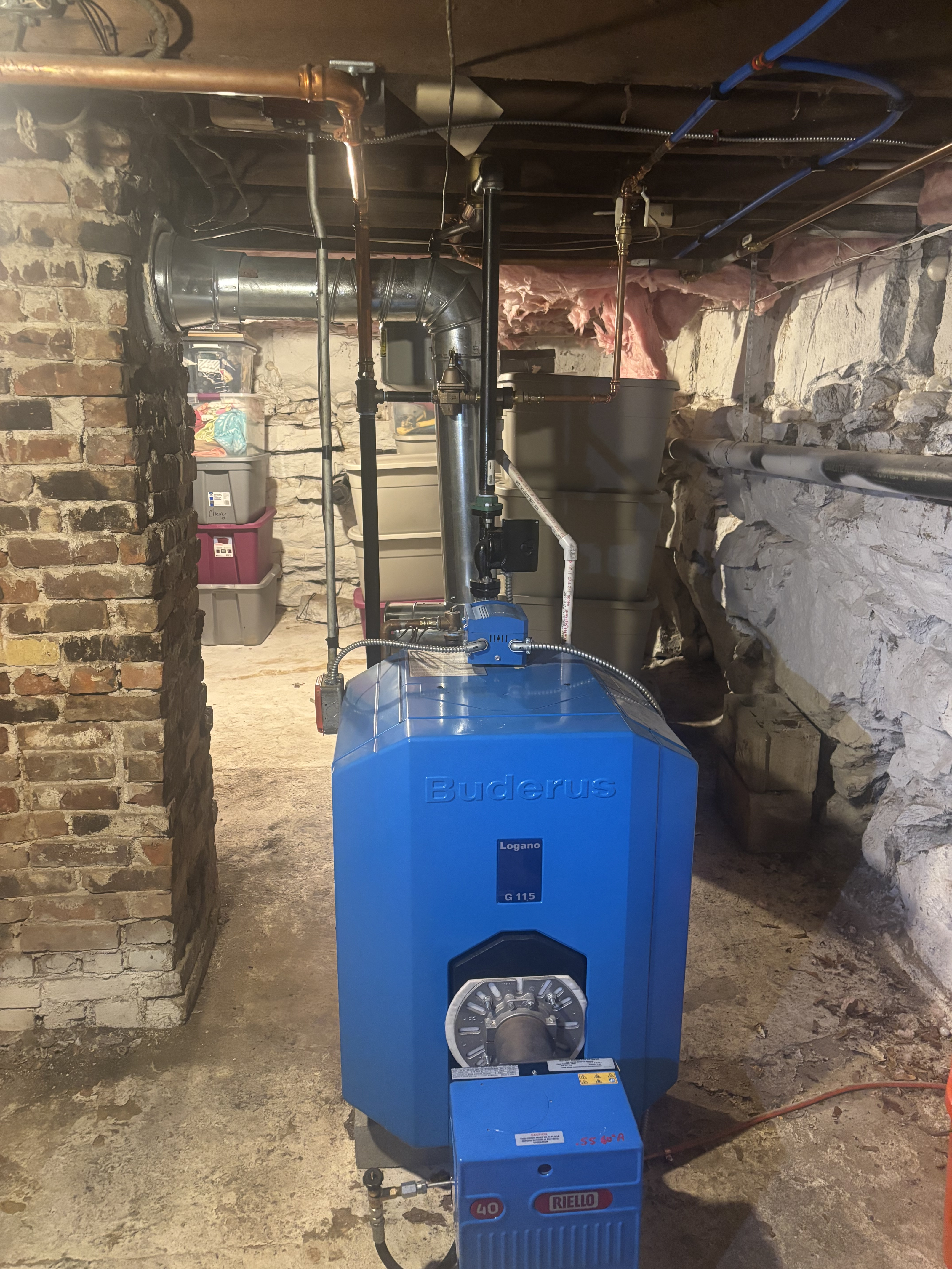

hello, I had a brand new buderus boiler with a riello burner installed in my home in 2021. Ever since it was installed it never worked properly and kicks on and immediately shutting right off over and over and not staying running. I’ve had several heating contractors adjust the air, replace the control, replace the nozzle several times and I installed a chimney liner. Still have never had a full winter where it ran properly without having the same issue. Any thoughts? Thanks.

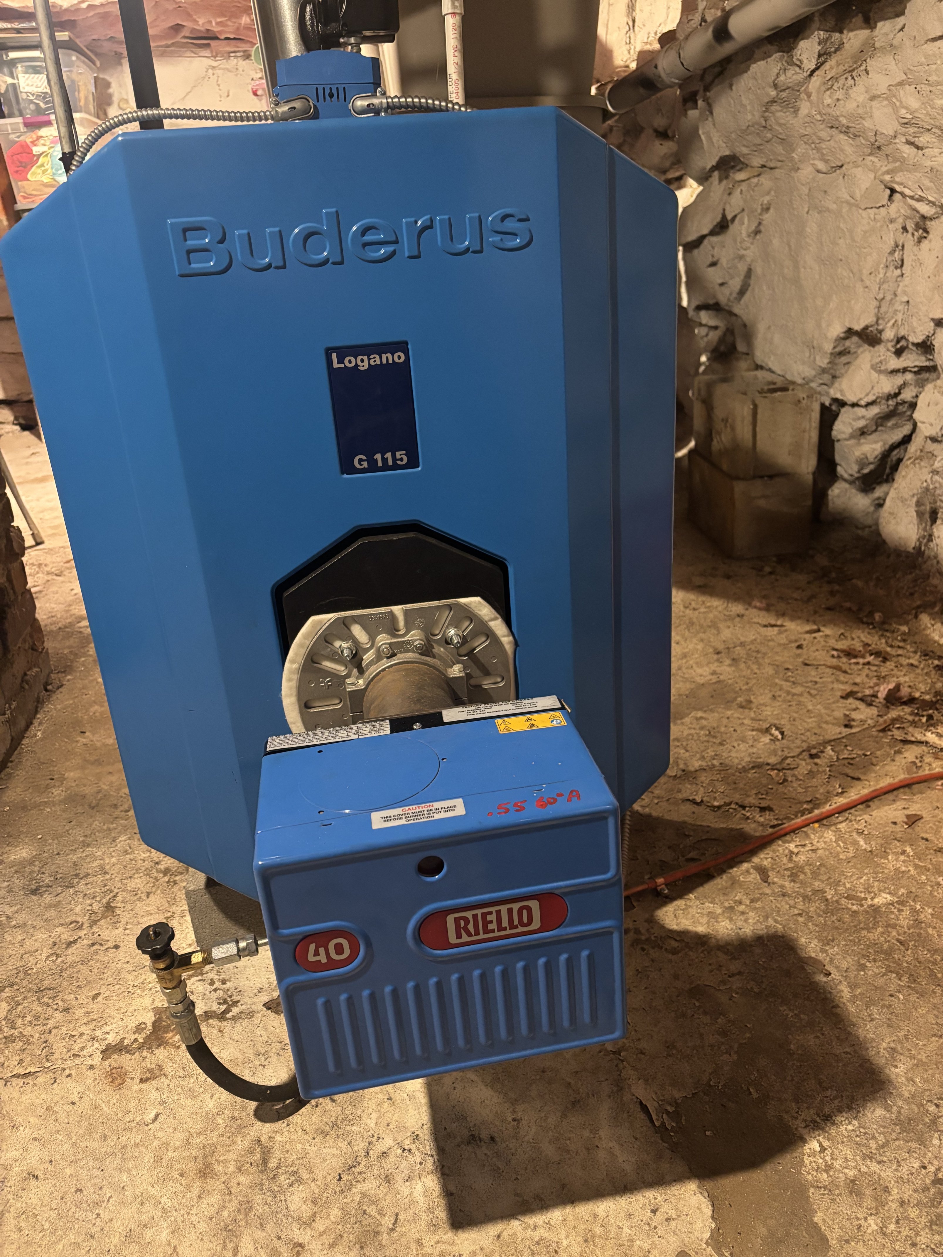

    What model Buderus? What model Riello?

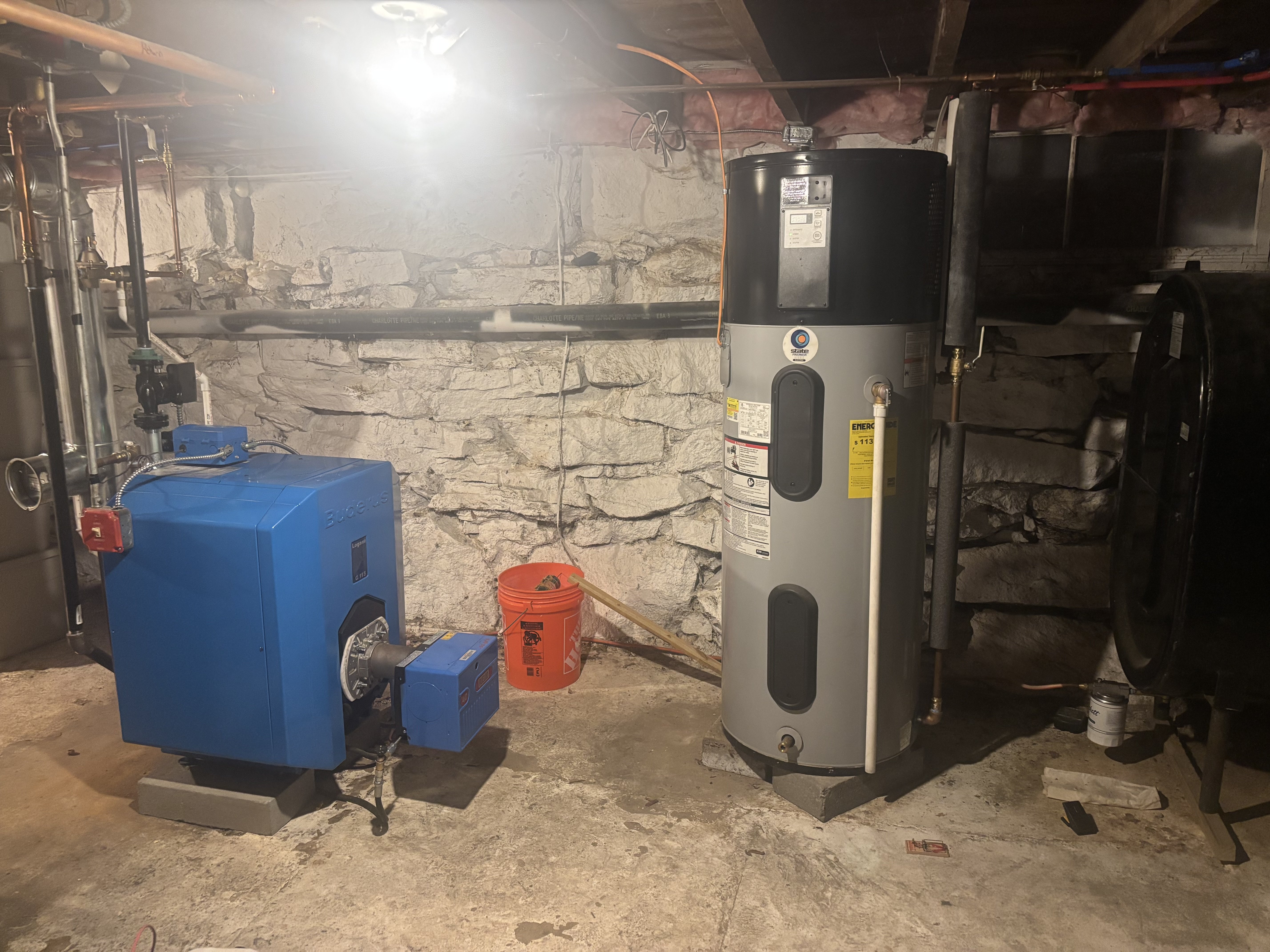

    Where is the oil tank?
    Is the oil line off the bottom of the tank and runs along the floor or does it run overhead?
    1 pipe or 2?

    it’s the Buderus Logano G115 WS US/CA And Riello 40
    The oil tank is right near it and the line is off the bottom and goes along the floor.
    I’m guessing 1 pipe? It’s 1 zone and I have 1 chimney

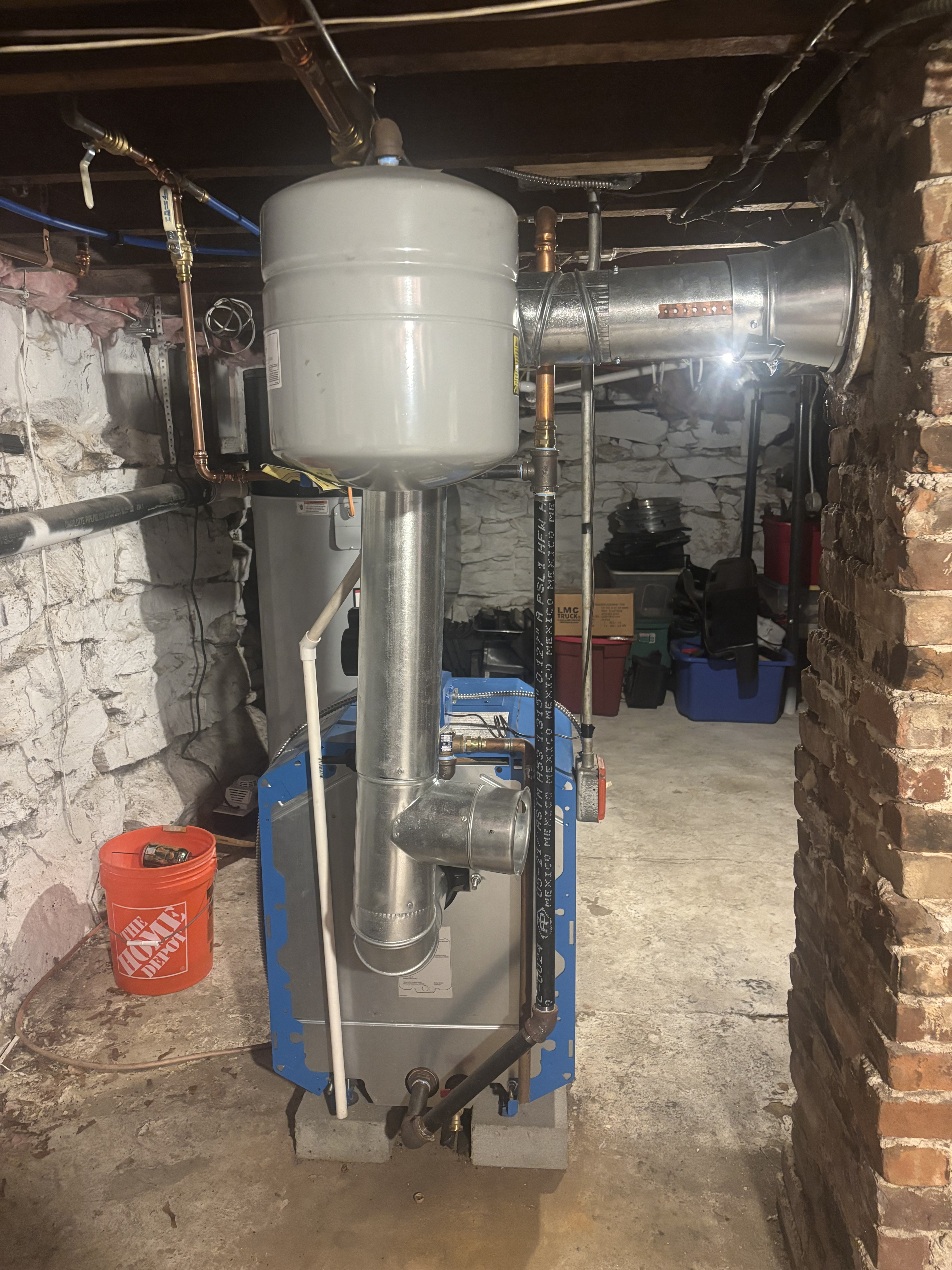

    Would you be able to post a photograph or two of the boiler from far enough back to see how it is connected to the chimney including the burner and the vent connector in the same shot.  Take it from more than one side so we can see stuff from different perspectives, and to see if there are any additional controls that are mounted on the boiler or on the walls near the boiler.   That often pinpoints someplace to look.

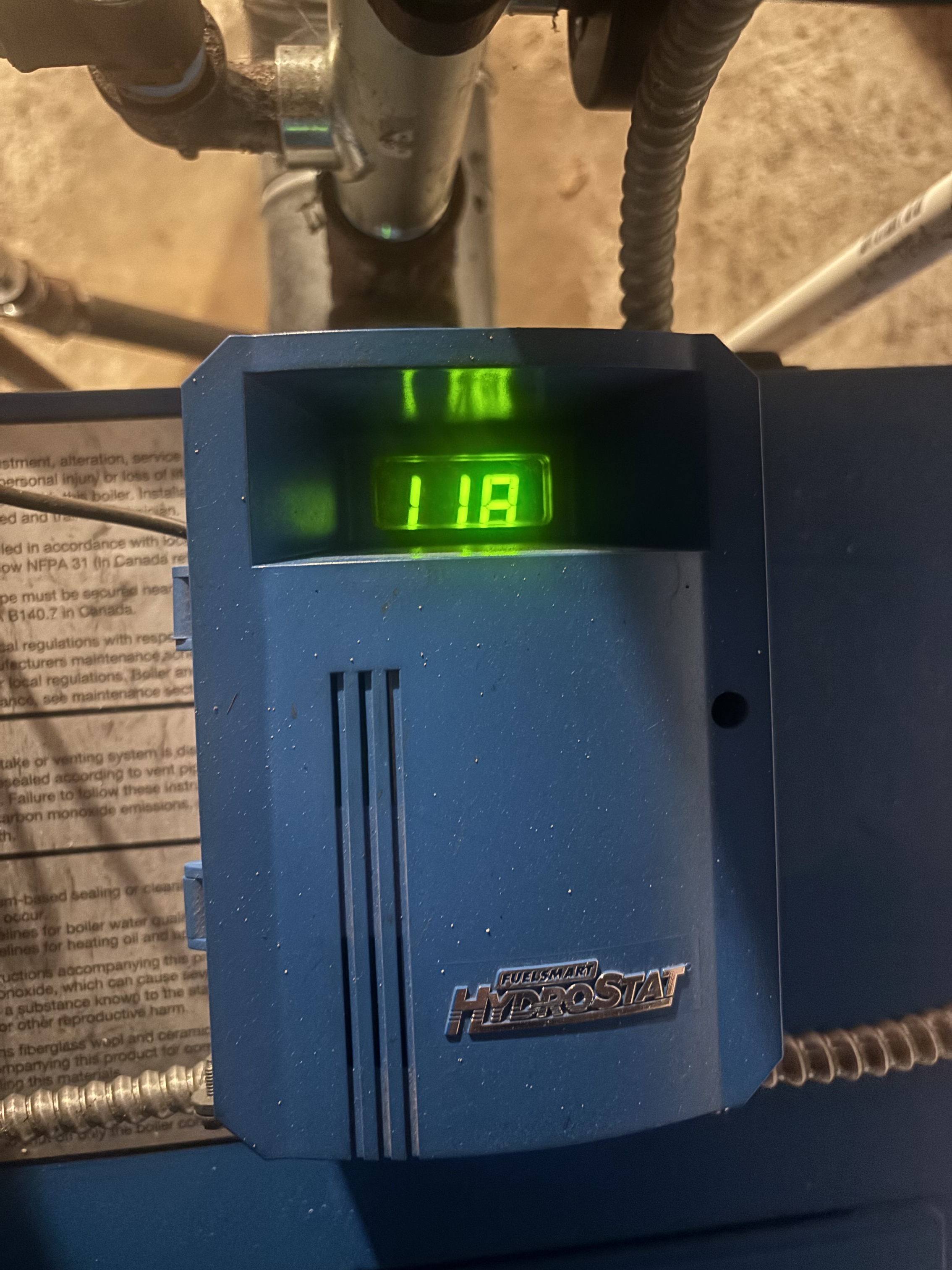

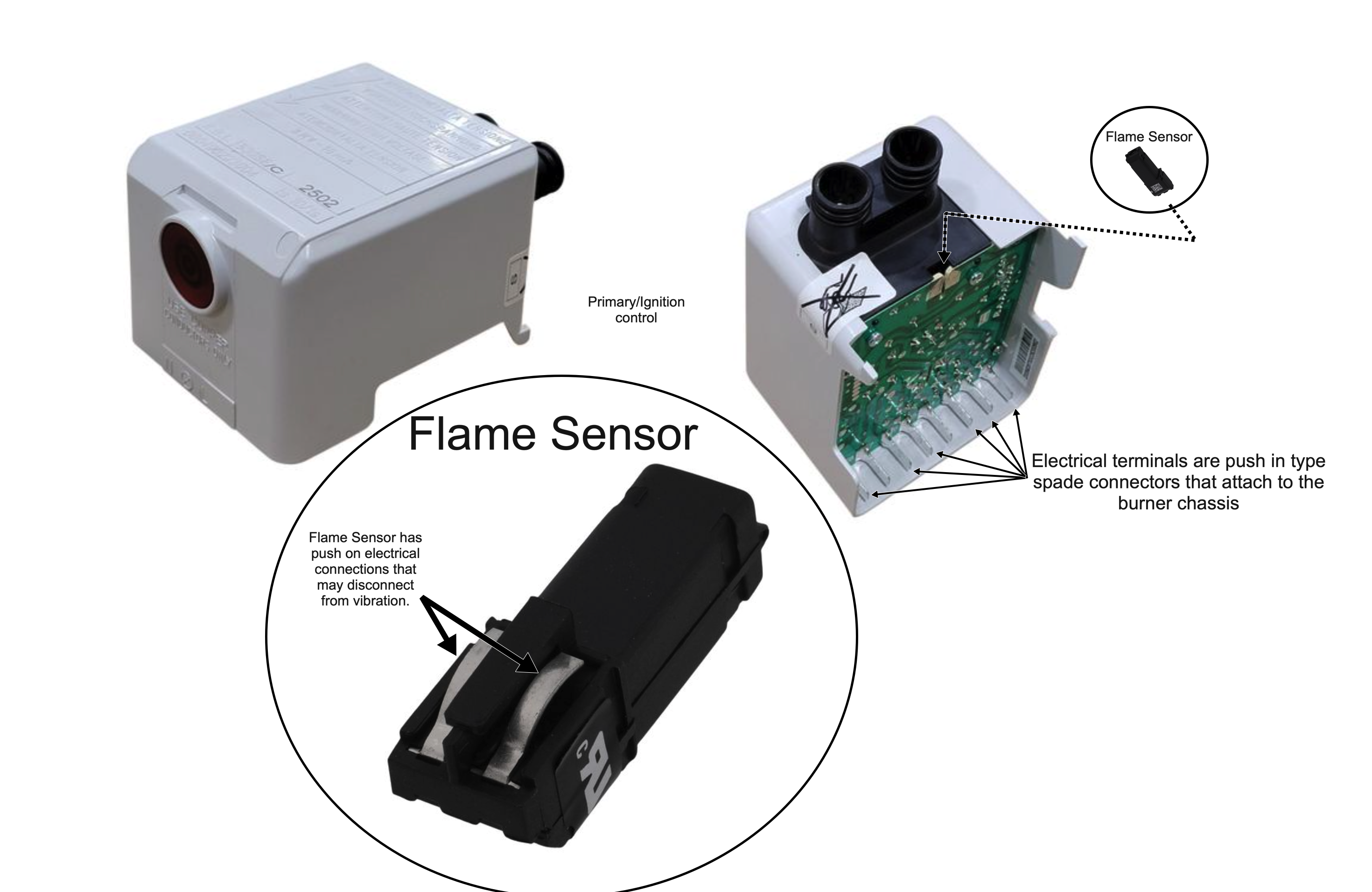

    Can you take a picture of that control with the part number visible so I can look up how that control is supposed to work?

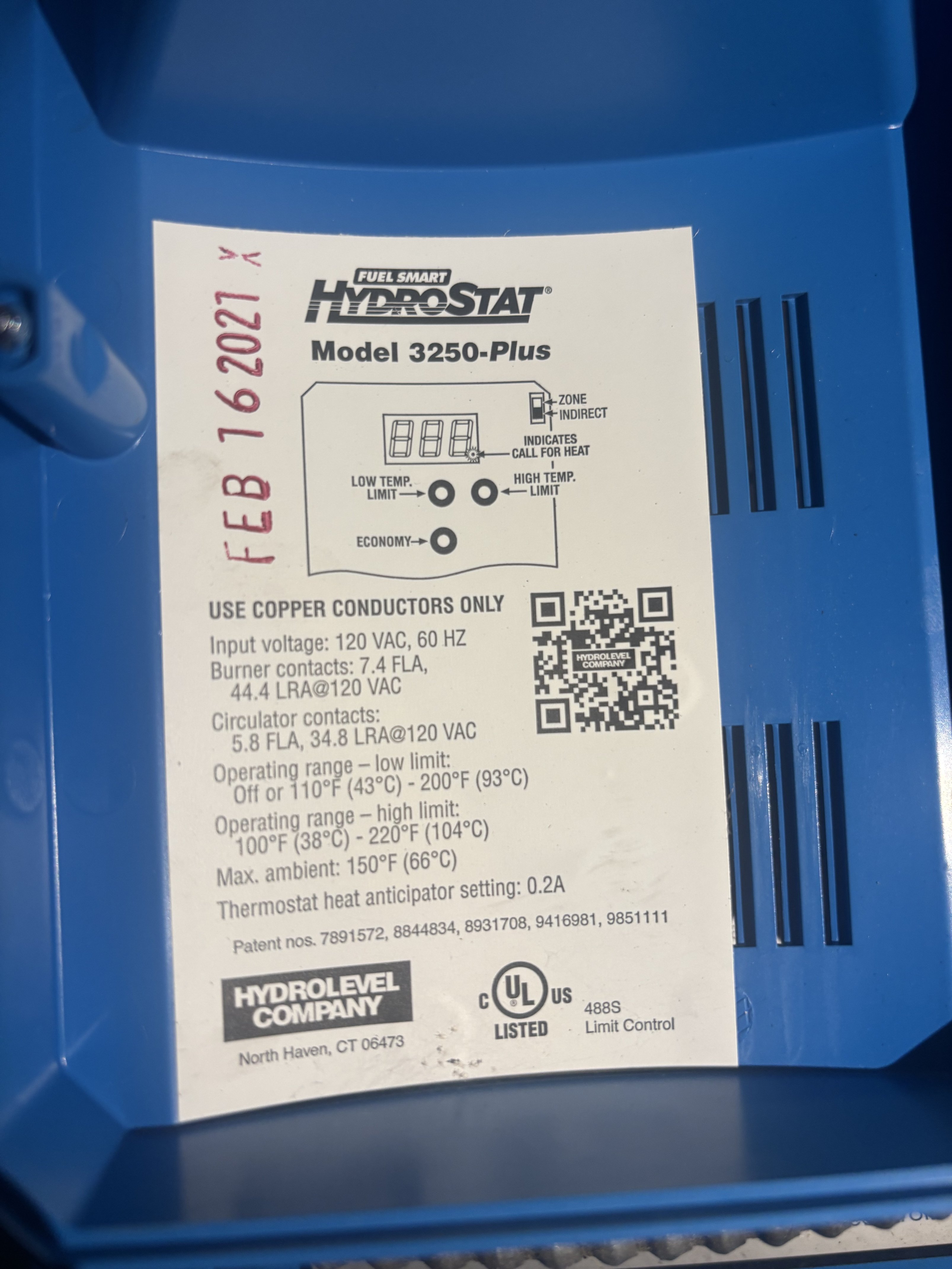

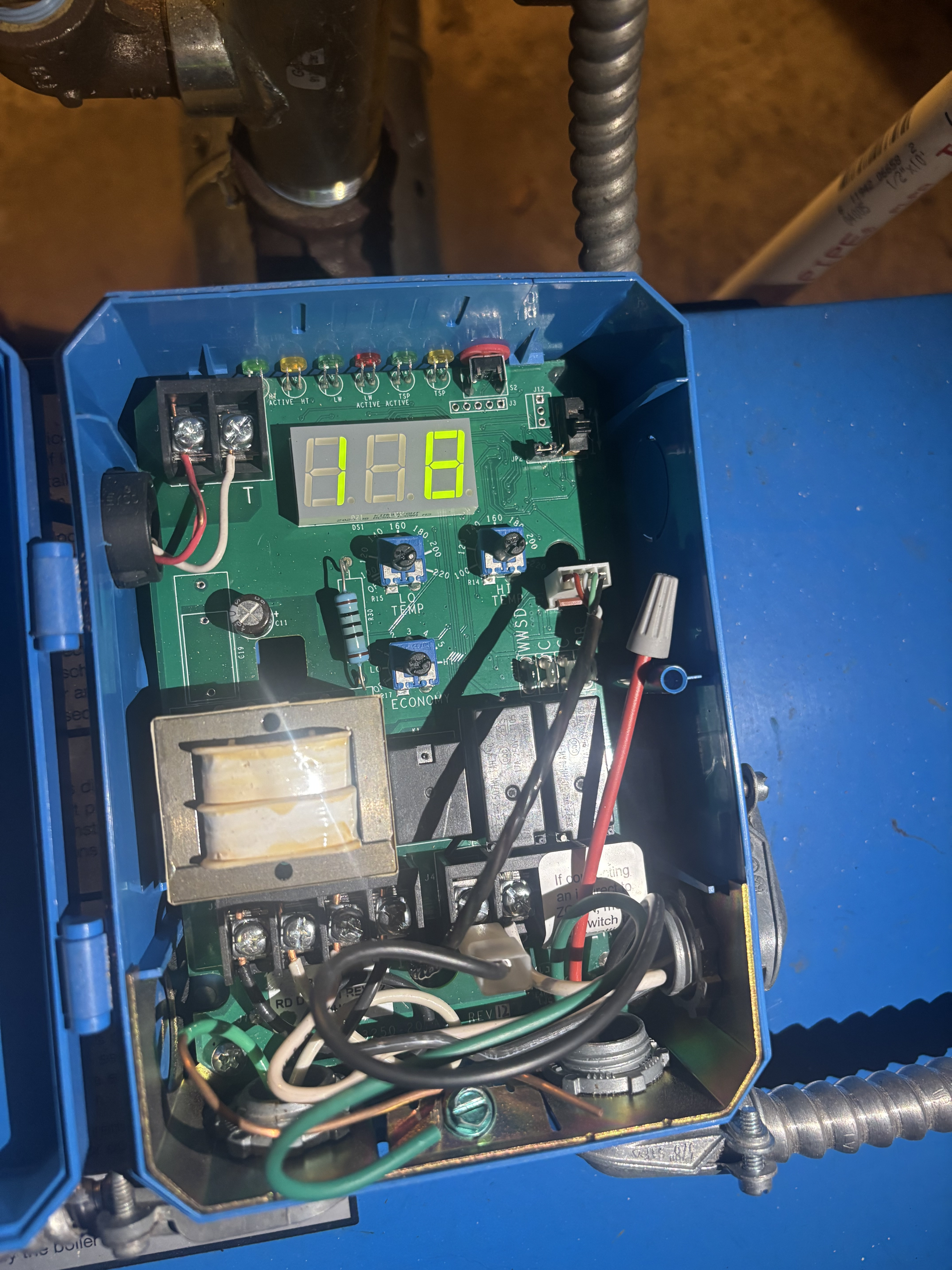

    is this the control you are referring too?
    EdTheHeaterMan Posts: 12,947
    edited April 10
    Thanks for the photos.
    I was looking for a pressure switch that might be part of some type of draft-measuring device or control. You do not have that, so a pressure switch is not your problem.
    The Hydrostat with the blue cover is also not the cause of your problem. That control is easy to test to determine whether the short-cycling problem is originating from it, and your technician would have ruled that out in fairly short order.
    That leaves the primary/ignition control, which is a Riello proprietary part that fits no other brand of burner. That is where you are likely getting the short-cycling problem. It may be caused by vibration and a poor connection of the flame-sensing eye, which is a replaceable part, or it may be related to the way the control plugs into the burner chassis.
    I believe I have experienced that problem once or twice before. I replaced the flame-sensing eye first, and when that did not solve the problem, I replaced the control.
    Other than that, there may be something blocking the view of the flame from the flame-sensor eye.
    If there is a blockage flapping in the line of sight of the flame sensor, that is not something a rookie burner mechanic might normally look for. I have made it a habit to shine my flashlight in and look down the air tube of every oil burner to check for such obstructions. It is second nature to me now. Every oil burner air tube gets looked at before the nozzle assembly is replaced.

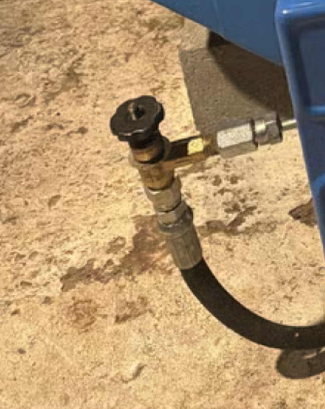

    Sounds to me like it’s losing its prime.

    Unlikely, but it is a possibility. The Riello control has a 10-second pre-purge that gets the pump pressure up to operating pressure before the valve opens. When the valve opens, the flame is sensed, and then the flame goes out.
    It could be that the flame is going out as a result of air in the pump, but I do not see it coming back on and firing again just to lose oil pressure again and again. I see more of a control problem, where the flame is sensed and then the valve loses power from vibration, or the flame-sensing eye loses connection due to vibration. That would put the burner control into a relight scenario within a few seconds of the loss of flame.
    I see the fuel line on the floor, and I believe the oil tank is using a bottom outlet fuel line from the tank to the burner, so it is unlikely that the prime is being lost.
    If the bottom of the tank is in a lower part of the basement and the tank is low on fuel (near the bottom third), then the loss of prime is a possibility. However, I would need more information about the tank location since it appears to be only a few feet away.
    Is the bottom of the tank lower than the burner fuel inlet?
    Is the tank below one-half on the gauge when this problem happens?

    The oil tank is only a few feet away and there is currently less than a half tank but the problem still happens even with a 3/4 full tank. The floor isn’t lower where the tank is.
  • gnicole
    gnicole Posts: 14
    in my third picture you can kind of see the end of my black oil tank all the way on the right.
    HVACNUT Posts: 7,784
    If short cycling is "pre purge, ignition, then immediately back into pre purge", and that cycle keeps repeating until steady flame? If so, its air and/or draft related.
    The installer needs to set draft and combustion per Buderus/Riello specs. With a Zero smoke.
    Very sloppy installation. It looks like an OEM burner, but a retrofit air tube assembly. I hope its sealed and has the correct insertion depth. The draft regulator needs to be about half way up the vertical (level and plumb). No isolation valves for the circulator. Pumping into the extrol tank. No purge station on the return. Even though its probably mono flo, it would be nice. Flue breaching isn't sealed. And maybe its up to code in your neck of the woods, but I've never seen a connection like this.

    Thanks for that description and photo. You are not losing the pump prime with that setup. The bottom of the tank is higher than the level of the fuel pump on the burner. The only way to lose prime in that setup would be if there were a blockage in the fuel line. In that case, the pump would draw fuel from the tank under a vacuum, and that could allow air to enter through the filter gasket or another fitting in the fuel line.
