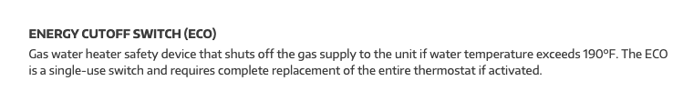

    hot_rod Posts: 28,704
    The ECO energy cut off is built into the gas valve. From AO Smith
    And snap discs on electric tanks
