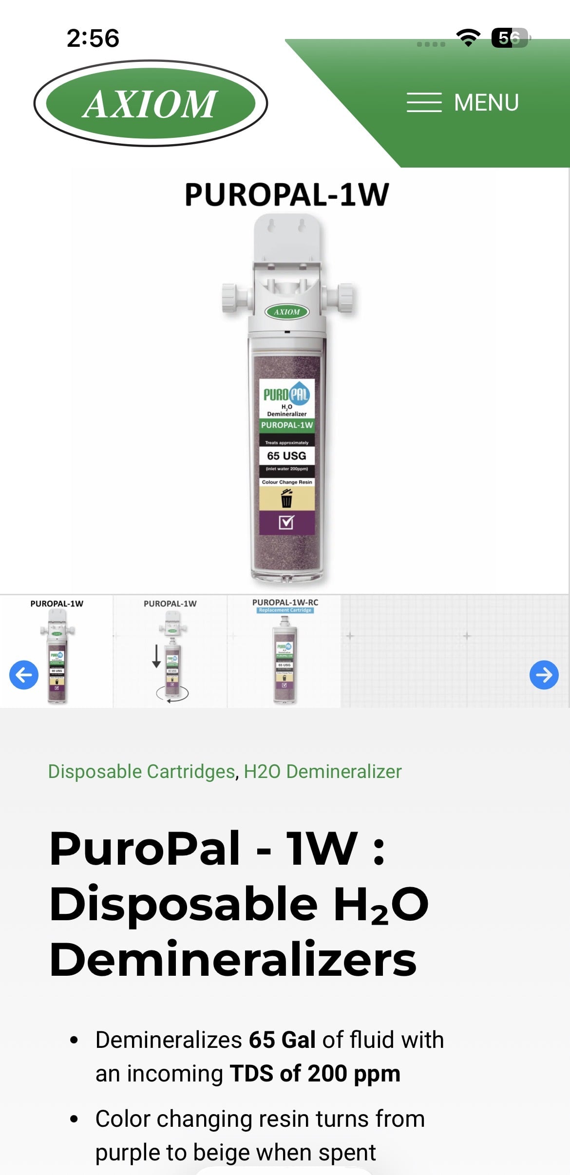

You can buy a one time filter cartridge to fill the boiler which takes 90% of the minerals out, it is best to start with good water, regardless of copper stainless, cast iron, aluminum material
