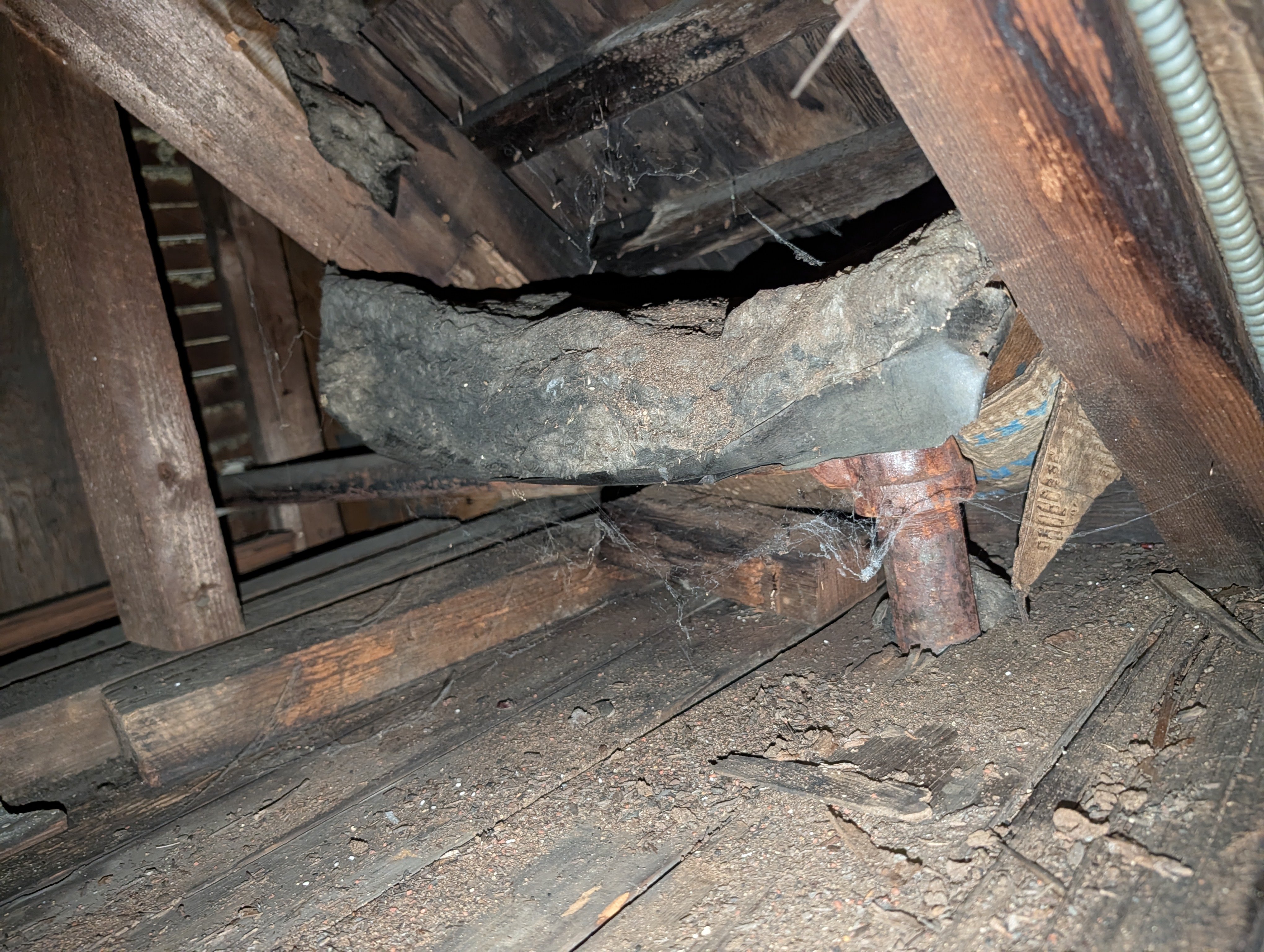

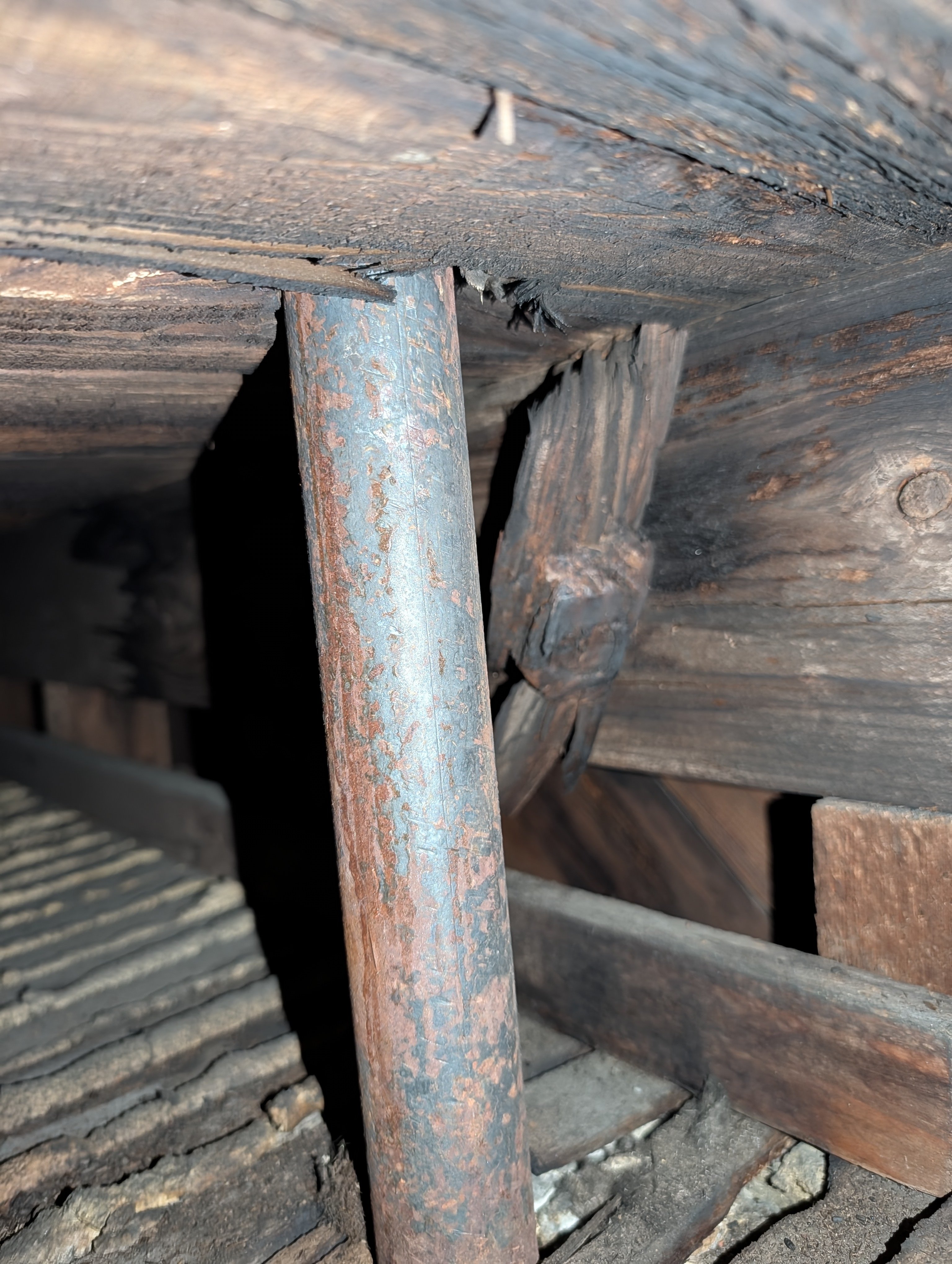

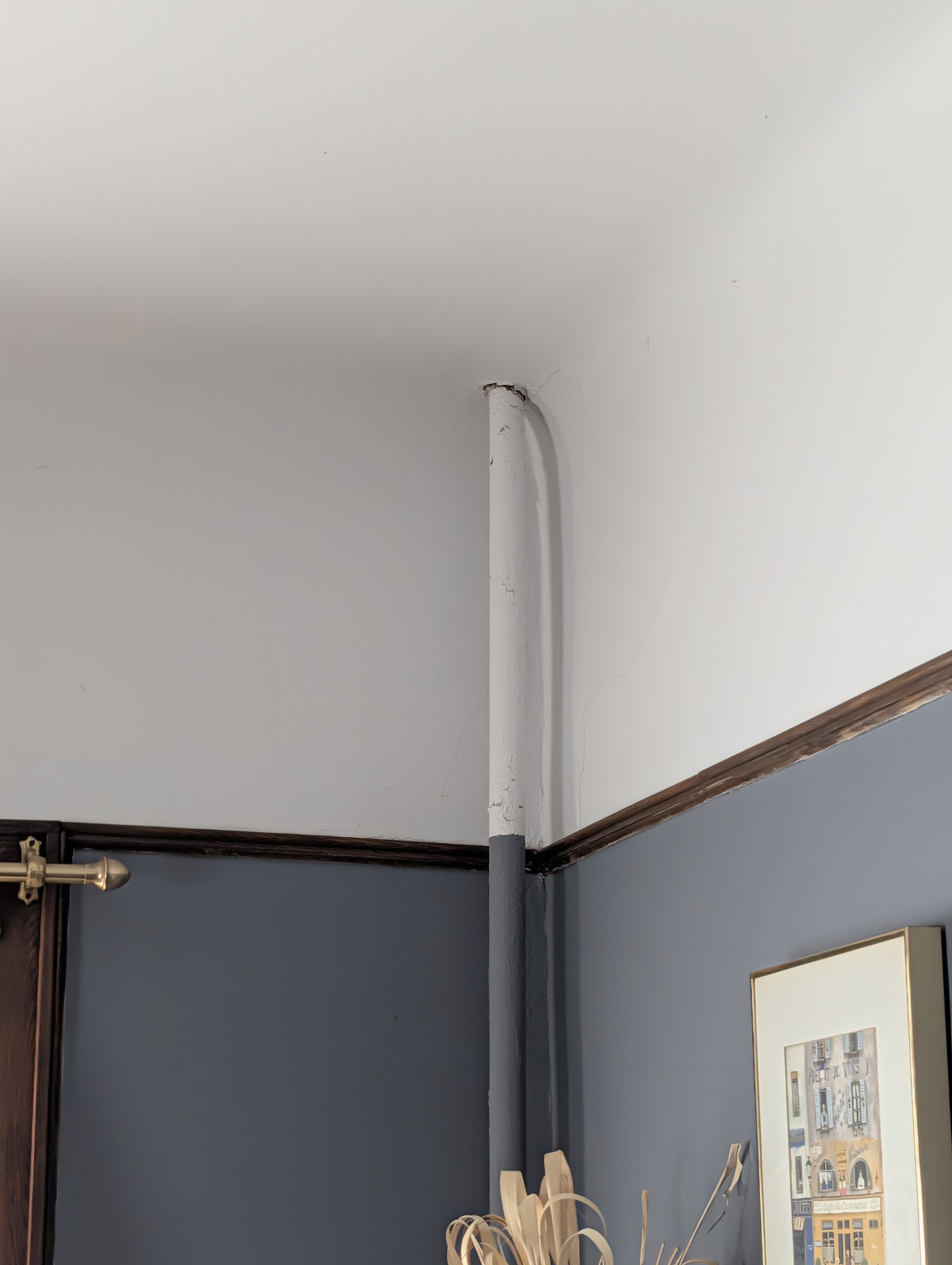

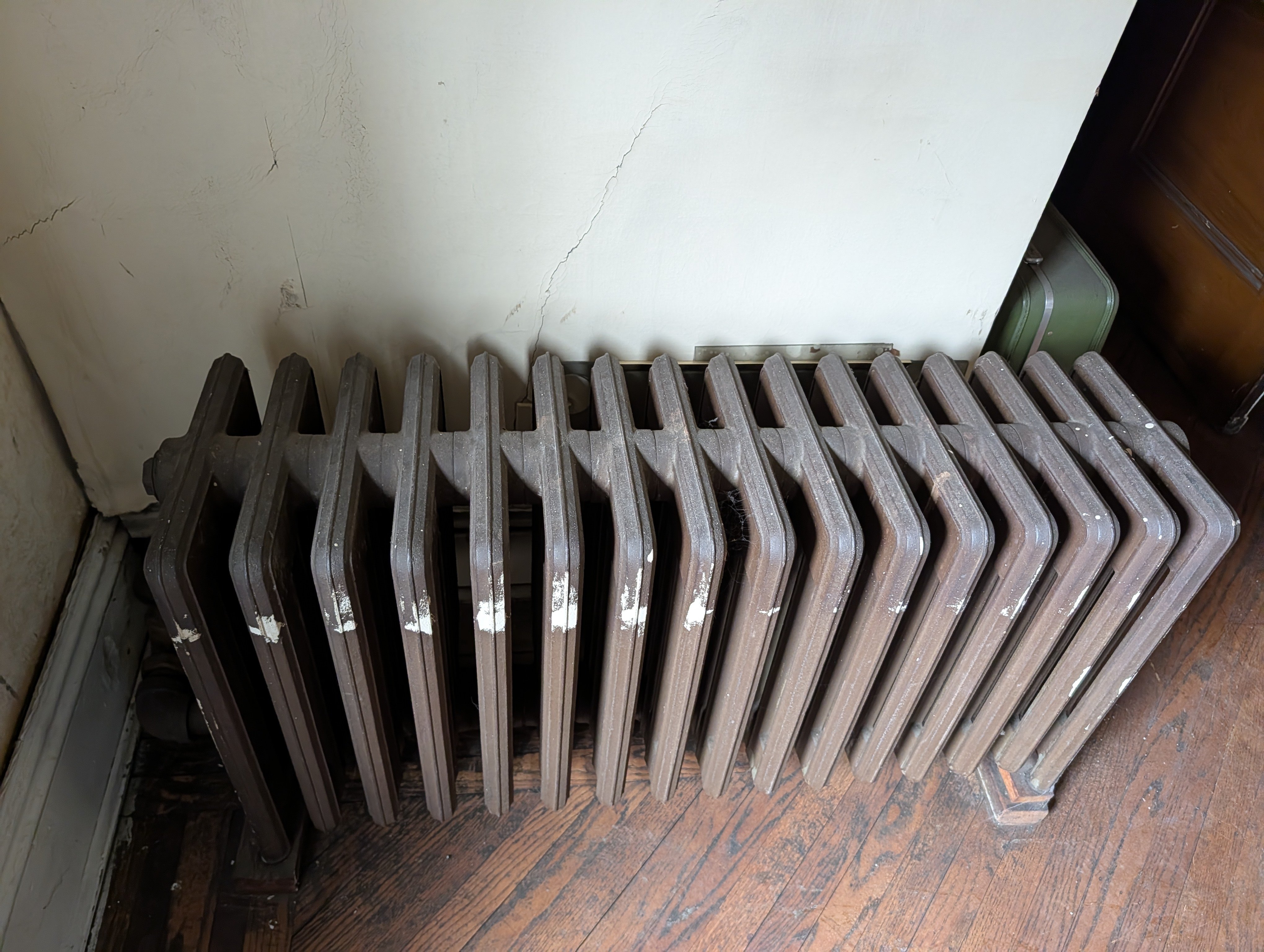

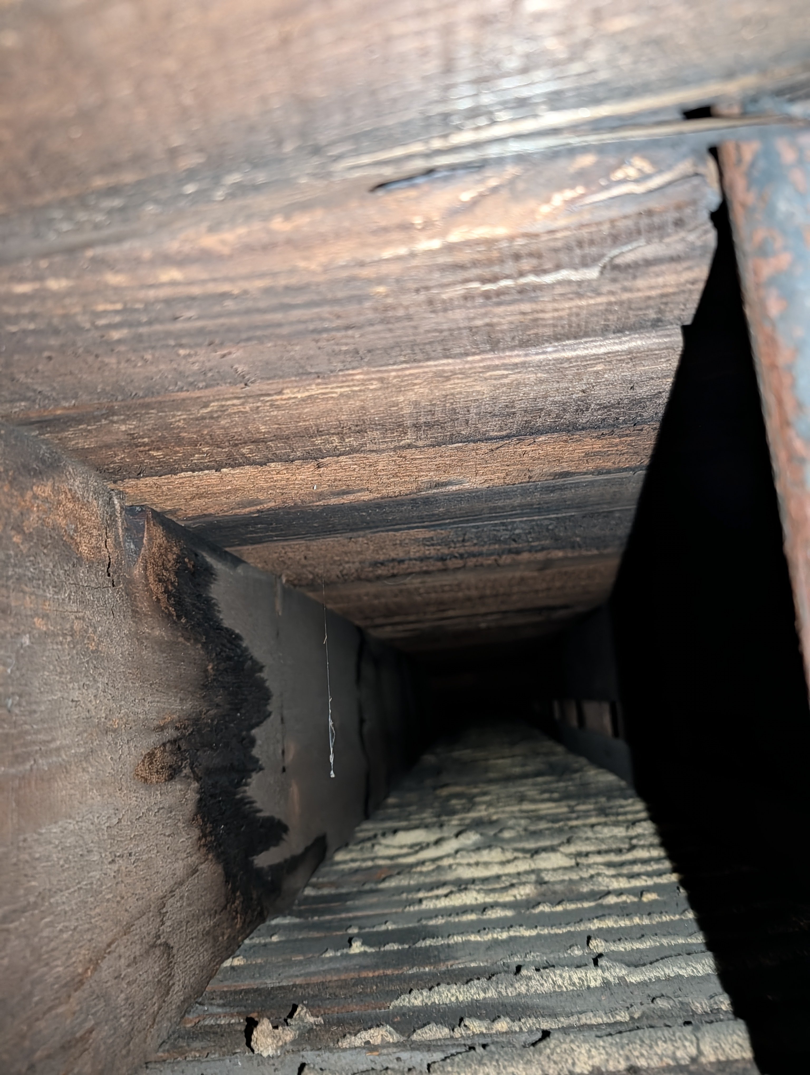

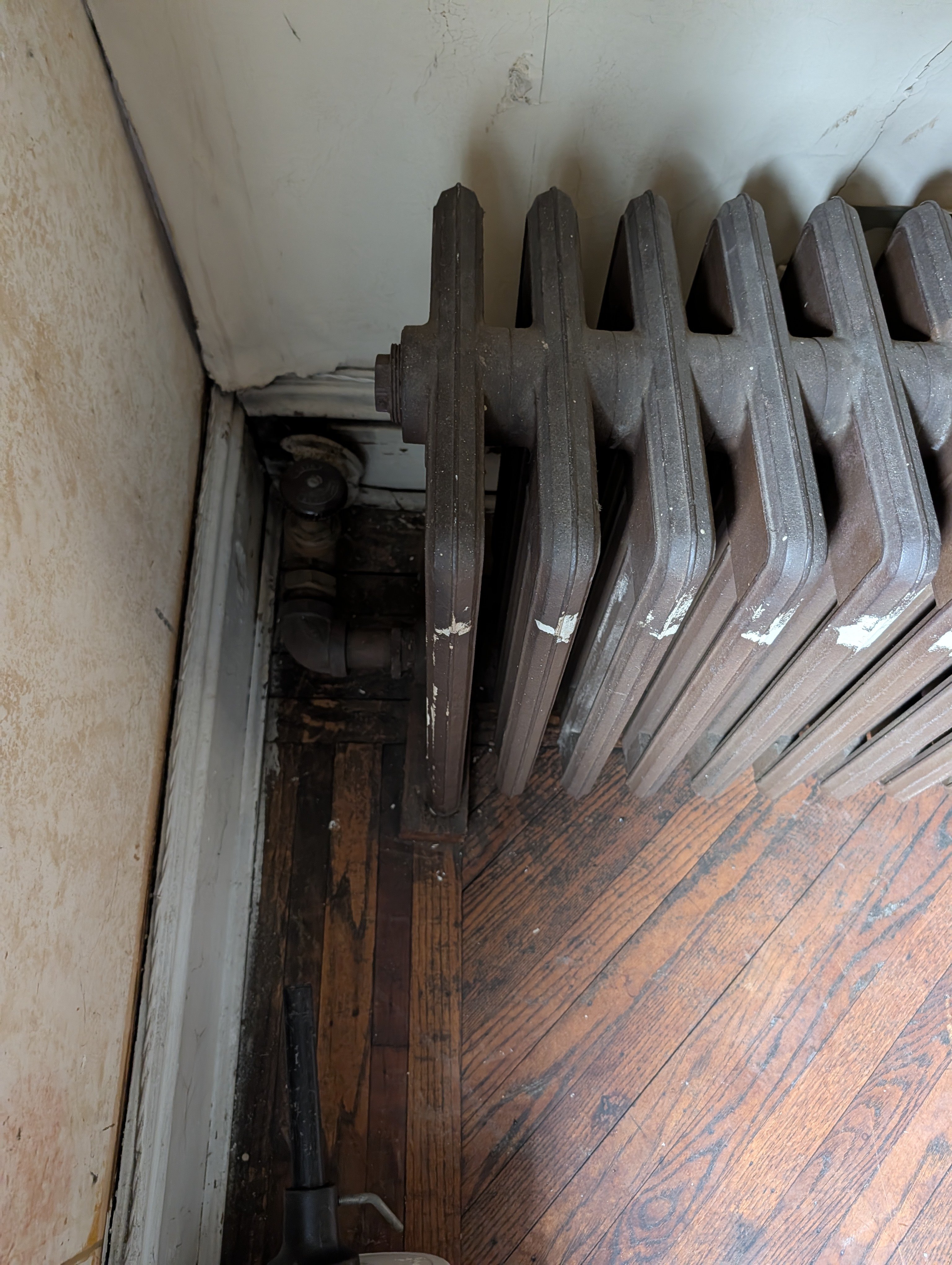

The last issue is that a top floor radiator furthest from the boiler is not getting hot. The feeder pipe prior to the valve also is not getting hot. The riser nearest to it is getting hot on all floors below - 190 degrees measured on the infrared thermometer on my phone.
When I first noticed the issue, I investigated and found that the valve was in the off position. No telling for how long - possibly for over 20 years. The top floor (rarely occupied) is comfortable without it. Turning the valve completely on did not solve the issue.
My instinct is to leave well enough alone, but since I have come this far, I figured I would post to see if it could be easily resolved.

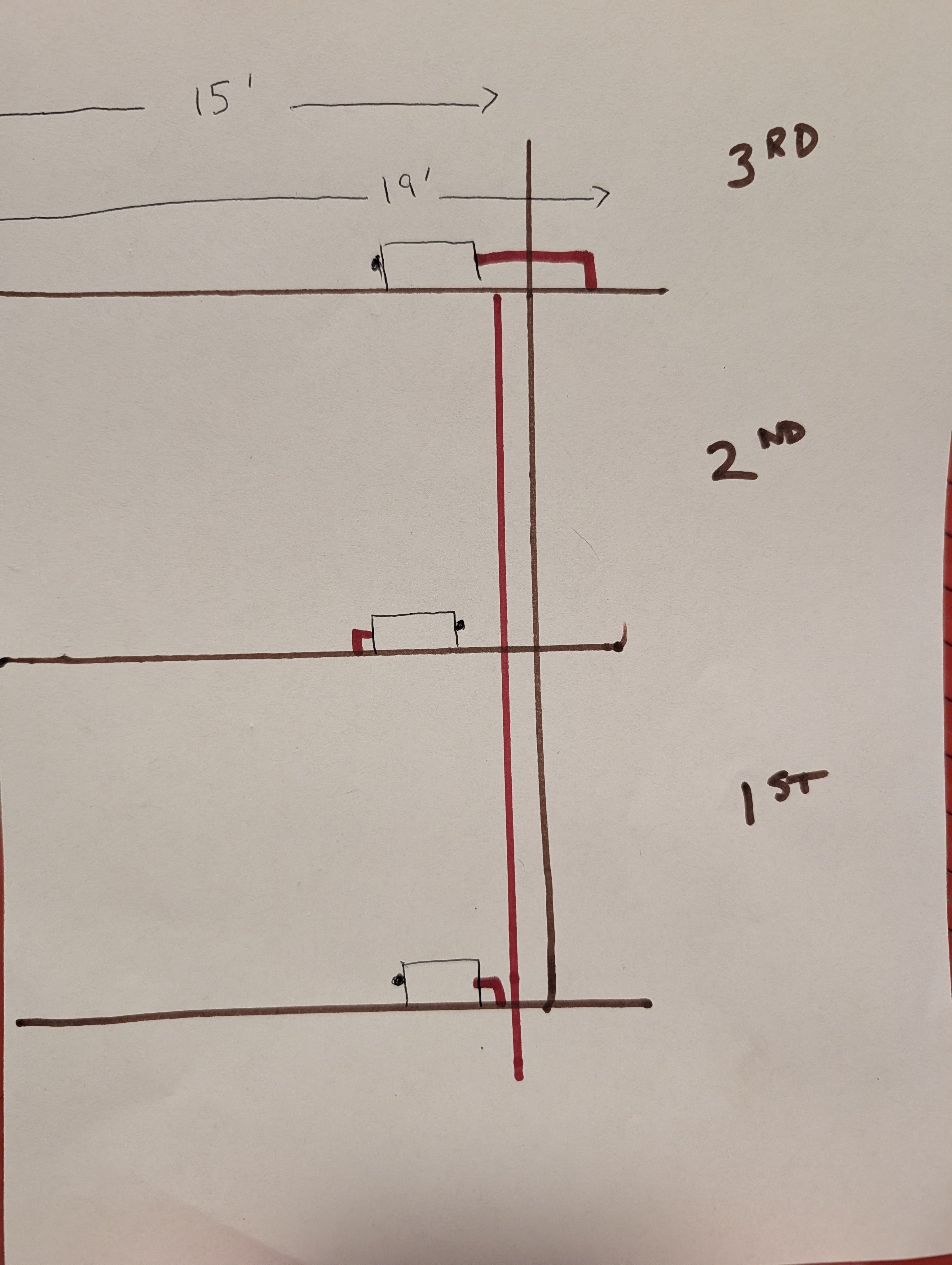

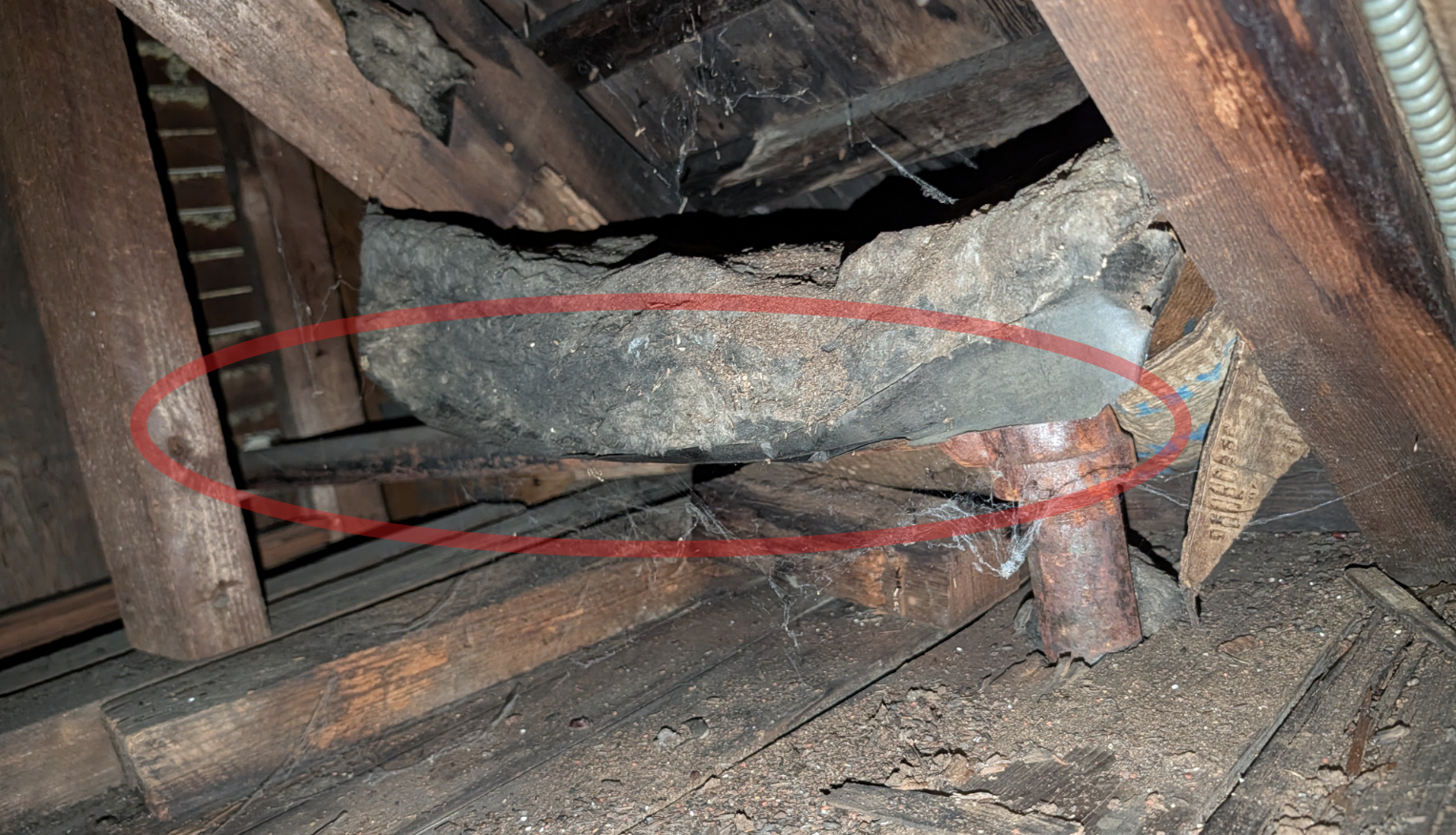

Not sure how the riser terminates as it is directly below the radiator, but the feeder pipe is about four feet beyond which would make it in a wall on the floor below.
I'm attaching a few photos and a crude drawing of the piping.

    does the lateral in what looks like a knee wall have pitch toward the riser? The valve could have come apart such that the washer is still sitting on top of the seat when you open it.

    I can not see where the riser would be feeding the radiator.
    if the valve isn't opening because it is broken the air would not be able to get out of the riser through the radiator vent so the riser would not be able to get steam in it so it wouldn't heat.
    Is this on the other side of the wall from the radiator? Does any of this get hot?

    When everything else is hot in the home, take the vent off. See if you hear it blowing air. If the other rads are hot, and the therm is calling, steam will head there. If the valve is stuck in the closed position it wont. (Make sure the vent is easily removed and easily reinstalled when there is no pressure and boiler not firing prior to trying this. If steam starts rushing out and you can't get the vent back in, and we dont know if the valve works, you will be running down lots of stairs to turn off the boiler and drain down some water to kill pressure.) THIS IS NOT A SAFE SUGGESTION (I do this regularly though).

    Yes, on the other side of the radiator through the wall of an odd unfinished storage room. That vertical pipe must be in the wall below. I assume that the riser must be to the right of that sub-floor chase so it can not be seem.
    It does not get hot. It gets ever so slightly warm because it is connected to the system.

    I took a second look and no, the horizontal pipe is pretty level. The thing that confuses me is that the riser is directly below the radiator but instead it is piped through a wall and ceiling below a few feet away. Should the valve be pitched back towards where the pipe extends through the ceiling below and then the radiator be pitched higher from vent to valve?
    Edit: Reexamining my pictures I see that it is pitched in this fashion. It also looks like the floor was either damaged or repaired exactly where the riser would be.
