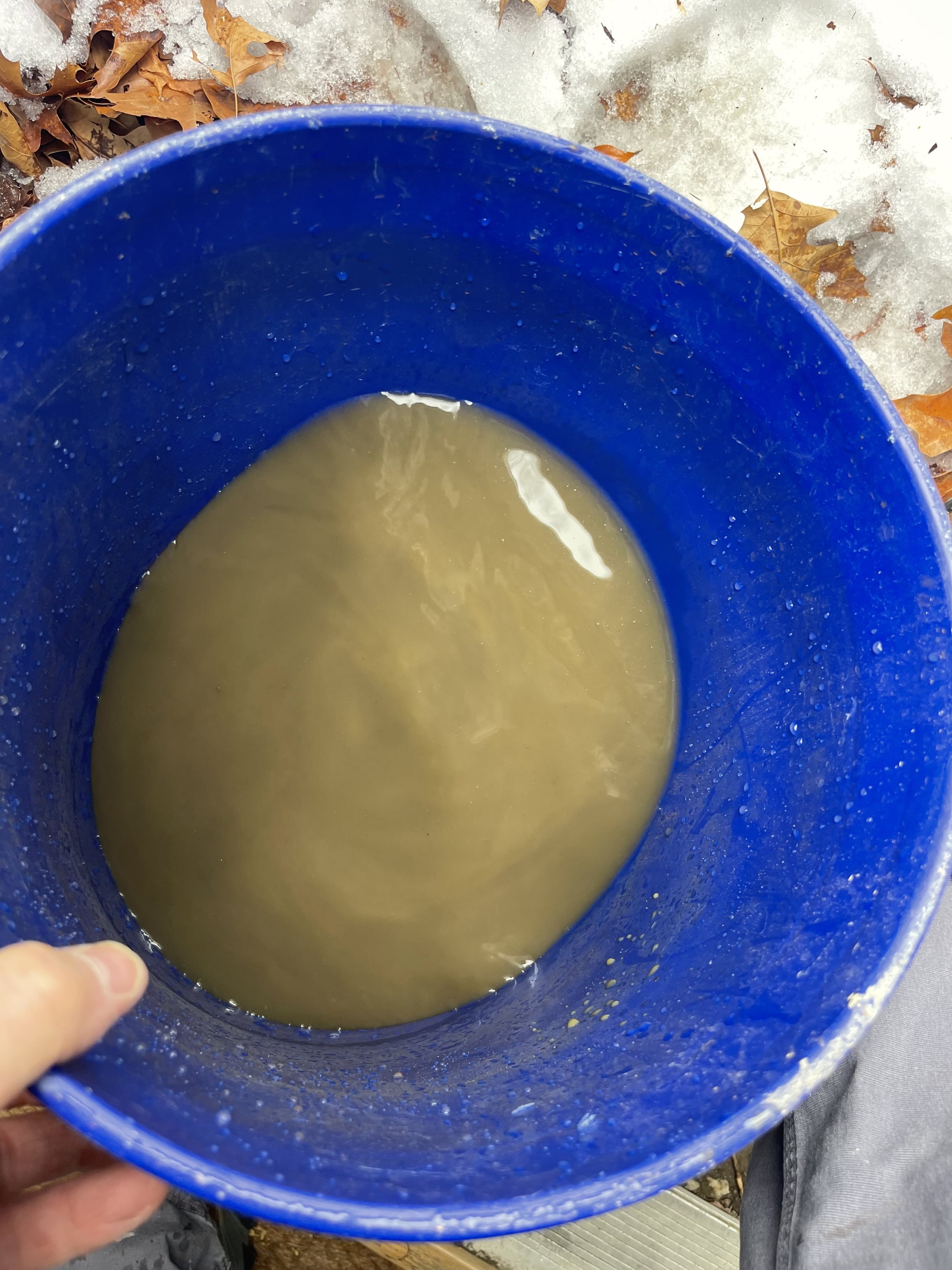

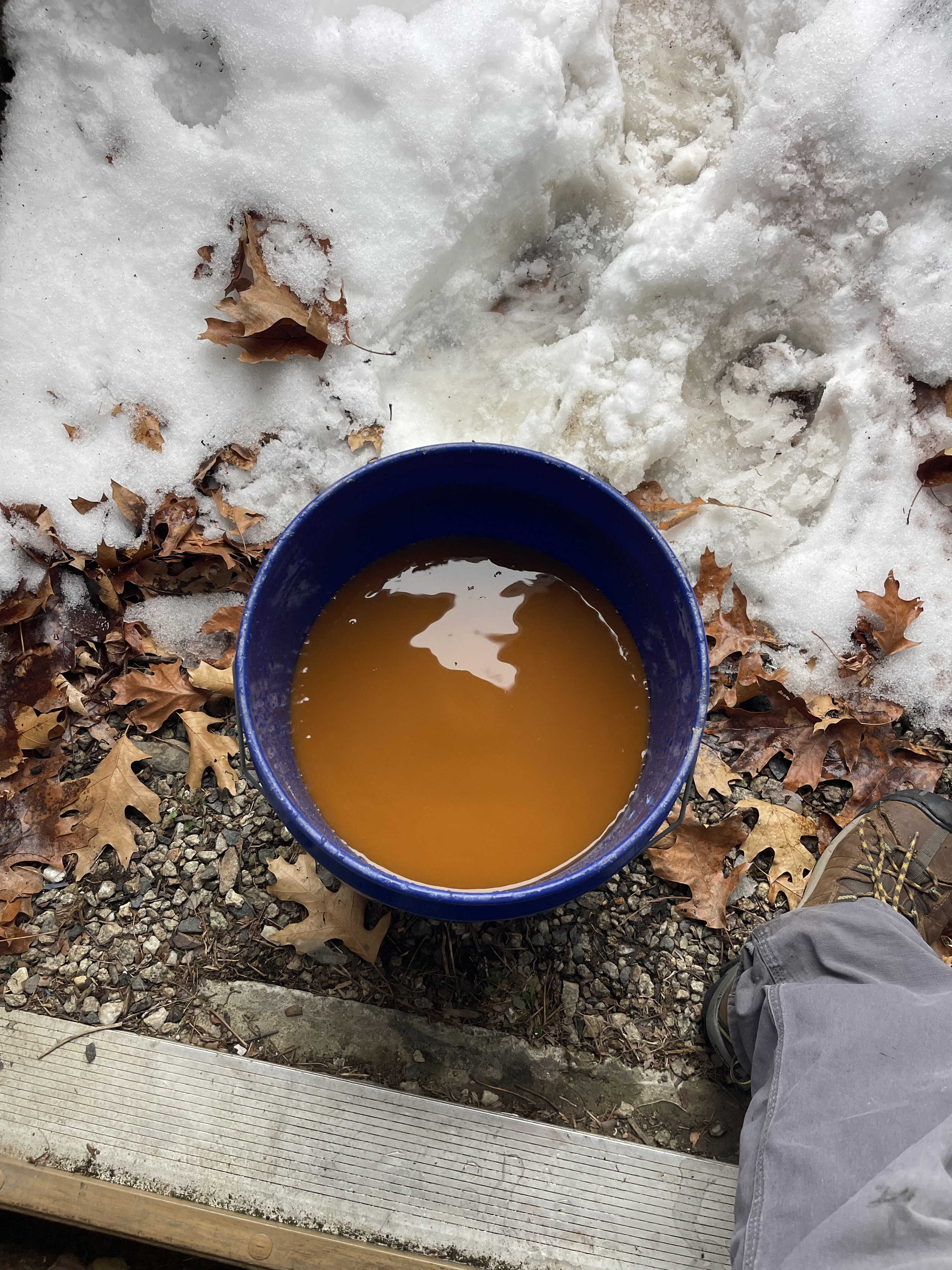

When I went to purge out the loop I was stunned at how little flow was going through the piping. To attempt to force the flow I cut in a second boiler drain and street pressure (65psi) to blow out any junk.
I was surprised to see sediment in the bottom of the piping.
When purging I got A Lot of rusty hematite laden water from the loop.
More troubling the flow rate was terrible. maybe 1-2 gallons a minute.

    pix.. town/municipal water. Munchkin boiler. A couple Baseboard loops and an air handler.

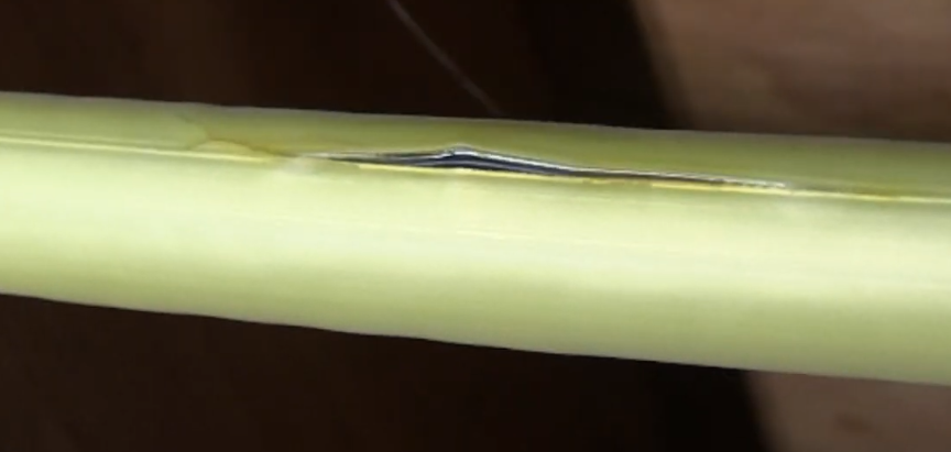

    My understanding was the inner, black full size pex tube is their barrier HePex? The aluminum and PE layer over it was to make it "form stable" that is where the name comes from FostaPex.
    The Viega June 2013 Tech Bulletin addresses the splitting outer jacket and they say the oxygen permeation is not compromised by the splitting outer jacket. Maybe find the TB at their website.
    Is that what you are seeing the outer grey PE and aluminum splitting?
    Has the system been taking on water. Any other place O2 could be entering?

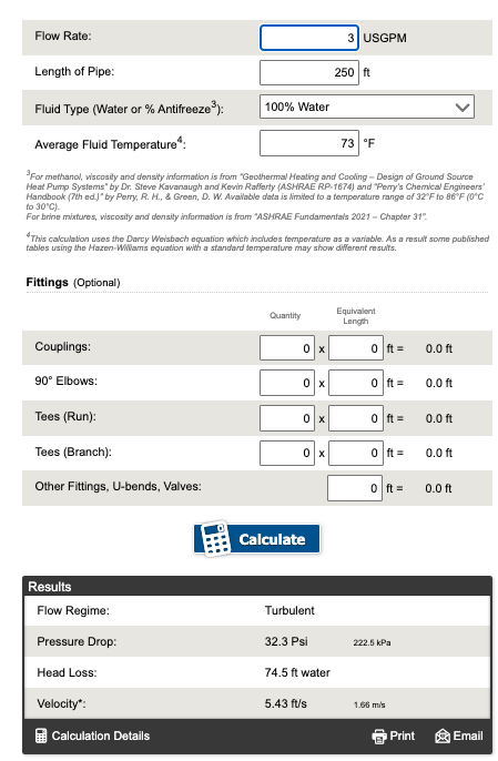

    If you get any flow at all, then a power purge should clear the heavy sediment out. You need at least 5 fps velocity to move heavy sludge, the faster the better.
    I'm not sure the tube size 3/5??
    go here and input tube diameter, and length, then keep upping the gpm till you see 5 fps. That is the flow you need from something.
    https://plasticpipecalculator.com/PressureDropHeadLoss.aspx
    In a 1/2 loop 250', to get 5 fps the head gets way up there example. 3 gpm= 74' head, probably beyond your flush cart

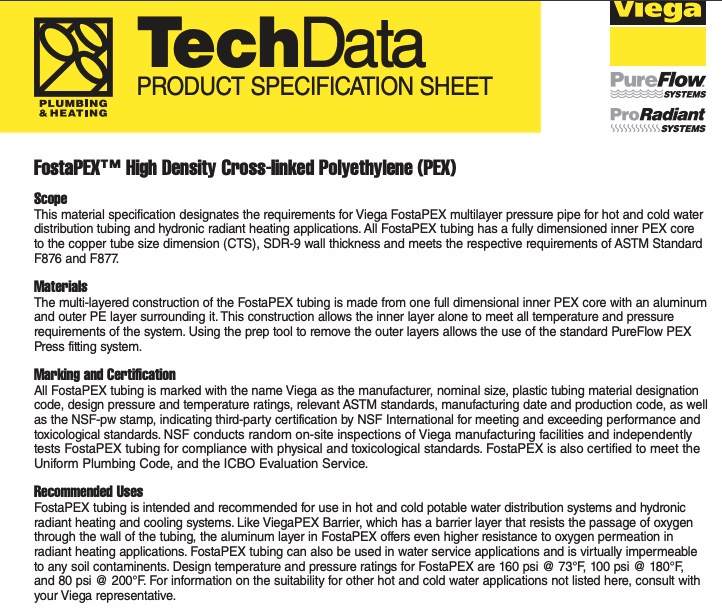

    I would flush it as best as possible, add good water and keep a hydronic conditioner in the fluid. It's about all you can do at this point. Keep SWT temperature as low as possible.
    It was marketed as superior to EVOH type barrier tube, with the aluminum layer.

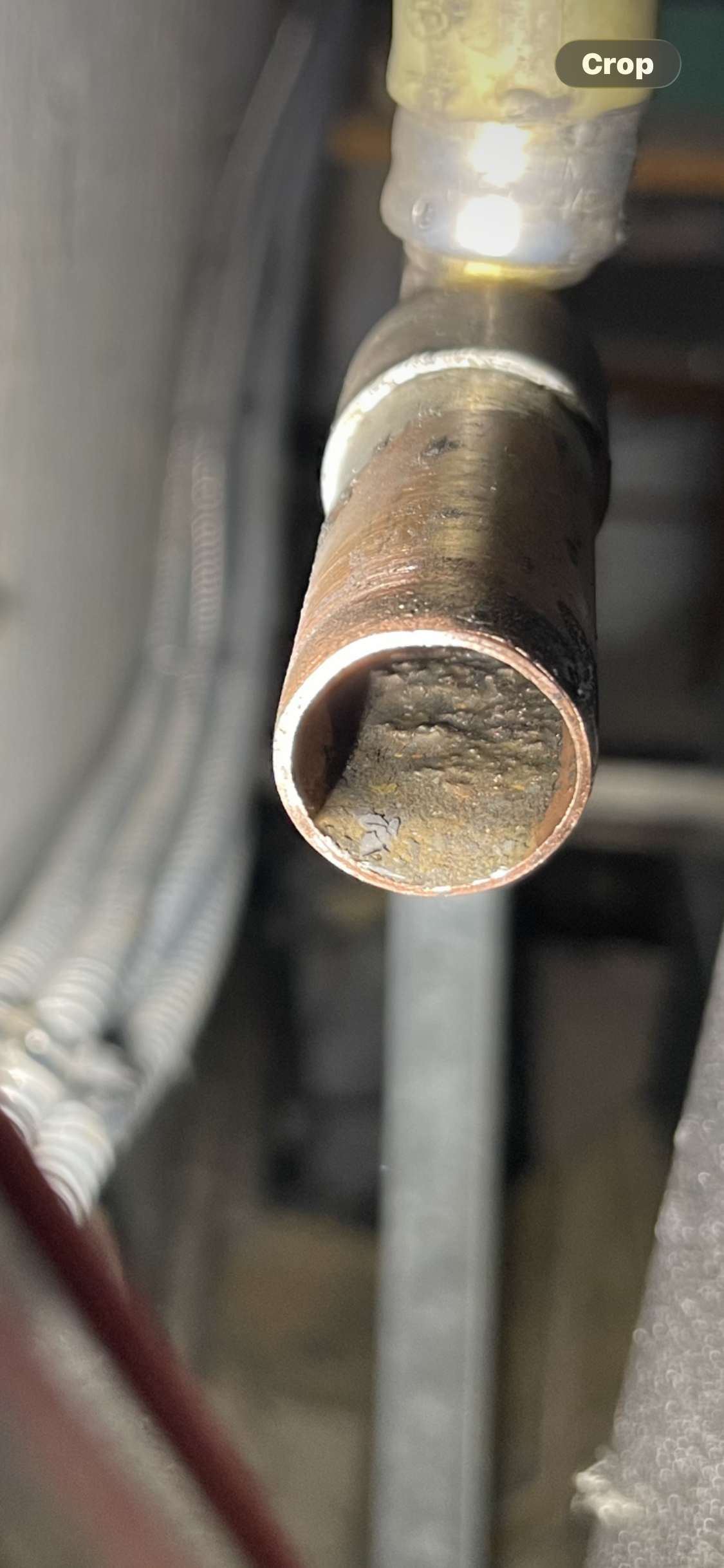

    This is from Face book
    Hydronic Heating Techs
    John Falconi
    February 14 ·No heat call, 1st floor air handler coil only getting about 1/3 hot, rest of coil surface ice cold. This is what we found in the old coil when we replaced it and cut it open. Welcome to Magnetite! Viessman oil boiler, hydro-air system all piped with Viega Fostapex I’d say the oxygen barrier is non existent on this Pex! Replaced the coil, re-piped the zone in copper and installed a Caleffi magnetic filter for that zone. Advised the customer he better think about replacing all… See more
