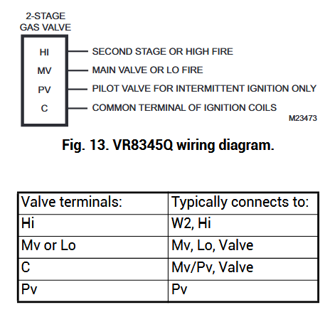

I'm also pretty clear that the MV terminal actually calls the low-stage because there is a side pony terminal on the VR8345Q that is label "HI". I talked to Residio who confirmed this, although not with the robust familiarity I would have preferred. Again, I can work it out by experiment, just seems like they could make it more clear in documentation which seems to concede it once in the fine print whereas I would lead with this–albeit this is full line documentation, they might have been well advised to have separate documentation or pages for the two-stage valve within the line.

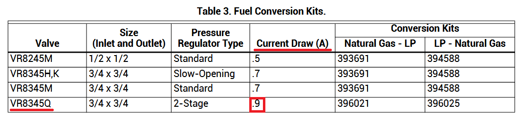

    As far as High / Low stage control I'd use the stated current draw as a clue. There may be some logic or sequence to the Gas Valve for safety that you need to deal with. How are you going to control the High / Low stage transitions ? Steam pressure, time, both ? I'd think you would want high fire to get things going then reduce to low fire. Also maybe depends on how long the boiler has been off and system load (outdoor reset). Sounds like some PLC type fun to me.

    @109A_5 of course i'm interested in the numerology in the name, but i had noticed the draw and imagined that probably meant that coils ran in series.
    i admit i don't think fig. 12 and 13 is where i saw the reference to main as low fire. i think I was higher in the instructions but it was similiar, it called out Main but had Lo in parenthesis. And the bus does not look as indicated or implied in fig. 12 with the 4 teriminals in a row. rather the three terinals are in one bus obviously cribbed from a single stage valve and the single stage plug fits it (although by the labels it plugs in backwards as I mentioned so unless I figure the secret of releasing the brass female spades that snap into the plastic male assembly of the harness I'd have to cut and cross the blue and red wire so I think i'll make a new harness. then there is a completely separate two terminal bus with one of the terminals labeled Hi and I assume the other would be another common.

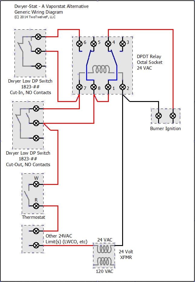

    my original plan was to trigger the stages using a Dwyer DH3 style vapor pressure gauge with two switching stages. seemed like a perfect control only the one I put on there breached its seal in no time. The documentation seemed to say that it could handle being expose to 30 lbs although the measurement range was up to 50" WC and I had it on a pigtail. Although some one of the steamheads on here (although I don't think literally @Steamhead) has a dwyer electronic gauge running naked on a long riser, so I don't know what happened but i'm jaded and $200 bucks poorer (and can't really see this as a permanent solution as they supplanted the DH3 with DHCs, similar function but plastic instead of aluminum case with maxium expousre limit of 6 pounds. Still theoretically in the range but don't like the plastic with the heat. The Dwyer guys at AHR told me to send it in so they could take a look but I might be back to the original Dwyerstat idea on one of the lost threads on here when they changed platform. I got a clip of it off the wayback machine
    Anyway, while i worked on the control strategy i have been running the thing at the approx equivalent of low all season and it is a little slower to make steam but not bad. we just moved the morning pickups 1/2 hour earlier and once steaing it matches the condensation nicely so it just purrs along in low while the thermostat is calling–delivering nice dry steam.
    So given my disappointment with the DH3, where I have to buy old stock off ebay anyway, I've backburnered my hopes that that would be the perfect two stage steam controller. Of course while Dwyer said they thought it ought to work, these controls are used most often for monitoring differential pressures to insure that clean rooms are maintaining slight positive air pressure. And since domestic steam boiler manufacturers are generally not focused on two-stage operation Dwyer's incentive to consider repurposing these as OEM or regular aftermarket controls in the steam market is non-existant.

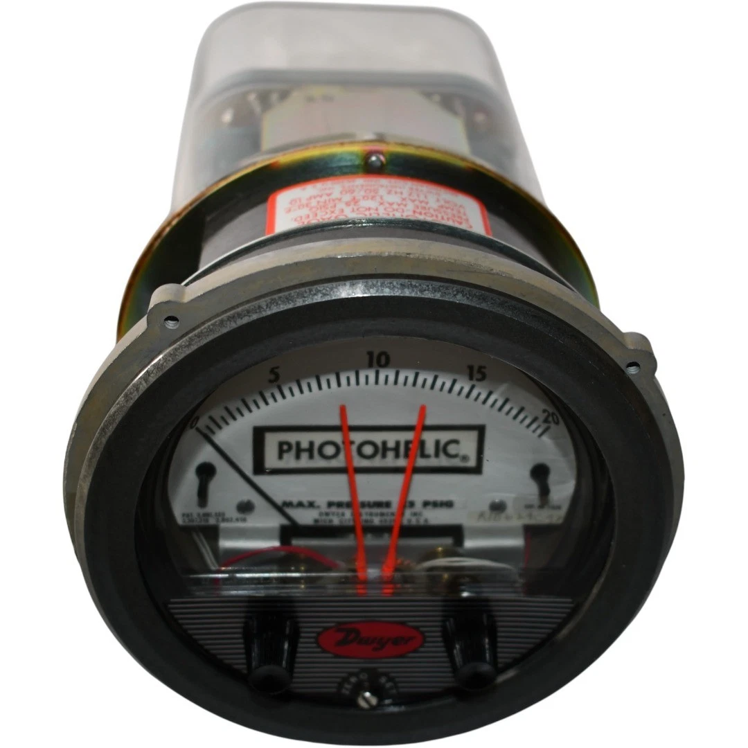

    The Dwyer-Stat concept is much like the Dwyer Photohelic series.
