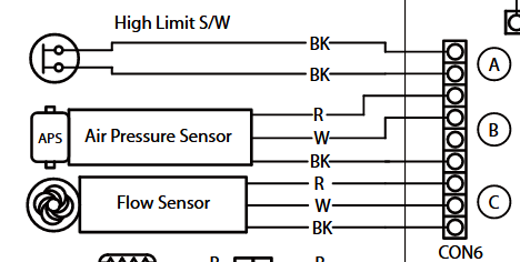

The flow sensor was getting 12 VDC from the main board, and between it's output wire, and common it was staying at 5VDC regardless if a fixture was open, or not. In my notes I recalled the reading should be around 2.5 VDC with .5 GPM flow. So I changed the flow sensor, and the unit operated for about a half hour, then the flow went back to 0, and the output from the flow sensor went to 0 VDC. Obviously the unit will not fire, and the customer currently has no hot water. For the half hour the flow sensor was reading flow, the heater operated and the water was hot. One thing I did notice was that with one fixture open (a bathroom sink) the flow reading on the front display seemed to jump from .4, 2.5, 4 GPM. Again with only one fixture open. The water pressure is on the high side, around 80 PSI, but according to Navien the unit and it's parts can handle 150 PSI. I plan to Install a PRV at some point, but before then I need to get this heater fixed and the customer's hot water back working.

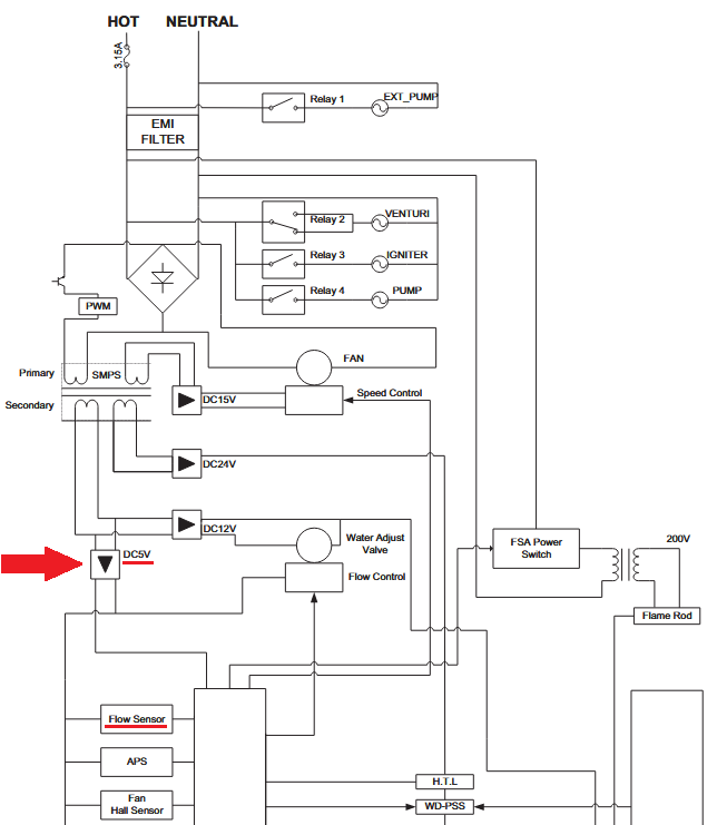

" The flow sensor was getting 12 VDC from the main board, and between it's output wire, and common it was staying at 5VDC regardless if a fixture was open, or not. In my notes I recalled the reading should be around 2.5 VDC with .5 GPM flow. "
Not that the documentation is great. What I get from this drawing is the flow sensor should be powered by 5 VDC and I would expect the output should be between 0 and 5 VDC depending on the flow. If the DC voltage that powers the sensor is actually wrong the power supply could be bad killing the sensors. I assume you verified the 120 VAC power is good. Poor or incorrect input voltage may be driving the power supply nuts, causing erratic operation (since this unit has a not so good history).
Not sure I understand this,
" then the flow went back to 0, and the output from the flow sensor went to 0 VDC. "
I would expect that is normal. No flow the sensor's output voltage goes to minimum if the output voltage is proportional to the flow or maybe if it is inversely proportional it should go up to 5 VDC.
