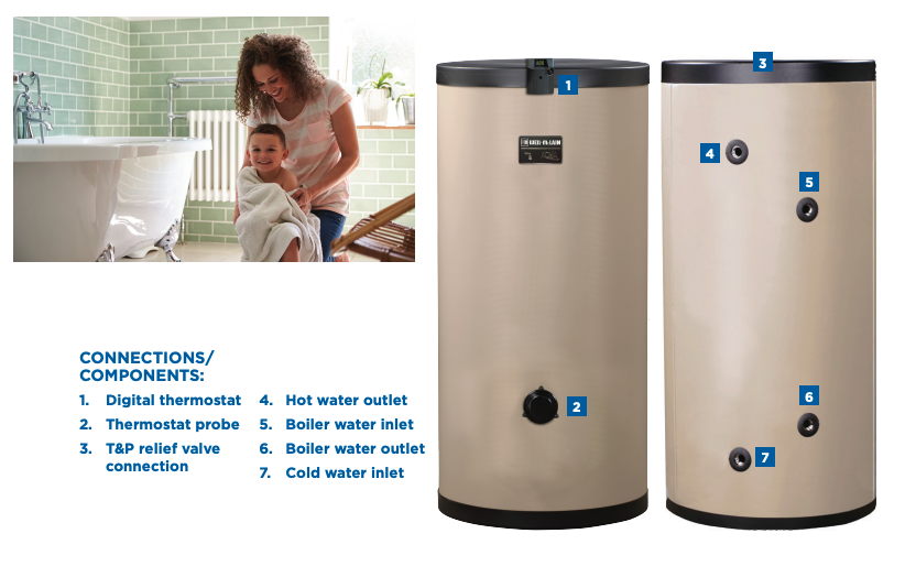

We have a Weil-McClain I direct dhw tank. This along with the Weil-McClain CGa3 were installed in November. One thing I seem to be noticing is that it calls for the boiler to respond when not all that much hot water is used. I hope I am being clear.
Advice?
Thanks!
    hot_rod Posts: 28,585
    If it is this tank, I'm not thrilled about the control location at the bottom. As soon as you open a faucet cold enters the tank and hits that control turning on the boiler. looks like cold water in #6, blasts right at the thermostat #2, across the tank?

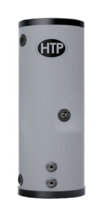

    More commonly the sensor is mid point on the tank so you draw 10 gallons or more before the sensor sees cold water and turns on. The HTP example.
    The sensor down low starts the boiler sooner for recovery, but may cause the quick cycles you see.
    Where is your sensor and control?

    Bob,thanks for your reply.
    It is like you describe. The cold water inlet appears to be opposite of the sensor. So I guess I need to live with it.
    mattmia2 Posts: 18,272
    it all depends on your application. i have the htp and wish it started heating earlier in a draw of hot water because in winter I have very cold incoming water and a smallish tank that is dependent on the boiler for a good amount of the hot water available and by the time the well cools and the boiler pre purges and ramps up, half the tank is gone and the boiler doesn't have enough output to make up for that.
    if it really bugs you get an electronic setpoint control, poke a hole in the outer jacket and slide the sensor mid tank
    Any temperature control can trigger a boiler
    I remember a solar tank that had tracks down the tank so you could slide a sensor at any level on the tank.
    I would not want the sensor and CW inlet next to one another. That seem like an odd design
