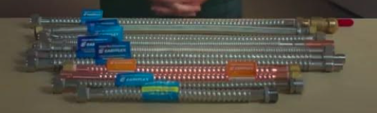

I’ve seen this here and there, and utilized the method a couple times. It now occurs to me that these stainless braided connectors may not be oxygen barrier… obviously not intended for this purpose. Anyone have a preferred connector for this?

    I have seen thermal expansion tanks on water heaters connected with flex tubes. Most are 3/4" however.
    If a faucet braided connector is rated for the temperature and pressure it should be fine. Most likely it
    is an EPDM hose with stainless braid.
    Capacity could be a concern on larger boilers, perhaps. Amtrol probably has a sizing formula for the tank connector tube :)

    Actually a lot of the Euro boilers that have pancake type expansion tanks inside the cabinet have small flex lines connecting them. I had an early Laars Mascot (Baxi 330) that had a SS flex expansion line. Straight connections with fiber washer connections.
    Zilmet has tank/ flex kits for systems that are common in other places around the world.

    Yes but are they have oxygen barrier for hydronic systems?
    hot_rod Posts: 28,708
    You would need to ask the manufacturer what the inner tube is made of. This example shows a PVC inner liner. That is not considered O2 barrier material. PVC is not typically rated to 180° either.
    I don't know the SS braid is tight enough to be O2 impervious? Stainless is, but maybe not the braid.
    I don't know that 24" of non barrier tube in a system would create a O2 ingress problem?
    Pump gaskets and other components are not O2 barrier material in hydronic systems. A 100% O2 ingress free system is near impossible.
    The amount of O2 ingress is directly related to fluid temperature, so systems at 180 are more prone to O2 ingress than systems running 120°
    What temperature would the flex be exposed to under continuous operation?
    You can always add a hydronic conditioner, like Fernox, etc, which have a component to address small O2 ingress. Oxygen scavengers.
    I have seen flex connectors used on panel radiators, and unit heaters also, must be someone builds hydronic rated flexs like Zilmet and other Euro expansion vessel manufacturers, sell?
    A short piece of Watts Radiant Onix hose would be an option.
