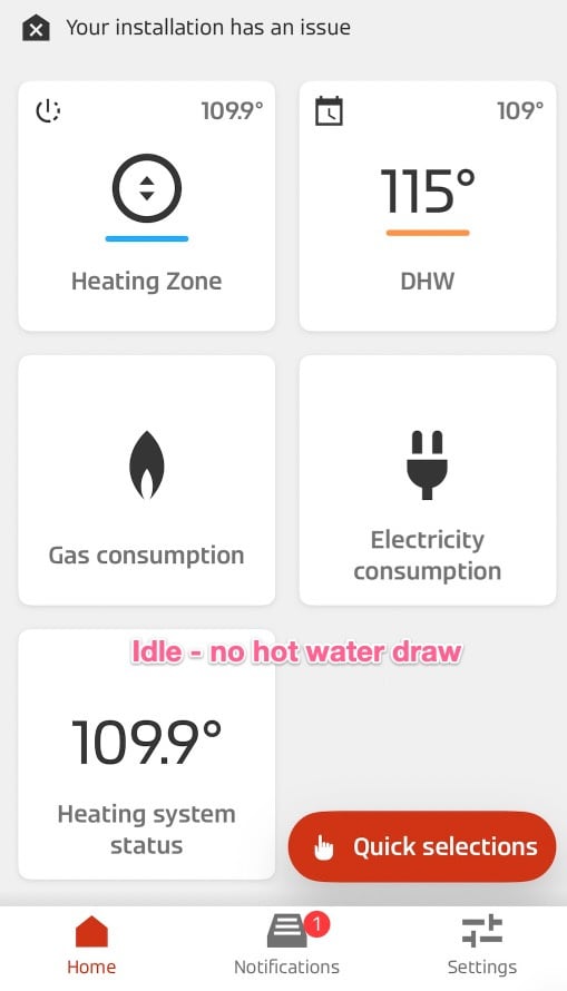

I have a new Viessmann Vitodens 100w b1ke-199 combi-boiler (DHW + Heat supply for 2 hyrdonic air handlers). This is all < 1 year old.
Ever since we got it, the DHW hot water "scalding hot" (hurts your hand). I got around to setting up ViCare and set my DHW to 115F. When neither the DHW or Heat are being pulled, the ViCare app shows ~115 to 130F for DHW. However, when i start to draw hot water with EITHER DHW (ex. running bathroom faucet) or the heat supply - i can see in the app the temp fluxuates between ~ 115F and 140F, usually staying closer to top 140F range (which is that "too hot" temp).
In the ViCare app, i have a DHW schedule (5:30am - 10pm) and Operating mode switch (DHW) = Standard.
Any idea what could be causing this and how. i can adjust it? This seems like it should be a trivial setting.

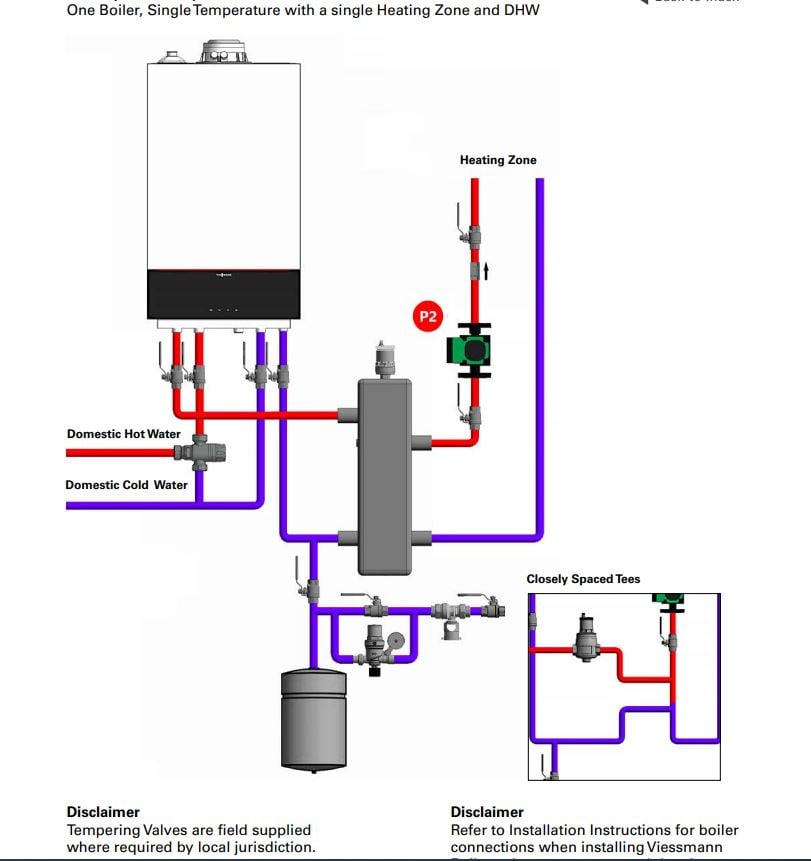

    First thing I would check is if there is a mixing valve under the unit? When these run hot in space heating they have no choice but to overtemp the DHW, a mixing valve is required in my region for all combi boilers for this reason.
    next would be to check what the temp is actually coming out the faucet at. I dont use the vicare app much but the DHW matching exactly with the space heating temp is a little odd. is the DHW scalding you when it comes out of the faucet?

    it will be a 3 way valve, likely with a plastic cap to make adjustments, and sometimes they have a temp gauge on the outlet (but not always) typically if the temp in the boiler from space heating were overheating the domestic it would cool off after a short while. if your system makes high temp water for space heating you would need a mixing valve (regardless of codes etc) if the system is all low temp (in floor heat) you may also have something wrong with a sensor in the boiler, though it does seem to be reading the temp correctly on your app.

    some pics of the install, far enough back so we can see everything, might help
    Mad Dog_2
  • GGross
    GGross Posts: 2,106
    There doesn't appear to be a mixing valve on the domestic side. If you were to run the fixture that overtemps the most for an extended amount of time, or run multiple fixtures for a while, will the DHW temperature go back to a somewhat normal range?

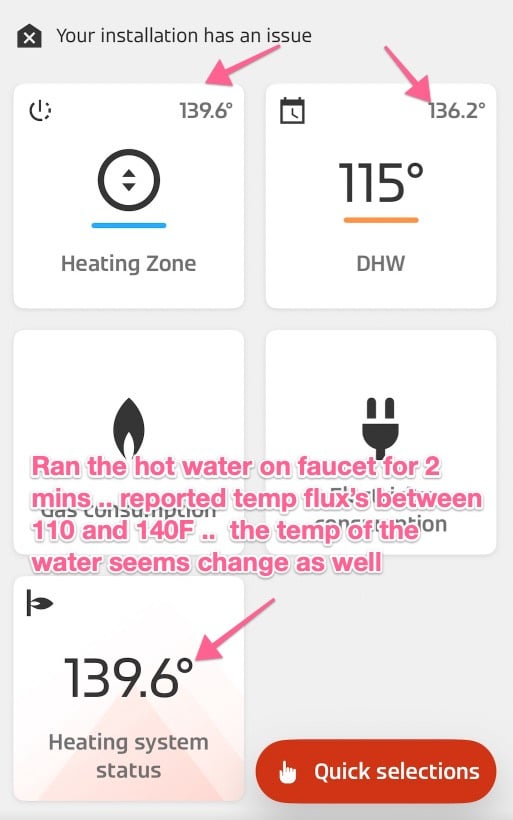

    Took some app screen caps running 2 faucets on hot (see imgur below). The temp spiked to very hot (130s-140) for the first ~1 min, then it dropped way down .. lowest i saw on the app was 109F, ratched back up to low 130Fs .. and settled at ~112F; the app showed 112F for what i think is 2-3 refresh cycles.
    I put an instant (cooking) thermometer in the flow from the kitchen faucet, and it was inline w what the app was showing in terms of general temp/temp movement.
    As an aside - when i took the pictures - i poked around the on-device LCD, and i saw "scald protection" was set ot on … however 140F (which DHW will deliver) is seriously hot to the touch; not sure what it considers scalding.

    What I would do with this current install is add a point of distribution thermostatic mixing valve. It may take just a little tweaking between the mixing valve setting, and the boilers outlet temp settings to get it right for you.
    unfortunately if the boiler water temp is much too hot there isn't any way built into the boiler to prevent the temps from getting too high. this is why you will see a mixing valve for the DHW side on all their drawn combi applications. Viessmann doesn't require it for every install and instead leaves it to local code officials. this is because when the boiler is setup with outdoor reset and functioning below its max setting, this issue really doesn't come up. Once you know that between the combi, and the mixing valve, the hot water doesn't get too hot, then you can investigate the shower valves, they may be scaled up a little.

    5. Curious; what's that grey tall rectangle in the middle of your picture? I dont have one of those from what i can see?

    When your boiler temperature, the water currently in the heating system of the boiler, is so hot that it well exceeds what is required to heat your DHW to the desired temperature the boiler has NO WAY to stop that from happening. its not that the boiler doesn't respect the setpoint temp, the installer did not respect the installation requirements. the boiler cannot break the laws of physics, to cool off the boiler temp you would possibly be waiting 15 minutes with no heat or hot water for the boiler to cool off. that is why you need a mixing valve in your circumstance. With the outdoor temperature sensor programmed but not hooked up this will occur year round, the boiler will maintain max temp because it thinks it is 32f outside, it will do this in July, it will do this when there is no call for heat, it will continue to waste fuel, unless the outdoor sensor is either correctly programmed out, or hooked up.
    temperature hunting can be caused by a variety of jobsite conditions, very low flow and the unit might go off on limit, giving you a cold water sandwich effect, too high space temp setpoint and the start of your hot water will well exceed the setpoint. Plumbing issues, scaled up valves, inconsistent well pressure, and the boiler will turn on and off with the rapidly changing flowrates it detects. for these reasons I personally prefer a tank of hot water and not a combi or tankless.
    Yes with a mixing valve your DHW setpoint on the boiler will need to be a little higher than outlet temp you desire from the mixing valve, there may need to be some tweaking to get this right.
    I can't guarantee you get a straight consistent temperature out of your shower after this change, you may have issues in addition to the scalding issue. However the scalding issue must first be resolved to pursue any additional issues, which may be related to the plumbing system or the shower valves as much as it may be related to the boiler or install,
    The grey box is a "low loss header" or a hydraulic separator. among other things it separates the flowrates in your heating system so the boiler always gets the correct flow, and the system gets the correct flow. It is nice, but not strictly required, and your system has an acceptable alternative in the form of closely spaced tees.
