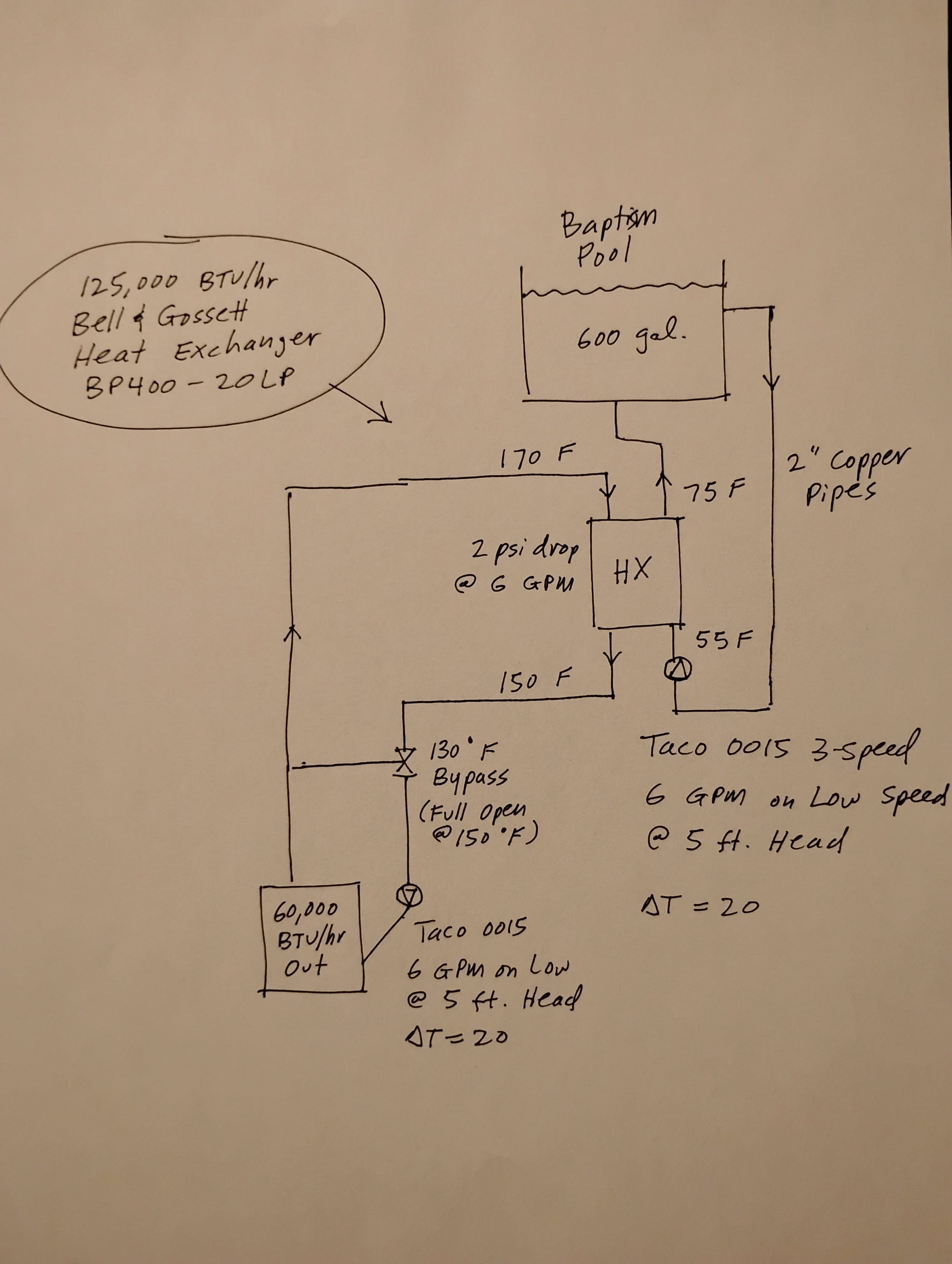

    A pool heater may well be your best option, as being discussed on the other thread. But since you asked about heat exchangers, here's a possible option using a Bell & Gossett 125,000 BTU/hr heat exchanger (BP400-20LP). The HX is oversized in order to reduce the pressure drop to something reasonable so you don't need bigger circulators.
    Again I'm not an expert, and don't build anything based on this. The experts can tell you what I got wrong. 😀
    But with a 60,000 BTU/hr boiler output, for a delta T of 20 F, you'd need 6 gpm in both loops. With your large diameter (2") piping, you'll have very little head loss, most of which will be through the heat exchanger. The above heat exchanger has a pressure drop of about 2 psi (5 ft head) at 6 gpm. That's a fairly low head, so you can use a small circulator like a Taco 0015 3-speed set on Low. The variable speed means you can increase to Med or Hi if you want higher flow rate and lower delta T through either loop.
    The bypass is an ESBE thermostatic bypass valve with a cartridge that starts to open at about 130 F and is fully open at about 150 deg F. Once the boiler heats up and the bypass is fully open, you'd have a return temp of about 150 and a supply temp of about 170 at 6 gpm.
    Again, this is just a starting point for discussion with experts, which I am not. And, the pool heater is probably more sensible as you don't have to do all the bypass and heat exchanger piping.

    @jesmed1 thank you for the drawing and great info. This is what I'm looking for! But yeah the pipes are 2 " copper. And I look forward to how this progresses. Appreciate everyone's time.

    Again, do not build anything off that drawing until an expert like @EdTheHeaterMan or @hot_rod looks at it and tells you what's wrong with it. I think the general idea is correct, but they may have some comments on the HX or circulator sizing. Or they may tell you it's totally wrong! So wait until tomorrow when they come take a look…
    Meanwhile, as an improvement for flow control, you would probably want a globe valve on each loop to fine tune the flow rate/delta T. That along with a 3-speed circ should give a full range of temp and flow adjustment.
    Also note that the 170 supply temp and 150 return temps I put on the drawing would represent conditions when the boiler loop had heated up enough for the bypass to open fully. But depending on when you start the secondary circulator, it might never get that hot. If you started both loops simultaneously, the oversized HX might keep the primary loop from ever getting that hot. But the bypass would still protect the boiler return temp.

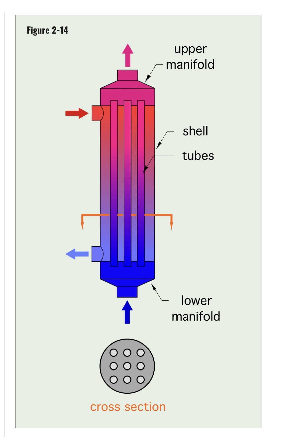

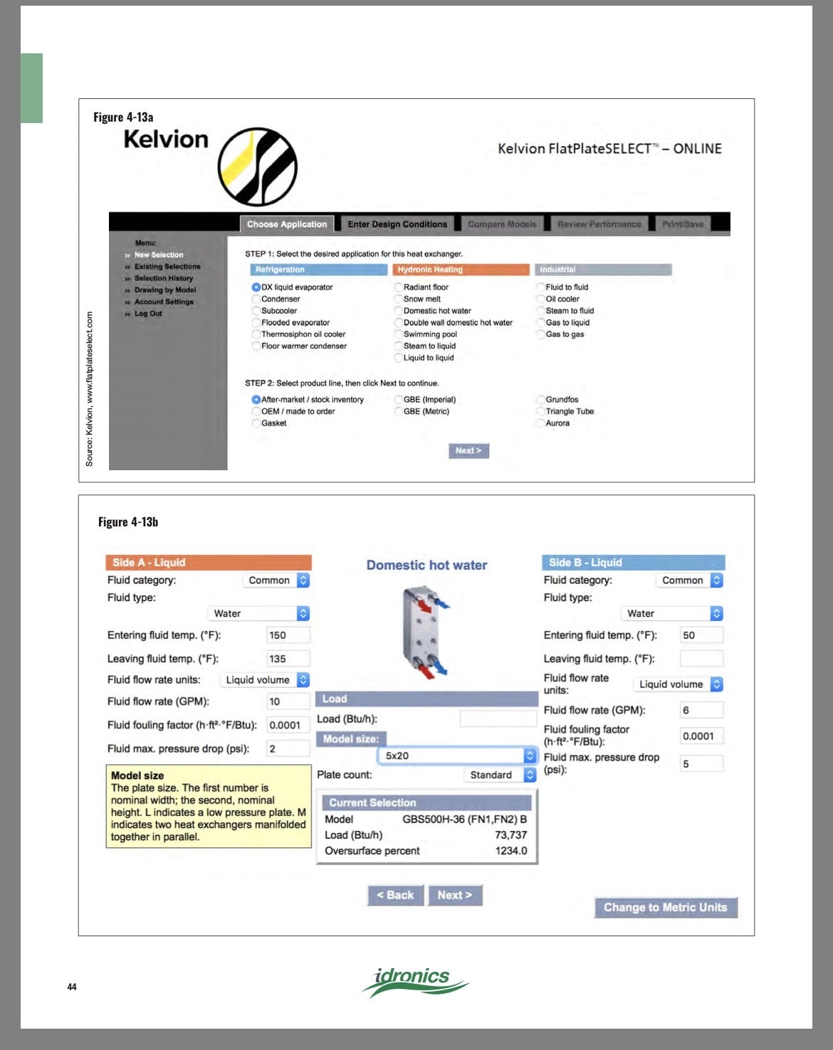

    the very best way is to use one of the free online sizing software programs
    You need flow data and some temperatures Im guessing a 5x10 20 plate would move all that boiler can offer
    Shell and tube are commonly used for pool and spa as they have 2” connections for high flow
    Your limitation will be the boiler output

    I played around with this Taco heat exchanger calculator.
    https://apps.tacocomfort.com/bhe.html
    Here are my inputs:
    Primary inlet temp: 170 Primary outlet temp: 150
    Primary flow rate: 6 gpm
    Secondary inlet temp: 75 Primary outlet temp: 95 (representing end of pool heating cycle when heat transfer through HX is lowest)
    Secondary flow rate: 6 gpm
    BTU transfer rate: 60,000 BTU/hr
    The Taco calculator then shows you a number of different flat plate heat exchangers, with the results you'll get from the above inputs. With their TB10T heat exchanger, which is about 5"x11" and 10 plates, the above parameters are all met, with a pressure drop of 3-4 psi (7-10 feet head).
    The B&G 125,000 BTU HX I linked to above has a smaller footprint (about half the area) but has 20 plates, so double the plates (and almost triple the thickness). Thus should have similar heat transfer capacity at lower pressure drop (I calculated around 2 psi at 6 gpm from the numbers on their spec sheet).
