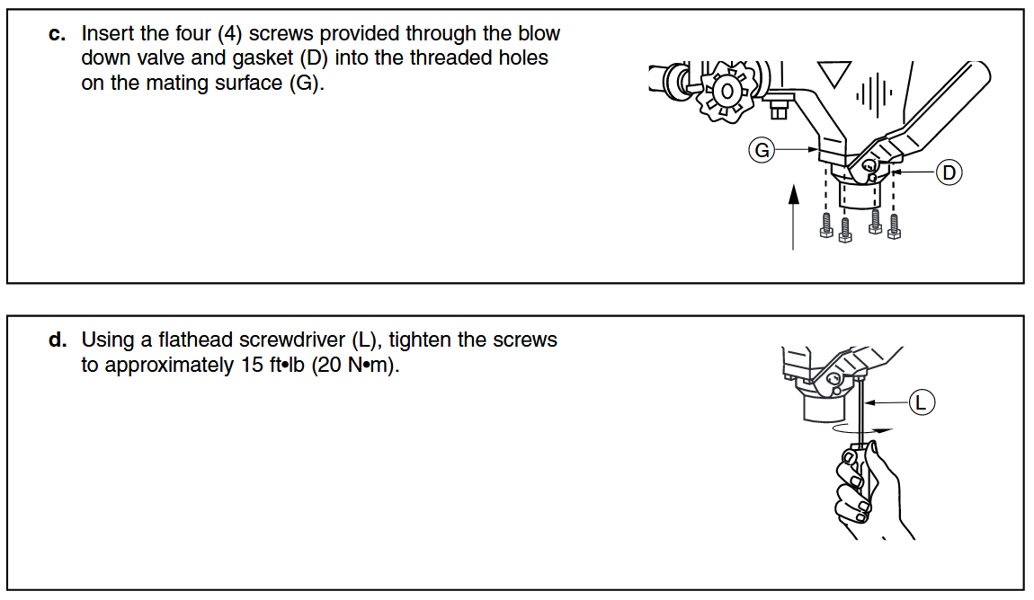

Can anyone advise the size Allen key needed for the Allen head cap screws on the MCDONNELL & MILLER 67 blow down valve body? I have to remove some p[arts to get to it, and i want to make sure i have the right socket before i get into it.

    I believe it is 1/4 Inch. Stand by I'll check.
    109A_5 Member Posts: 4,290
    Yes, 1/4 Inch Hex. I checked the screws on my boiler and my spare stock.
    I believe they have been shipping the units for decades with the 1/4 Inch hex drive cap screws. Yet the manual as of 2019 still refers to the old flat head screws.

    I've seen both flathead and Allen screws in the field.
