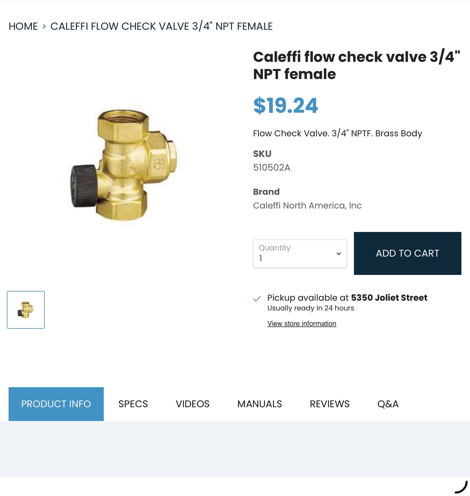

    taco, b&g, watts, and caleffi make flow check valves(caleffi look like they are only spring flow checks)
    https://www.supplyhouse.com/Flow-Control-Valves-275000

    Caleffi had a spring check with a manual lever, operated with a knob. It was sold as a B&G product also.You can still find them around. Low Energy in Colorado shows them, also e-bay
    The spring checks Caleffi sell now do not have the manual lever, same spring, .25 psi, 1-1/2 and larger is .50 psi.
    The B&G iron FloChecks were .33 psi pop. I think they have been discontinued

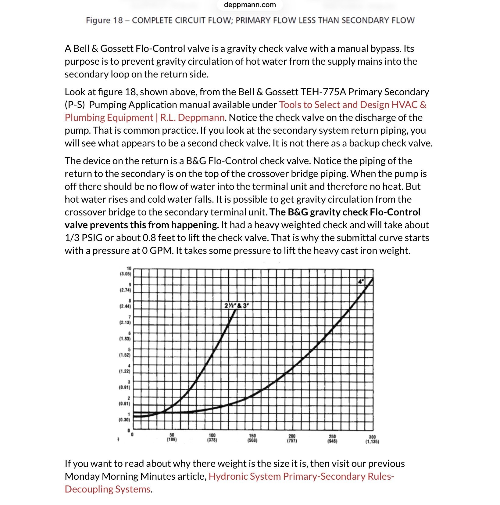

    @hot_rod so then my 2nd question is. If the circulator on the supply has a ifc installed, in some cases the weighted flow control would still have to go on the return on the secondary? For example , 2 zones upper and lower both Hi temp baseboard. The weighted check would go on the return on 1st or 2nd floor zone? sorry for my dyslexia, you are a life saver,
    hot_rod Posts: 28,704
    in some, fairly rare cases you need checks on both supply and return
    The check in the pump and another hydronic spring check on the return
    That will be the best protection and also lowest pressure drop
    Most prone are high temperature system where the buoyancy difference dtives ghost flow. Tall buildings with straight vertical runs, and of course mis- piped systems
