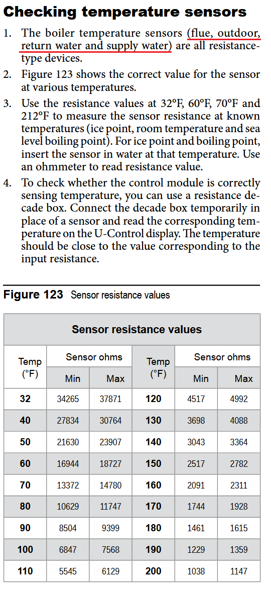

Is the outdoor temp sensor the same resistance profile as two indoor ones? The book is unclear . Thanks.

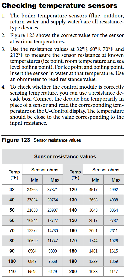

    Troubleshooting section. All the same resistance chart. Probably a 12K at 77F (25C) degree Thermistor.

    hot_rod Member Posts: 27,472
    I’m pretty sure they are. Take an indoor one. And connect it to the outdoor sensor connection and see what it reads.
    There would be a chart for the outdoor sensor if it was a different resistance profile.
    Tech support at Weil should know for sure.
