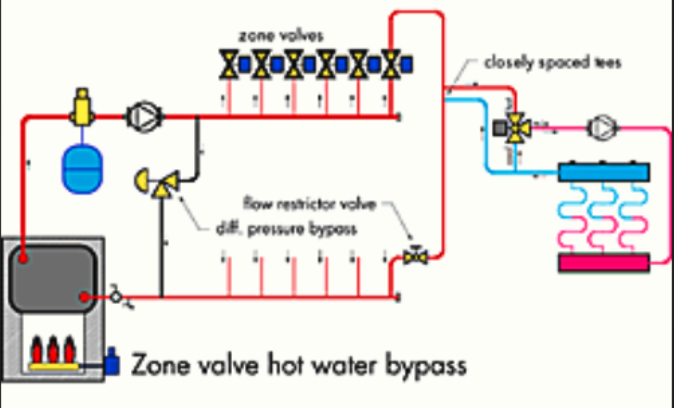

    I would either do it properly, or leave it like it is.
    A 3 way thermostatic would be the least expensive way to get accurate control. But it would involve some repiping.

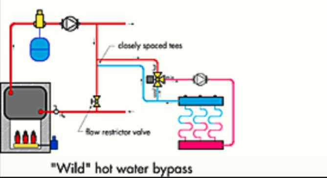

    Any mixing valve will need a dedicated circulator, it needs to pull hot and cold together to mix properly, so a pump on the discharge M mix port.
    Here are a couple of the simplest options.
    Since you have zone valves this first option is workable. No need for that pressure bypass unles you have more that 4 zone valves.
    So basically add another zone valve, make a loop from zone valve to return. A valve in that loop to balance just enough gpm for the radiant. In that loop, two close tees for the mix valve and its pump.
    This give you independant control over just the radiant woithout running any other zones.

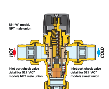

    Again, the existing current set up has a single system circulator (007-F5) with 3 zone valves on the supply side of boiler. If I were to leave all of this in place and then add a mixing valve / circ to the in-floor zone the proper way, then when this zone calls for heat, it would have to turn on the new zone circ, and also open up the existing zone valve, and also turn on the existing circulator and fire the boiler… But then when the 180 degree water hits the "hot" side of new mixing valve, the mixing valve is gonna close and then "dead head" the existing system circulator. Am I right on this ???
    So if you look at the drawing I posted, can someone please notate (or re-draw) how this can work ? I mean without changing the other existing zones…
    If I would have installed this to begin with, I would have used individual circulators for each zone, with a zone control panel. Then the wiring and piping for mixing valve would have been easier and effective.

    pipe the new mix valve into the radiant loop, remove wires from existing zone valve, lock zone valve open. use a relay to power the circ and provide a dry contact call for heat to the boiler when thermostat calls. then the main circ only runs when one of the zone valves is open. Or since you would need to do some re-piping anyway just remove the old zone valve add a single zone pump relay
    If you pipe the mix valve the way it needs to be piped to work then no you will not be dead heading the other circ, if your circ runs whenever the boiler calls then yes you would need to add a separate relay to power that circ

    A 3 way mix valve never closes off both ports, as one port closes the other is opening the same amount. You will not deadhead a circ with a 3 way mix thermostatic mix valve.
    Here is what they look like inside. Notice the cold port at the top, hot at the bottom. As the spool inside moves up or down the ports inside are open, always.
    There are some motorized valves that can close off both ports, but these are not intended for temperature mixing or diverting.
