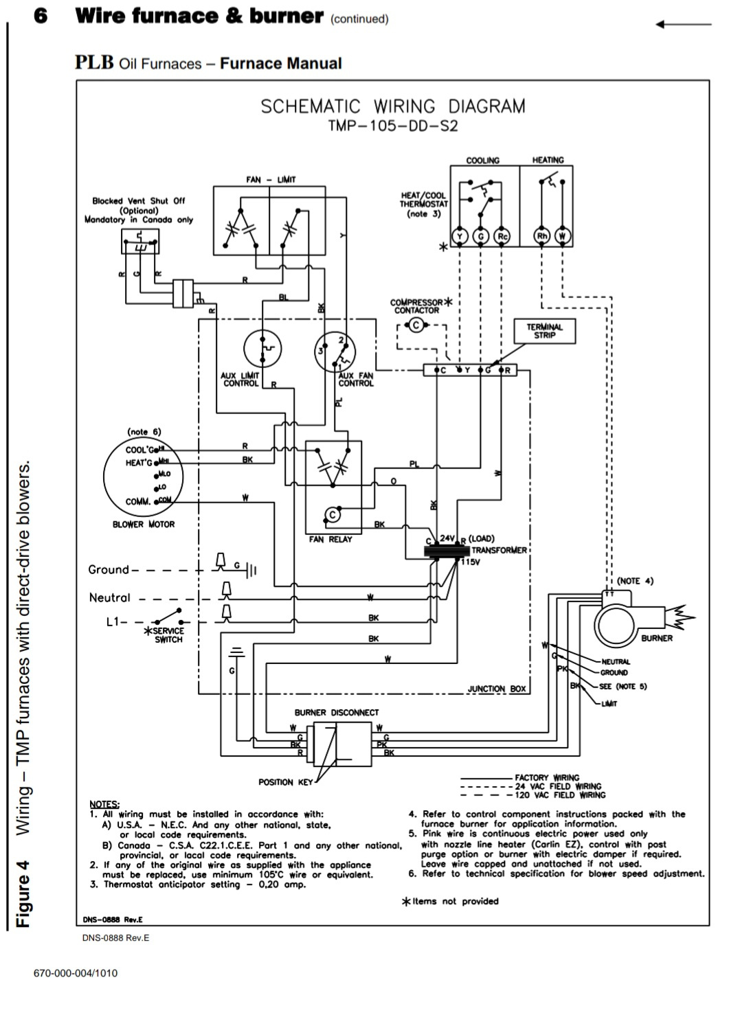

    What make and model furnace. It could be a high limit that's stuck open. It could be bad relay contacts to the burner. Does the Riello have low voltage connections on the control box? Does it have post purge? Do you have an electrical meter?

    Its a Williamson tmp 105 dd s2. No ac coil just heat

    i would start with jumpering r and w and see if it still happens
