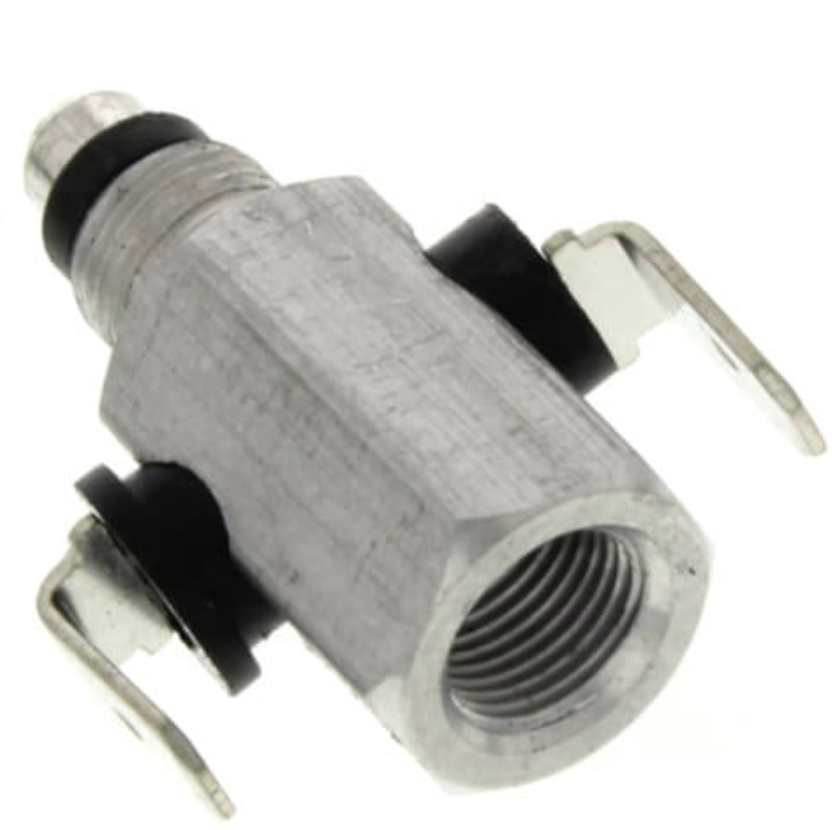

Then use a new thermocouple and allow the system to operate "Fine". You can not modify a thermocouple and expect it to work "Fine". You may want to try one of these things: Thermocouple Adaptor that will fit between the thermocouple and the gas valve.

Isn't that device you show for testing a thermocouple output with a meter? I need one that opens the center conductor in the line which is then completed by an external switch. The question is why modifying one exactly like is done by someone else won't work? All it is an enameled copper wire in a copper tube outer shield, much like a coax, cut the tube in two, discard the gas valve end, cut off a bit more on the thermocouple side, to expose the enameled center conductor and then it is just simple solder work. If you use a tubing cutter, you have to just score the tube a bit and then bend and break or if you go too far closing the cutter, the cutter will make a sharp edge on the inside of the tube which will short the center conductor making it useless.
baso makes the terminal adapter you need
