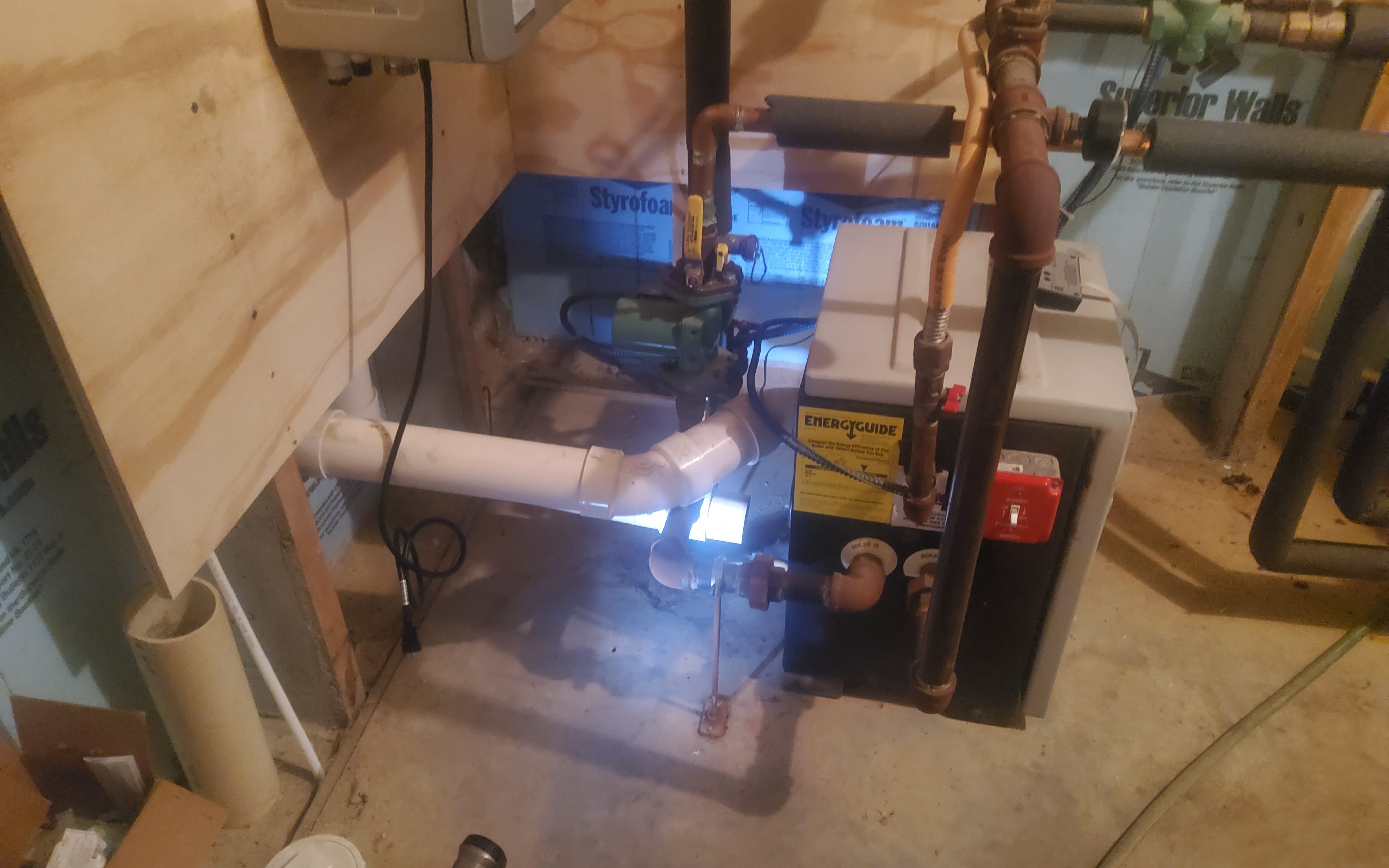

He wanted me to check things out as his son was installing a new boiler (himself) in his house. I found the exhaust pipe on the old Munchkin had popped off. His new boiler was mounted behind the Munchkin on the wall but no piping done yet. Very possible his working behind it knocked the exhaust off or at least loosened it.
