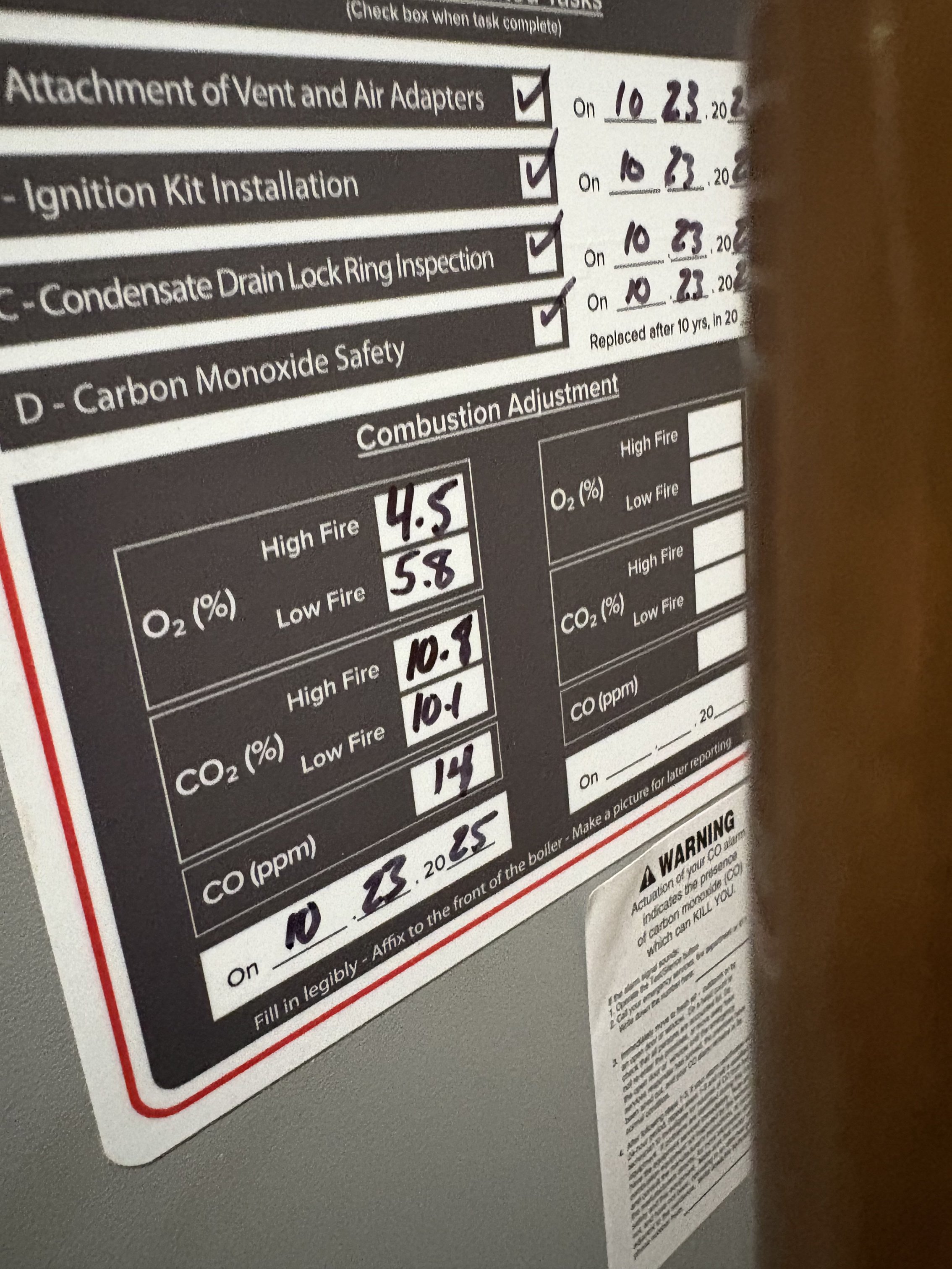

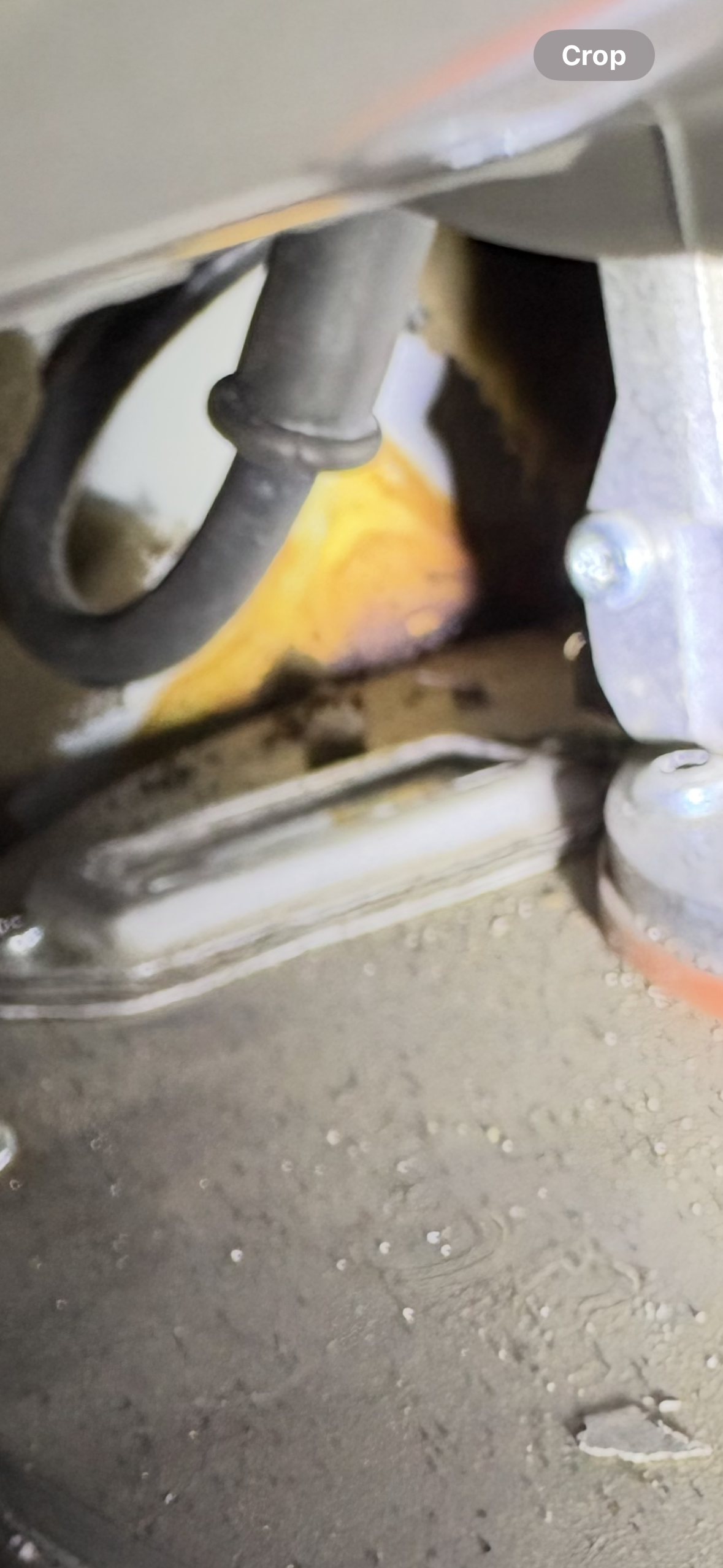

I had the recall done on my 13 year old boiler in October. Ran fine until about a month ago. Started getting occasional lockouts due to failed ignition. But now I am getting them more frequently so I did some digging. Took video of sight glass and attached a video. Also noticed the black foam around heat exchanger has melted. See attached pic. The flame doesn’t look healthy. Can’t find a new igniter online. As we know, TT folded. Does this recall really solve the issues we have with this boiler? The tech who did the recall says he is doing a lot of swap outs due to this issue and the recall wasn’t fixing the problem. He thinks that’s the reason they closed operations in the U.S. Am I looking at a replacement boiler soon?

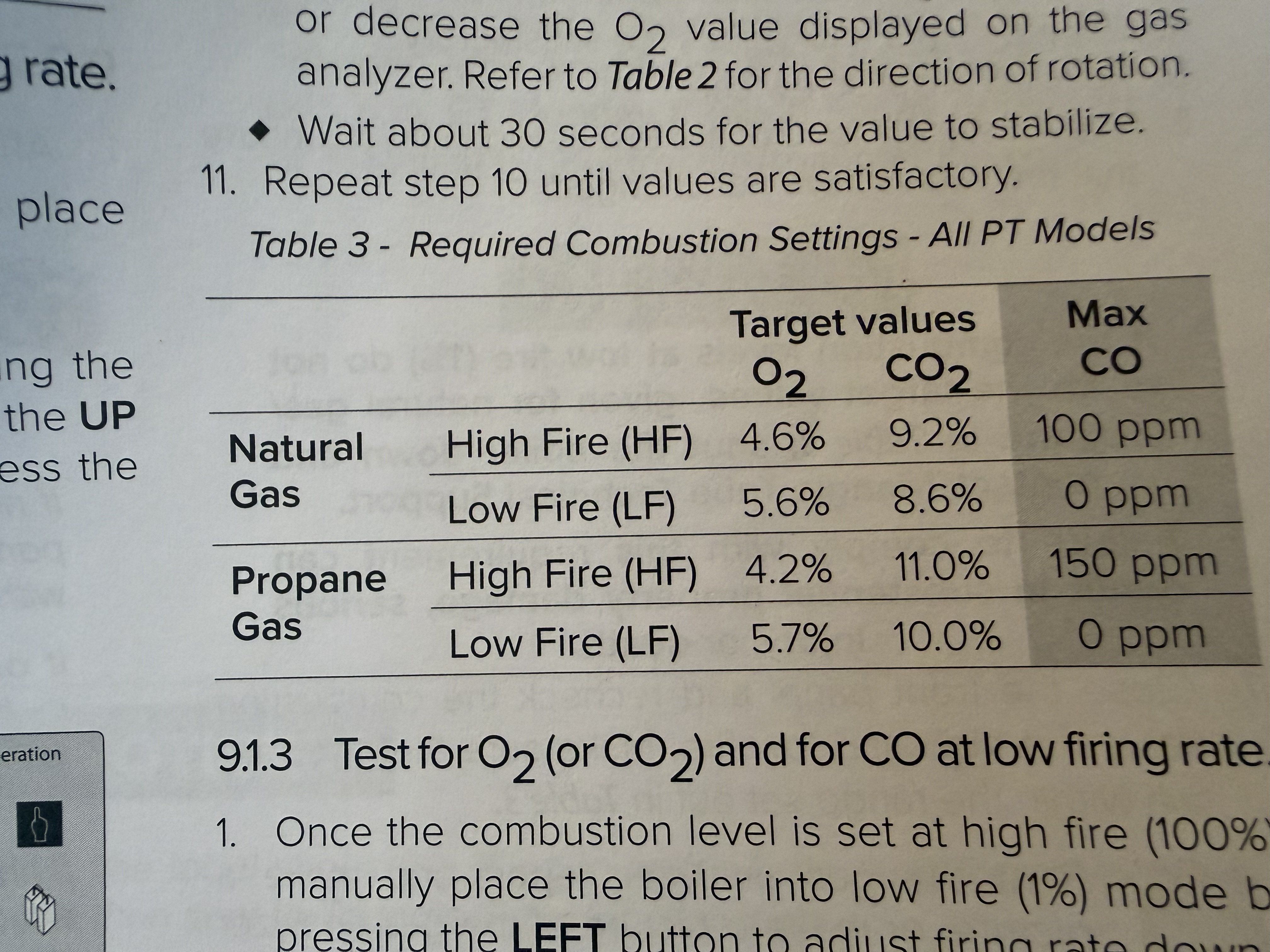

  • Those numbers look OK for propane, not natural gas.
    What model is your boiler?
    I’m surprised to see so much debris on the HX cover as part of the recall is to remove the cover to replace the HX gasket/insulation piece.

    I assume so yes, I just reached out to the tech who did the work to confirm. You are right, it is quite dirty but I do live on a dirt road so maybe dirt is getting there somehow. And yes propane

    the bolt that is near the rust spot is loose. How tight should it be. I could loosen with the extension and driver by hand. That must be part of the problem and the foam is damp.

    sorry, meant nut that holds on the top plate. It was loose so I definitely getting some bypass between the gasket and outside air.
  • GGross
    GGross Member Posts: 2,017
    should be tight but you usually don't really need to use muscle to tighten them up. Bit tighter than hand tight.
  • JMWHVAC
    JMWHVAC Member Posts: 118
    When the foam insulation is vanishing it may mean combustion exhaust is leaking out. I've had a few PT110 that begin leaking between the plastic flue collector and the stainless. Part of the recall is to put the fan on high and "bubble" around that plastic/stainless intersection. First question is, "how do you ever get bubble stuff on the backside?" Leaking boilers usually show developing rust on bare metal like screws and brackets and the foam starts vanishing right at the leaks, so if the inside looks great I don't "bubble".
  • wrxz24
    wrxz24 Member Posts: 326
    there is rust and the nut was loose. Tightened it up, I shoved some dry foam between the tube and the casing. to see if It still leaks. Still getting failed ignitions however..
  • wrxz24
    After tightening the loose nut on the plate, the boiler eventually fired, ran all night with 2 ignitions and fired this morning after a DHW call. Not sure if this was coincidence or not

    Alan (California Radiant) Forbes Member Posts: 4,828
    edited February 26
    Have someone else - if possible - come out and check your gas pressure with a manometer.
    And he should then do a combustion analysis to confirm the readings written down on the sticker on your boiler and with the figures I gave you before.
    And please be careful tightening those heat exchanger plate nuts Hand tight and then one turn with your wrench. I've seen them break off when over-tightened. Install a CO monitor in or close to the room with the boiler.
