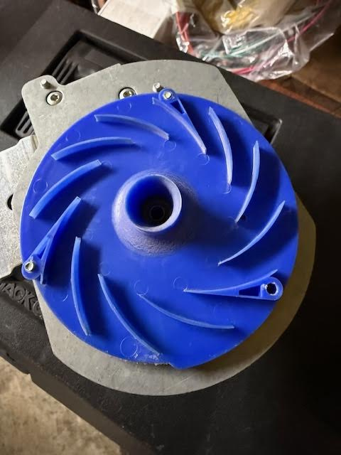

This boiler has been flawless for 20 years and then slowly, it's starts making combustion harmonics. I've cleaned the HX, set combustion at 9% CO2 and then again at 10%, upgraded to the 926 board and replaced the burner in 2020 and last week, after no luck doing anything else, replaced the gas valve and swirl plate.
Separate intake air and exhaust. The owner sent me this video.

Was the burner cone in good condition? When they burn a hole through they can get weird. Is it the mesh type, or the slotted stainless tube?

I would have guessed the swirl plate. There are several types… Are you sure that its the right version? How did the old one look?
The burner looked fine the last time I cleaned it. Mesh type that I replaced 6 years ago.
And the original swirl plate that I removed looked almost new.

Certainly, an annoying vibration. It starts when the flame occurs. It doesn't happen when the blower is in pre-purge. I would look at supply gas pressure, gas connection to the boiler any partially closed gas valves, there should be two.
A mechanics stethoscope might pin point the origins of the vibration. I use one that I bought for my car. It gives a visual and audio indication from several locations at the same time. Not expensive. You should have one. An important tool.
Also possible that the gasket on the burner tube is incorrectly installed or leaky. Tighten the 4 screws on the burner tube really tight. just thinking what could vibrate. Is the gas valve pulling a vacuum?
@Alan (California Radiant) Forbes Has the gas pressure changed? What was it to start? What is the pressure now?

From what the owner says, the sound started mild and then slowly increased in volume and duration over time.
