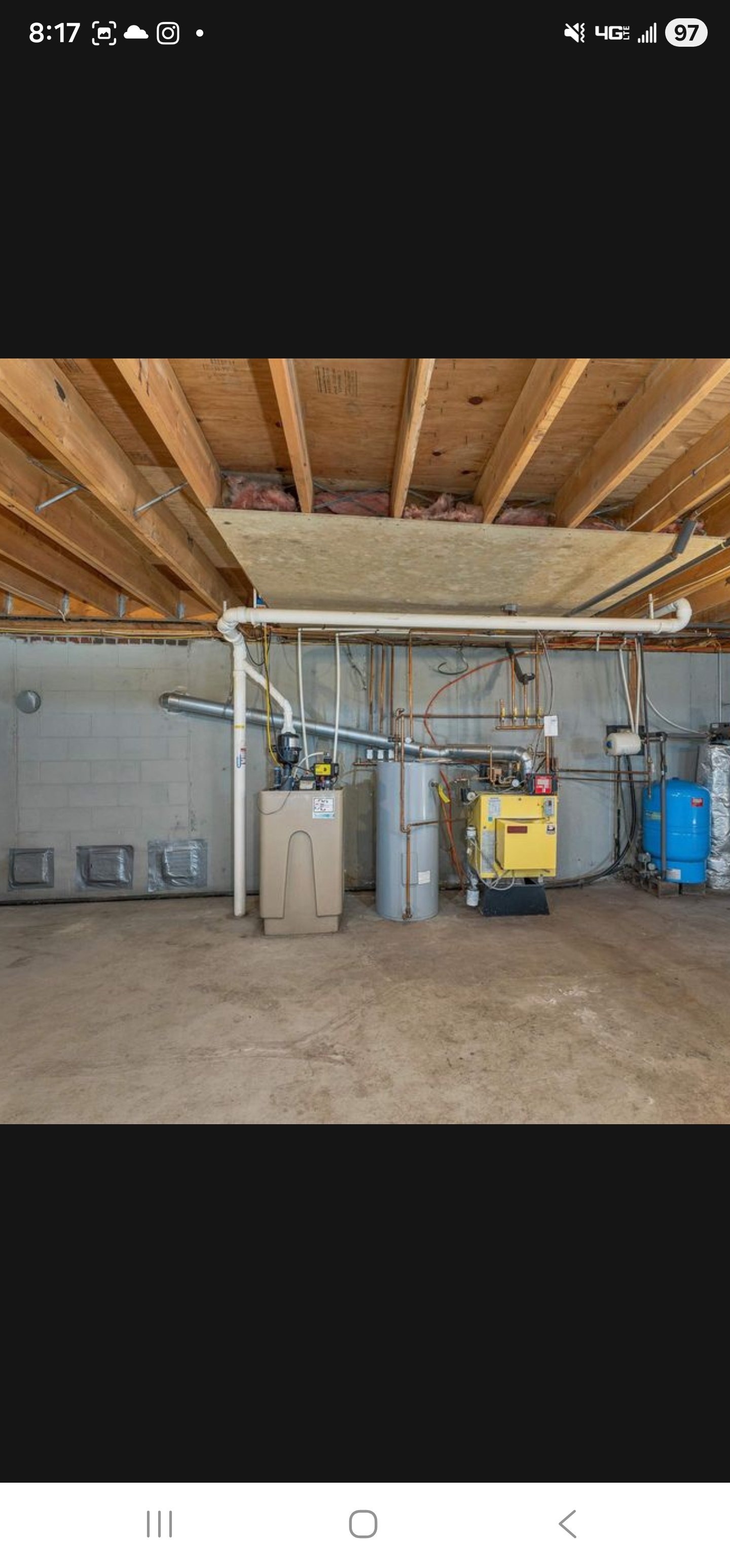

I just purchased a House that has a EK system 2000 that was installed in 2016 3 days after I moved in I noticed it getting cold in the house I went to the basement and the 140 Deg light was flashing and the Resideo R7284 said hard lock out I reset them and it fired right up and ran fine for 3 full days. it happened again so i contacted the previous owner and they said it locked up on then once in January and they had a company come and they said every thing looks great but there was a power outage/power surge so they replaced the Beckett burner control to the Resideo. I called my oil company and they can in and performed a full yearly tune up and burner cleaning and the tech said everything looks great and didn't go into diagnosing the issue. it has happened 4 more times in the last 2 weeks ive checked the circulator pump the 3 zone valves and all look good to me the valves open and close and the pump is circulating. the system does have a tigerloop installed if that makes a difference there is no oil in the top chamber or excessive condensation but the vacuum gauge before the tigerloop is barely off the zero mark. any help would be greatly appreciated I have a wife and very young daughter and this is starting to worry me. the system and oil tank are from 2016 the oil tank is about 6 feet away from the boiler and the oil line is run overhead if that makes a difference.

I don't know who installed this but you flue pipe should not be pointing down hill. If you oil company looked at the flue pipe and thinks it is ok you need a new service company.

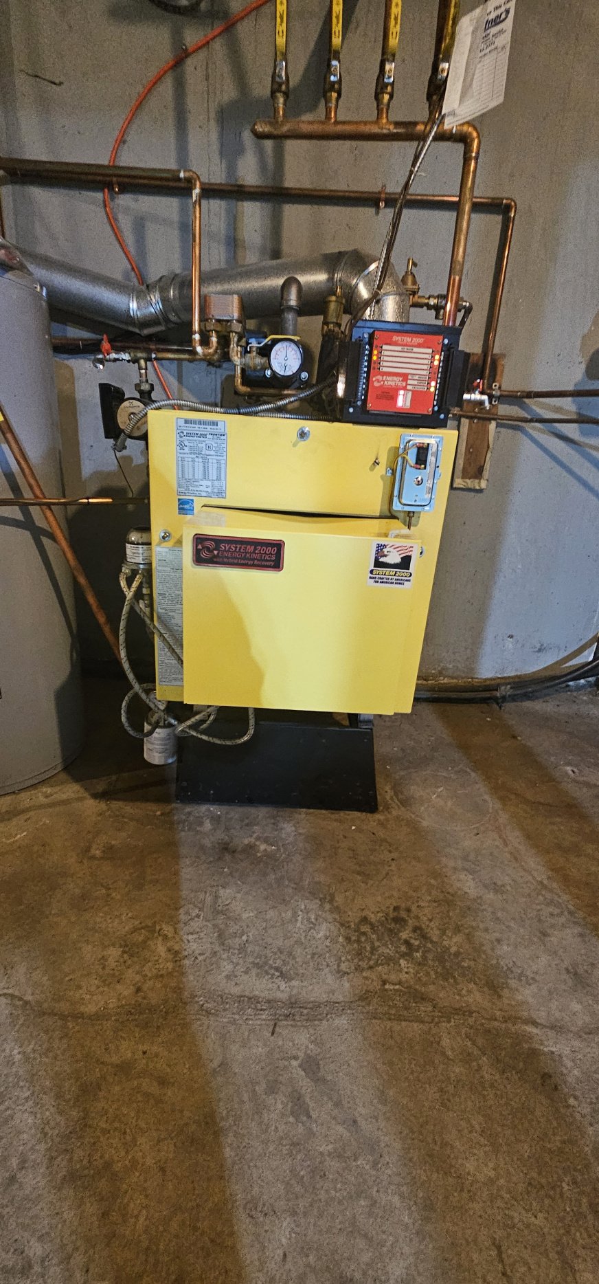

The 140 code means return water temperature didn’t rise enough within 27 minutes. If pressing the reset button started the burner, then the tech must troubleshoot the burner. The Puff Switch should be wired in series with the cad cell using that primary. So with the flue pipe like it is, its possible the Puff Switch is opening and putting the primary into safety. There's only one way to find out.
Good morning,
All good info here. The 140 flash is happening due to the burner lock out in this case as pointed out, the manager is looking for a temperature rise over 100 degrees at the return sensor. When this isn't achieved, we go into a freeze protection and open all the outputs and leave the circulator on to keep the water moving.
Yes, also as pointed out the puff switch will be wired in series with the cad cell and it's designed to open at positive pressure. Best course here would be to have a service professional come in and check boiler for soot and confirm draft is present. I would ask him to address that smoke pipe issue as well. While our boiler's do run with smoke pipe back pitched as stated in our install manual, proper draft must be present for it run correctly. It would be a good idea to pull that smoke pipe all apart and be sure its clear and get some support on the piping Also look at any oil feed issues or burner issues present. Lastly, after all is cleaned and checked, confirm burner settings with a combustion analyzer.

When I had it serviced last week he said the flue pipe looked strange with that bend. I have 603 chimney coming in today to investigate further and check it out. Also when they did the efficiency test with the service it was at 84%. Ill report back after the flue is checked and adjusted I appreciate it
603 chimney came out and cleaned the chimney and adjusted the pipe looks and should flow alot better

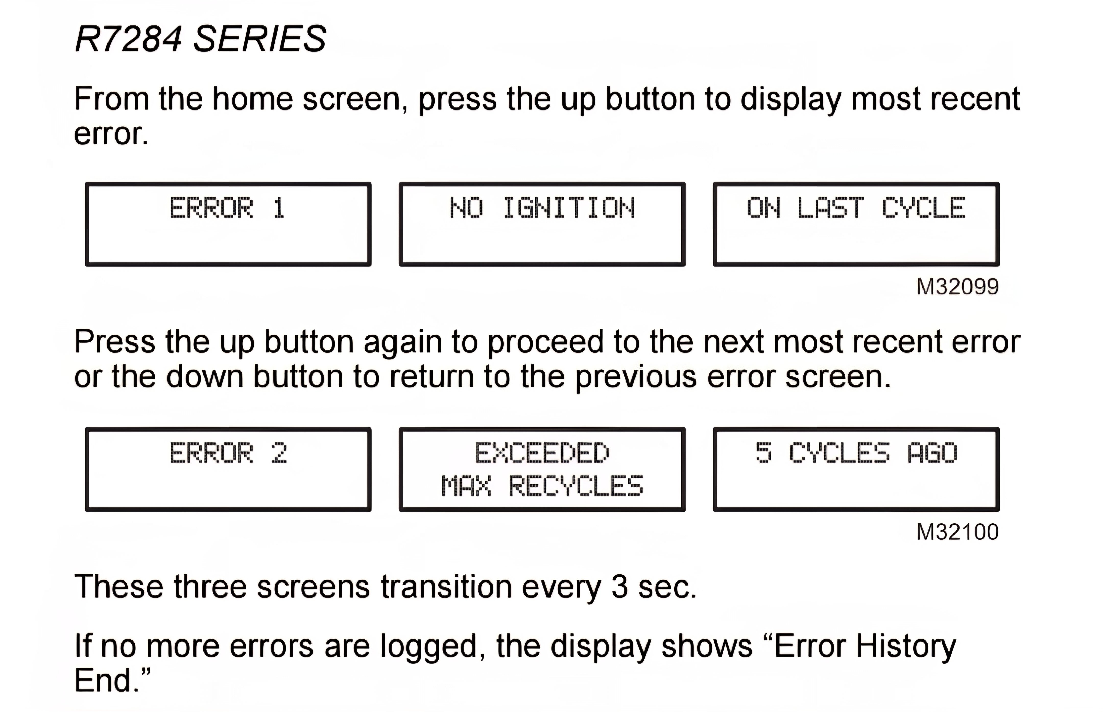

The primary will display the reason for lockout. "No ignition", "Flame loss", etc. If the 140 code happens again, check the primary display.

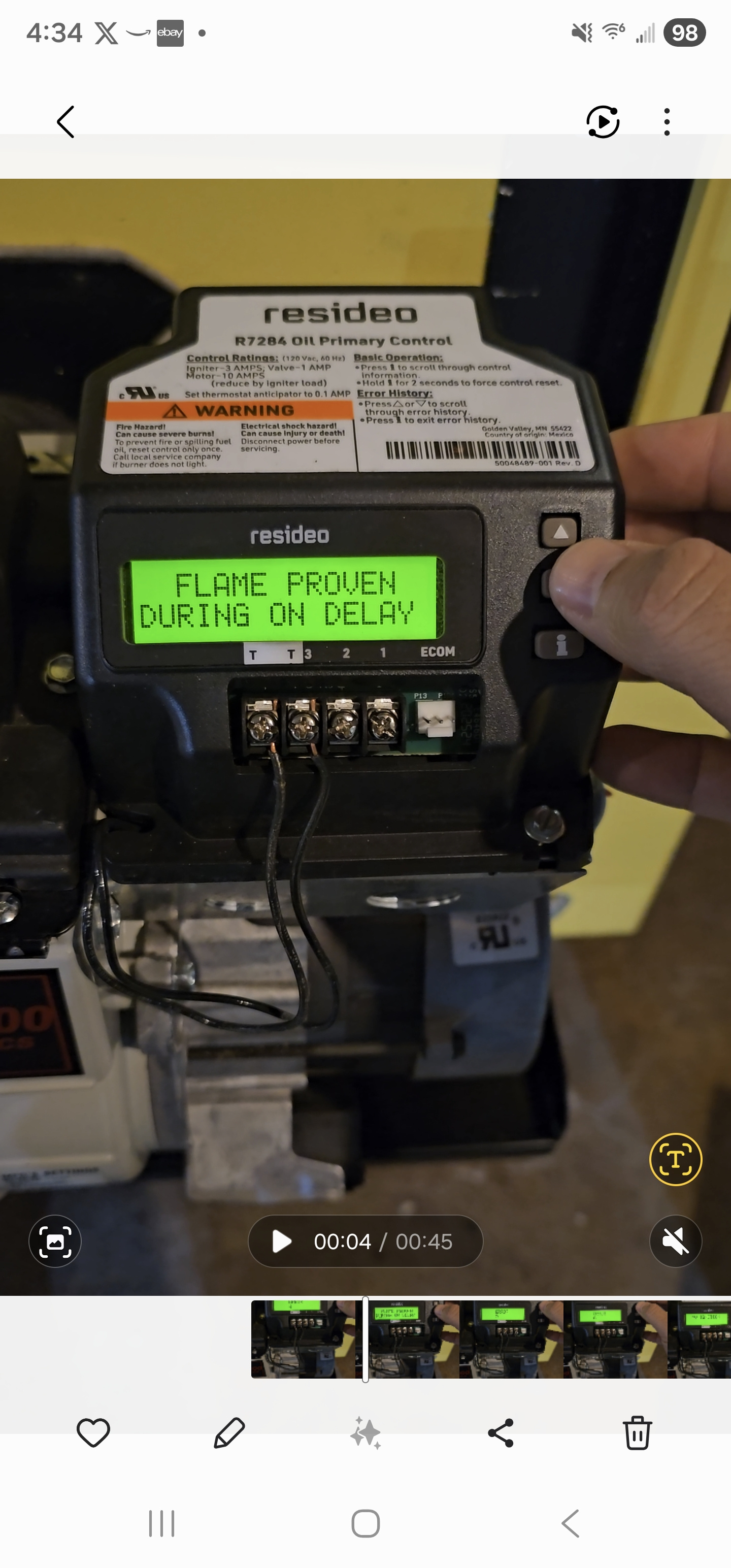

Ok the primary always shows hardlockout is there a button i need to hit to see the trouble codes?
Ok just woke up to a 58 degree house and went down to the furnace and the codes are (flame proven during on delay) every time.
That would likely be problem with the oil pump or the oil pump solenoid valve. Your tech needs to check the oil pump with a pump testing manifold.

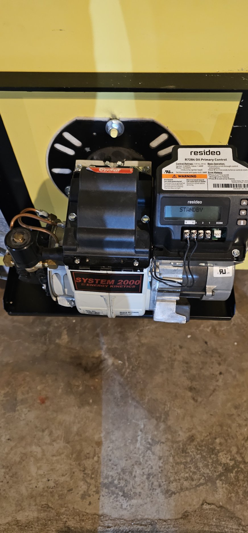

Do you know when the R7284 was installed? It wasn't OEM with the boiler.
If you're up to it you can check a few things.
Shut off the power to the boiler. Remove the R7284 and check the wiring. The purple wire should be going to the "valve" terminal all by itself. Orange on "motor" by itself. Blue on "igniter" by itself. Be careful putting the control back on. Its easy to pinch wires between the control and junction box.
Next you need to check the programming of the R7284. If you don't have the manual, download it. Go into installer setup. You want this configuration.
(1) Language: English? (Parles-tu Francais? ¿Hablas Espanol?)
(2) Valve on delay: 0:15
(3) Ignition time: 0.15
(4) Burner off delay: 0.00
(5) TT configured on: No
(6) Spark in on delay: Yes
(7) Spark during run: No

It would indeed appear that your delayed oil valve maybe passing oil on the pre-purge cycle.
It would be best if your service person gave us a call from the job site and we can walk him thru the trouble shooting.
