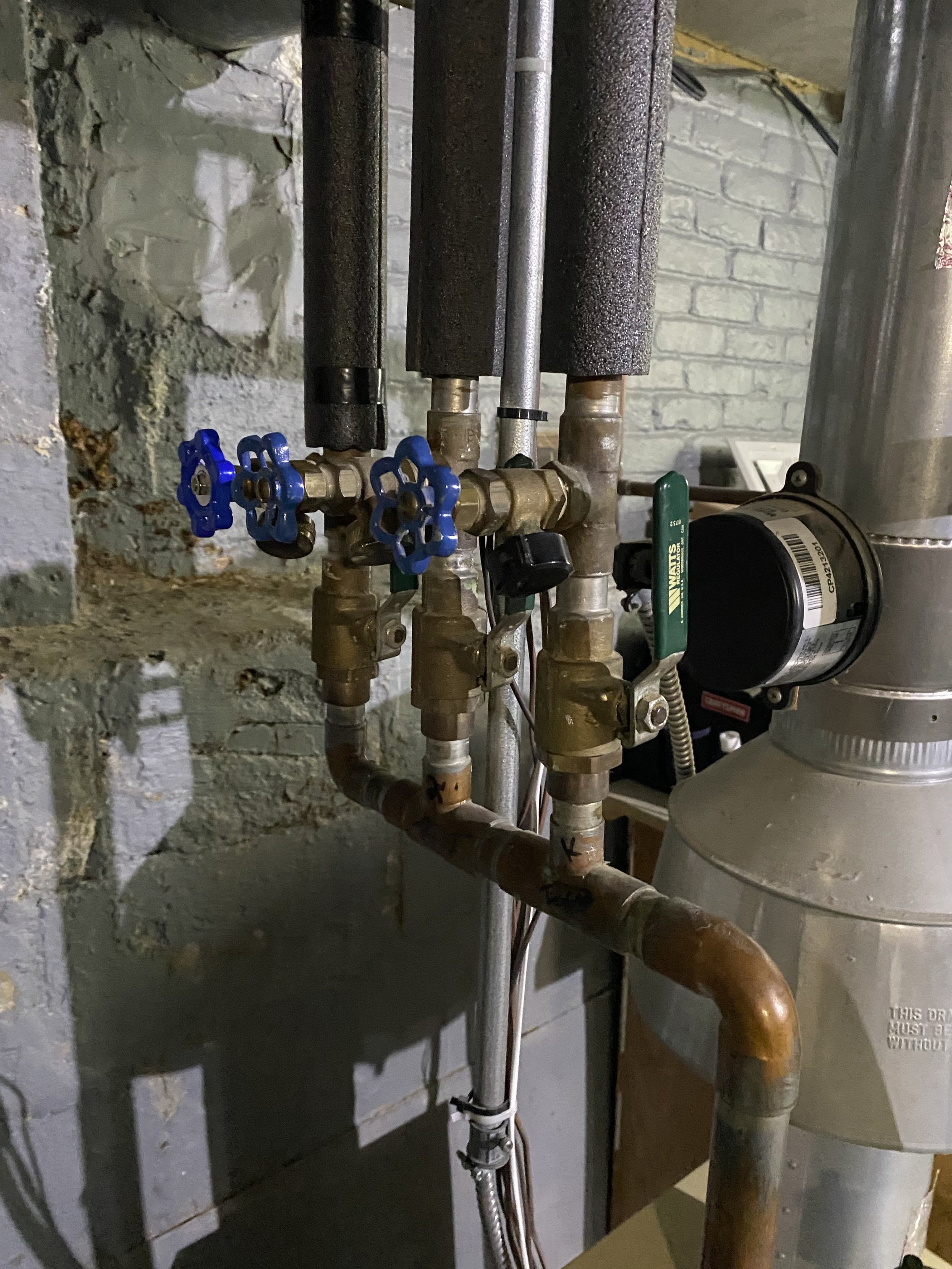

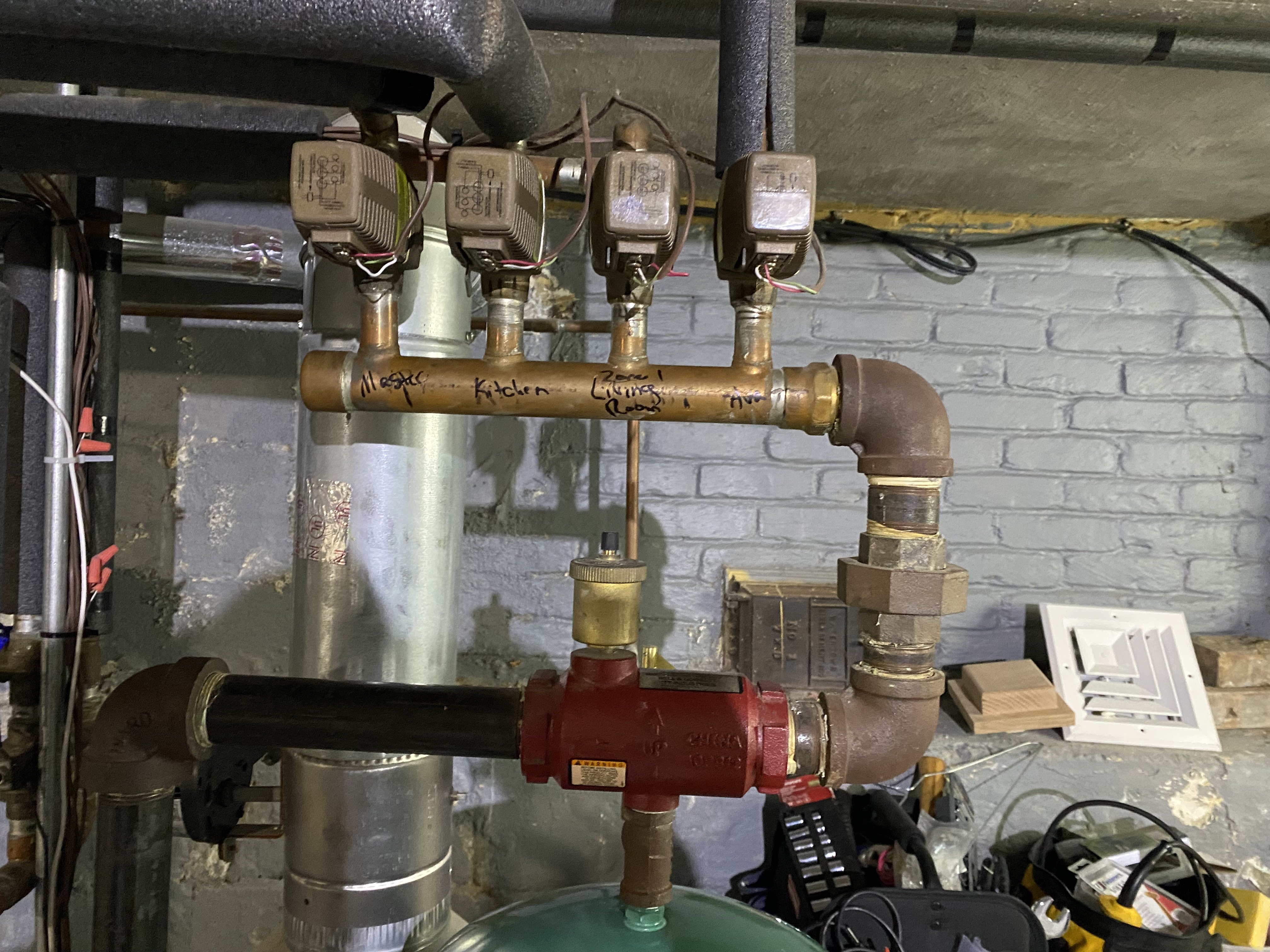

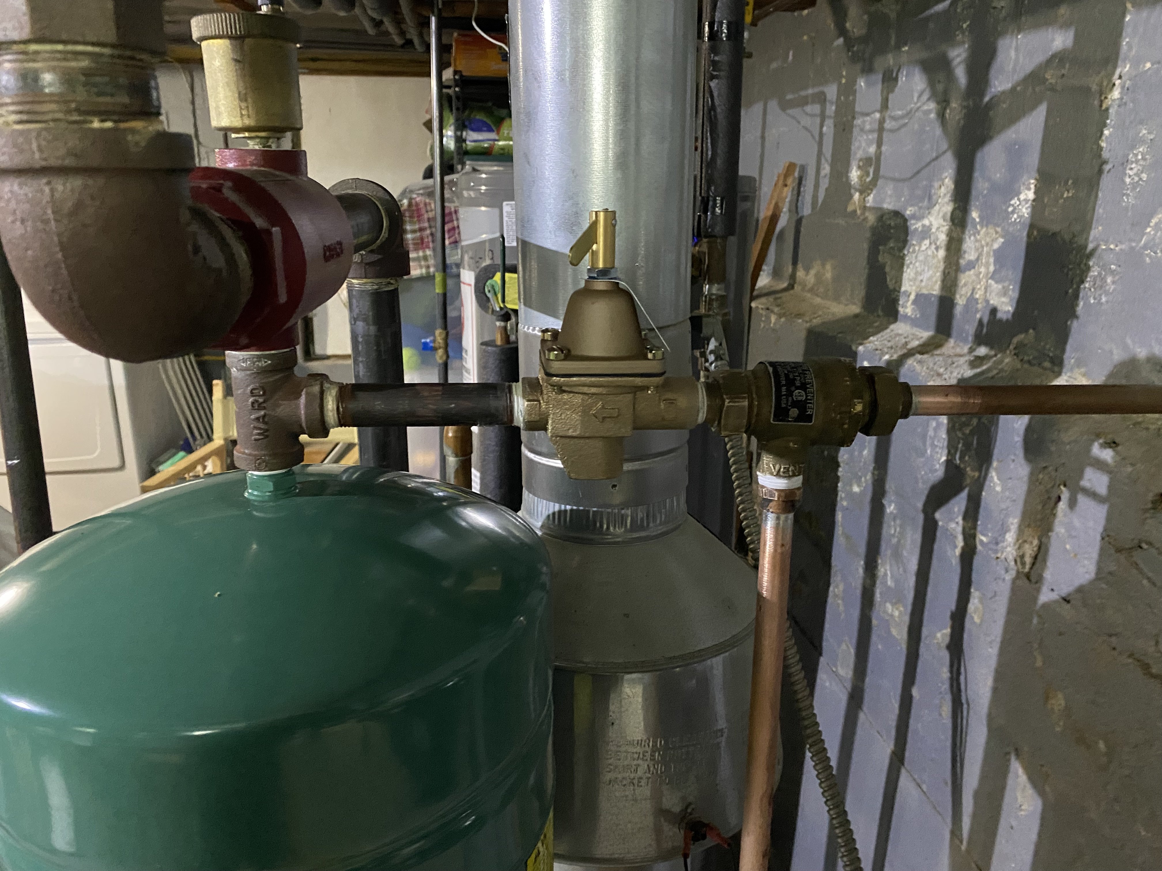

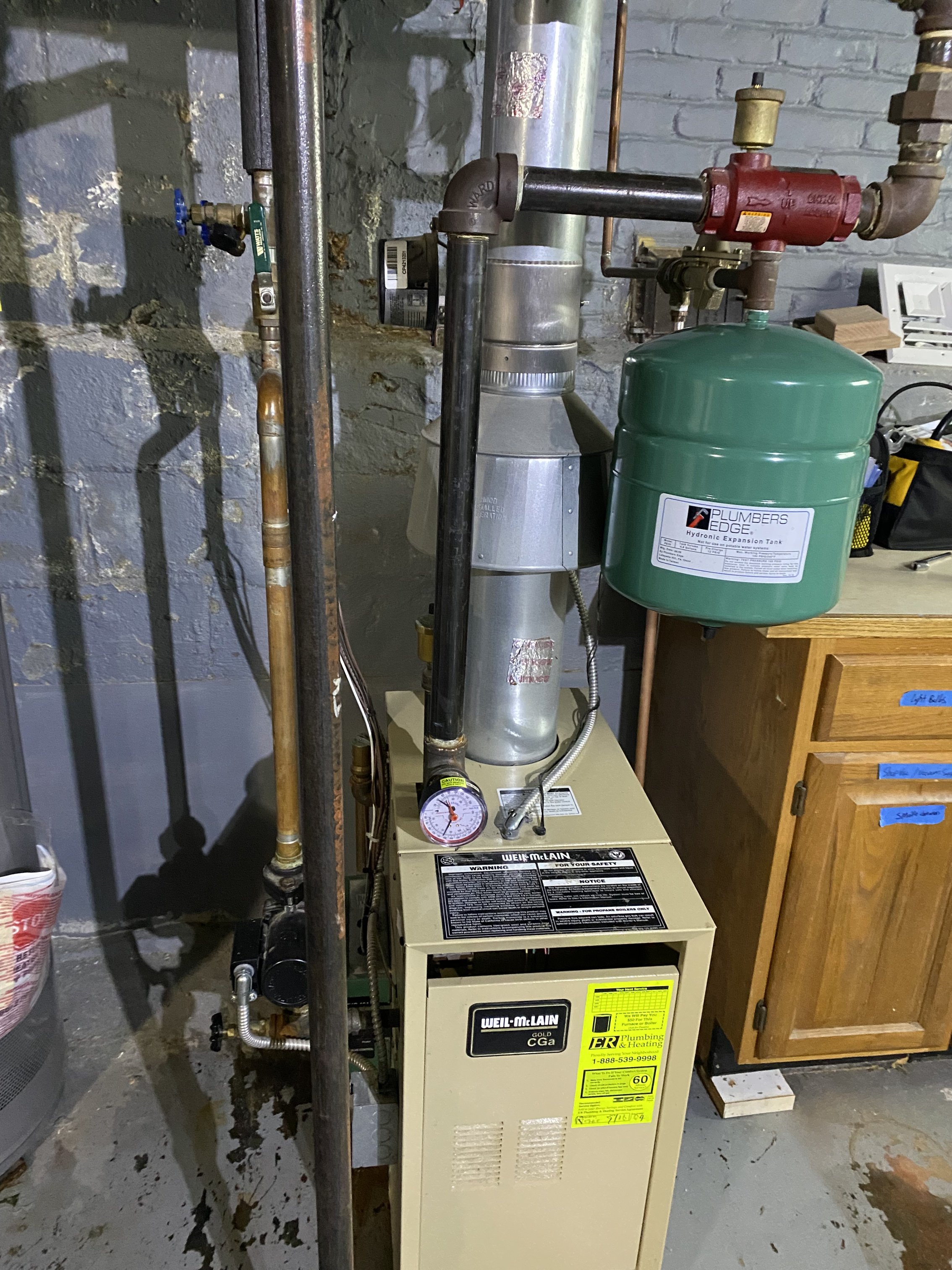

    can you post pictures?

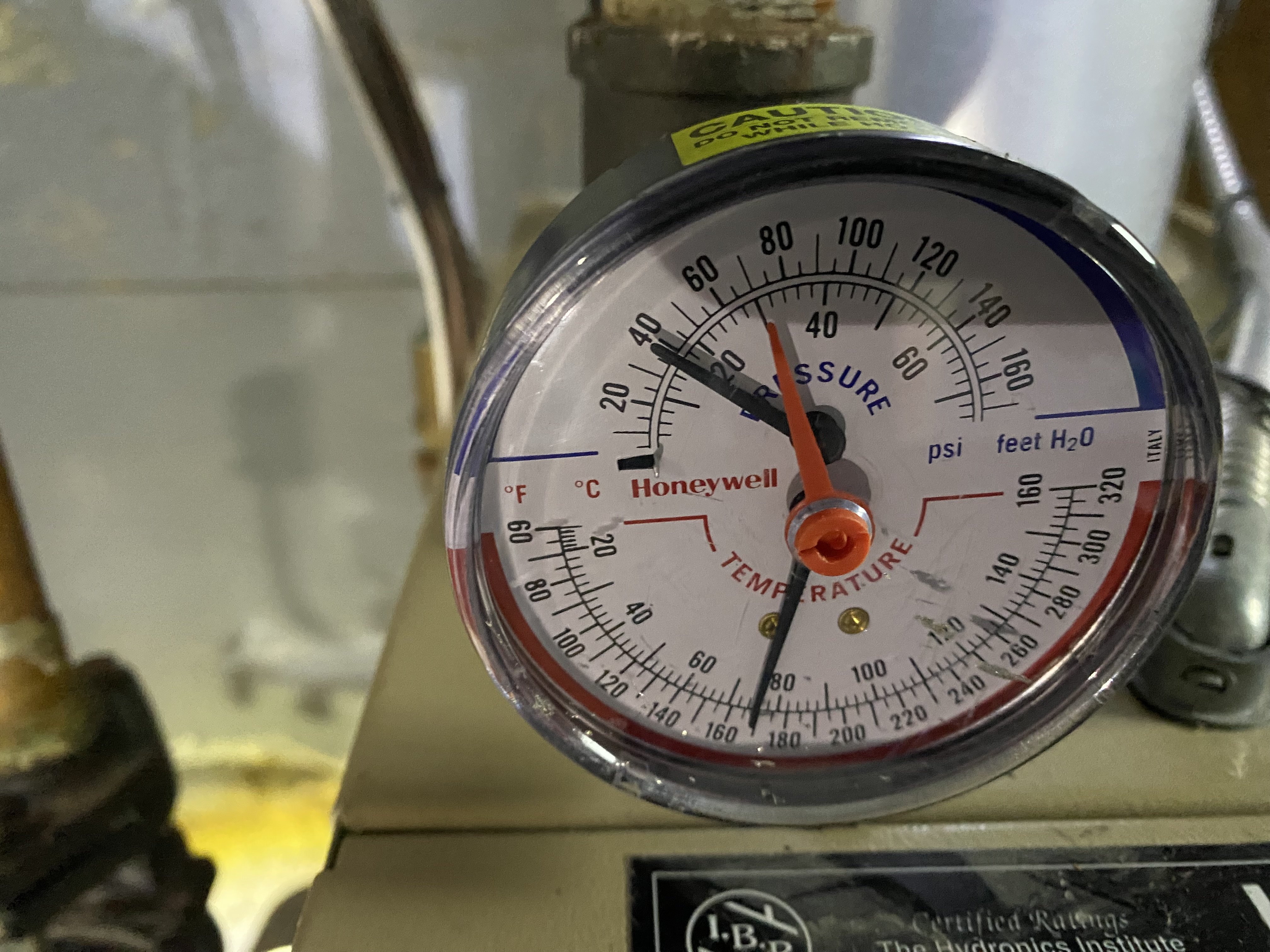

  • neilc
    neilc Posts: 3,213
    nah, look at your gage again, that's 40 foot of head(outside scale), and 15psi(inside scale), I think your ok there,
    what was / is dripping? the relief, or the backflow?
    known to beat dead horses
    BostopaAlan (California Radiant) ForbesGrallert
  • Bostopa
    Bostopa Posts: 23
    Neilc…. Geez Louise!!! How the heck did I not see that!!!!!
    thank you for pointing it out!!! I’ll get it just the pressure relief valve that needs changing!!! I’ll do that weds! We are going to get hammered here in Boston tonight and tomorrow
  • Your pump is on the return and the expansion tank is on the supply. Every time your pump turns on, there's a drop in pressure on the suction side of the pump. If the drop is large enough, it might cause the fill valve to add water and if this happens long enough, pressure will build enough to open the relief valve.
    I'm not saying that this is happening to your system. There are thousands of systems out there like yours. Some are affected, some aren't. Many would say to move the pump so it's pumping away from the x-tank.
  • Bostopa
    Bostopa Posts: 23
    Alan - Thanks understood…thats gonna have to be a summer job
