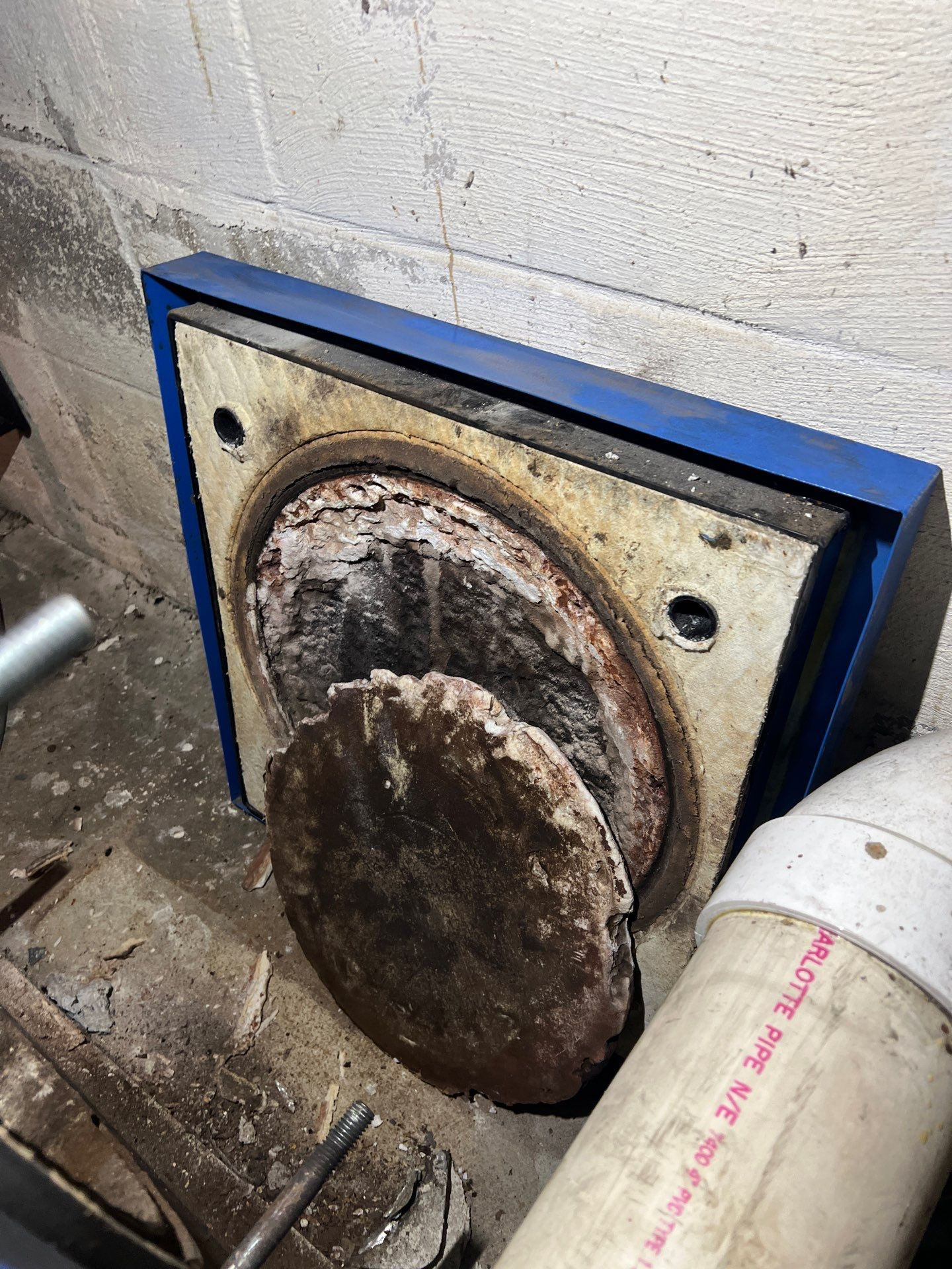

Rebuild Target Wall on Trianco(Laars) Max-100
wwesthafer
Posts: 1
in Oil Heating

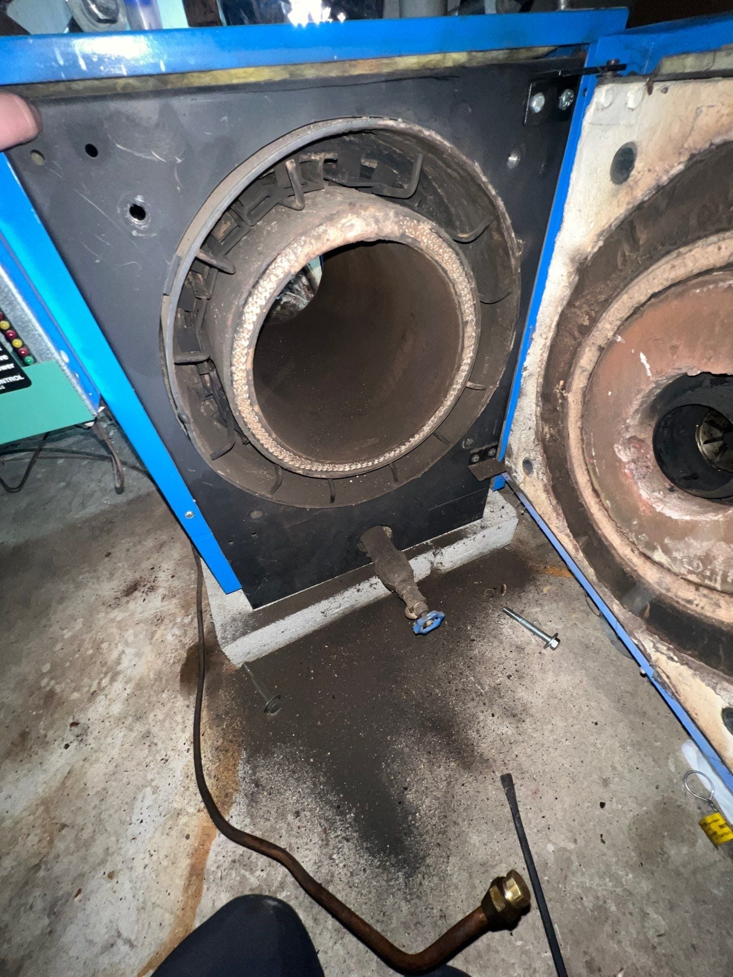

Contacted my local Laars dealer about a target wall for this boiler and they are not available. Anybody familiar with this boiler that can confirm this is just a 18x18x1.5 flat piece of ceramic fiber board? Pretty sure the center circle delaminated from the rest of the sheet.
I'd say you need the burner door board as well. Or a really deep amulet.
