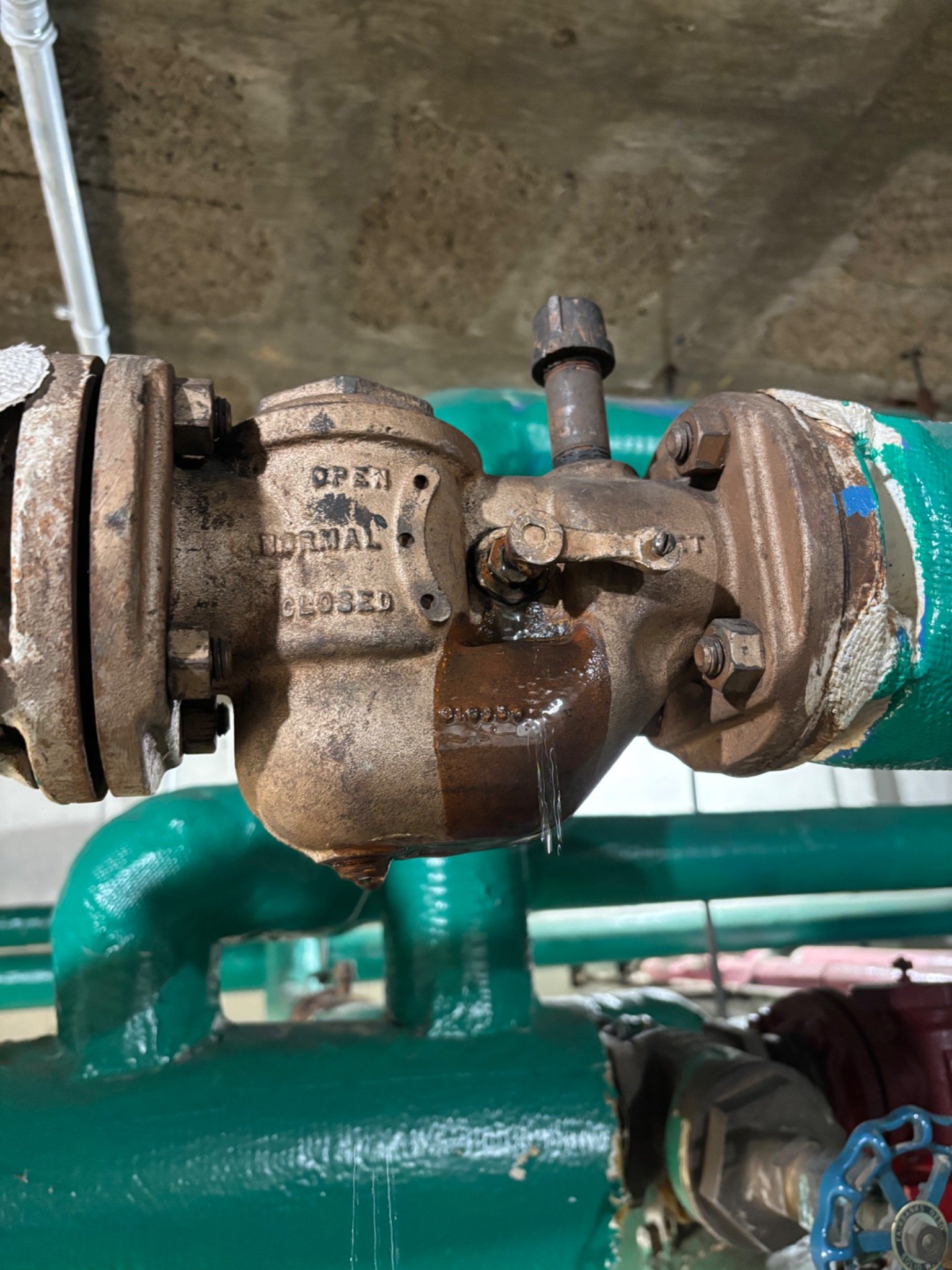

Vintage Dunham Flow Control Valve
Anybody happen to know any specifics on this vintage Dunham valve? Old enough that the distributor doesn't have any real info on it, and had no luck scraping the internet for info. We're thinking a a suitable replacement might just be a modern balancing valve but wanted to see if one of y'all might have any esoteric knowledge about it.

    I imagine it may be a simple butterfly valve inside that the lever moves to one of 3 positions.
    It looks like the lever is 180• off from normal. The screw locks the lever into the indents, I think.
    It may be a basic graphite string packing under the stem nut, if that is the leak problem. Maybe just try tightening that outer gland nut?
    I'm not sure you will find a valve to fit that flange to flange spacing?
    You might try Mepco, looks like they took over the Dunham product line. Someone there could identify the valve perhaps.

    Its a flow check, it prevents the hot water from the boiler to rise up to the radiators once the heat circulator shuts off …

    I was originally thinking it was a old school triple duty valve, but yea after a closer look with your comments it looks like its just a check valve that you can also force open or closed, not throttling

    Open, is open . Closed is not a shut off . You can set it to Closed if Normal does not work .. The pipe off the top was connected to the expansion tank at one time ..

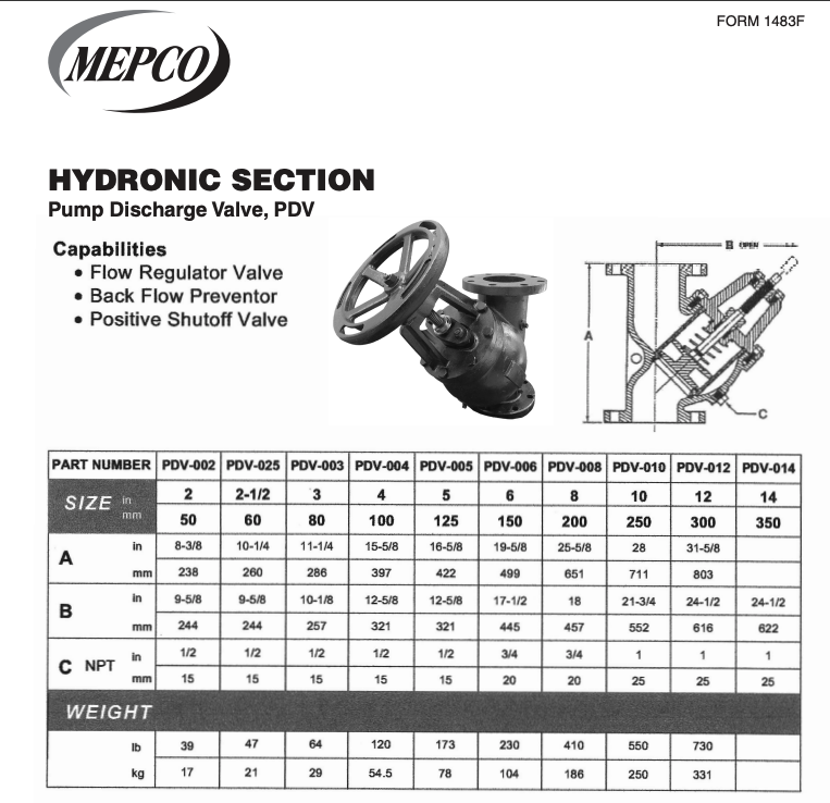

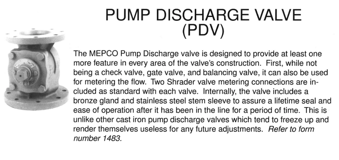

    hot_rod Posts: 28,585
    Where is it located in the piping? Discharge of the pump?
    This is a similar valve in that it is a check, flow balance, and shut-off. Often called a triple duty valve.
    Typically found at the pump discharge. It may have the same flange to flange dimension.
    I would call Mepco to confirm it could be a swap out component.

    @Big Ed_4 is right. It's a flo-check. Not sure what size it is, but it's definitely out of production. IIRC TACO makes one that can be installed horizontally as well as vertically. This might require changing the length of the pipes, but it will work.

    B & G FAS flow control….2" X 2".
    I have some on a 1961 boiler. Might have the flange on one end only.
    There is a small lever on the top to put in permanent open mode.
    No "Off" position. Weighted lift check in side that pump pressure would open.

    I agree it is just a standard flow check.
    The "flow control" name leads you to believe it is something exotic.
    I have seen one that looked similar the one above may have been made by Thrush.
    Why is the lever turned the wrong way?
    It should be set to open-closed or normal with the screw set in the divot.
    Triple duty valves, zone valves, control valves that are flanged are not so easy to replace. They are not like flanged globe or gate valves that have standard dimensions. They have whatever measurements the mfg decides on.

    As, to why the handle is backwards, no idea. That's a better question for the site engineers and sometimes the things those guys do makes you wonder, 😂. Who knows if the entire system even works properly. This is the kind of building where they say "Quote this" and you quote exactly that no matter what is actually wrong.
    I wasn't on site there, only have a few photos from my guy that was there, so I have limited info to work with, but it's 2.5" pipe. B&G's used to make flow checks in that size but they're obsolete now unless I can find new old stock so it looks like I'll likely be tracking down a Watts 2000-M5 and we'll tweak the piping as needed.
