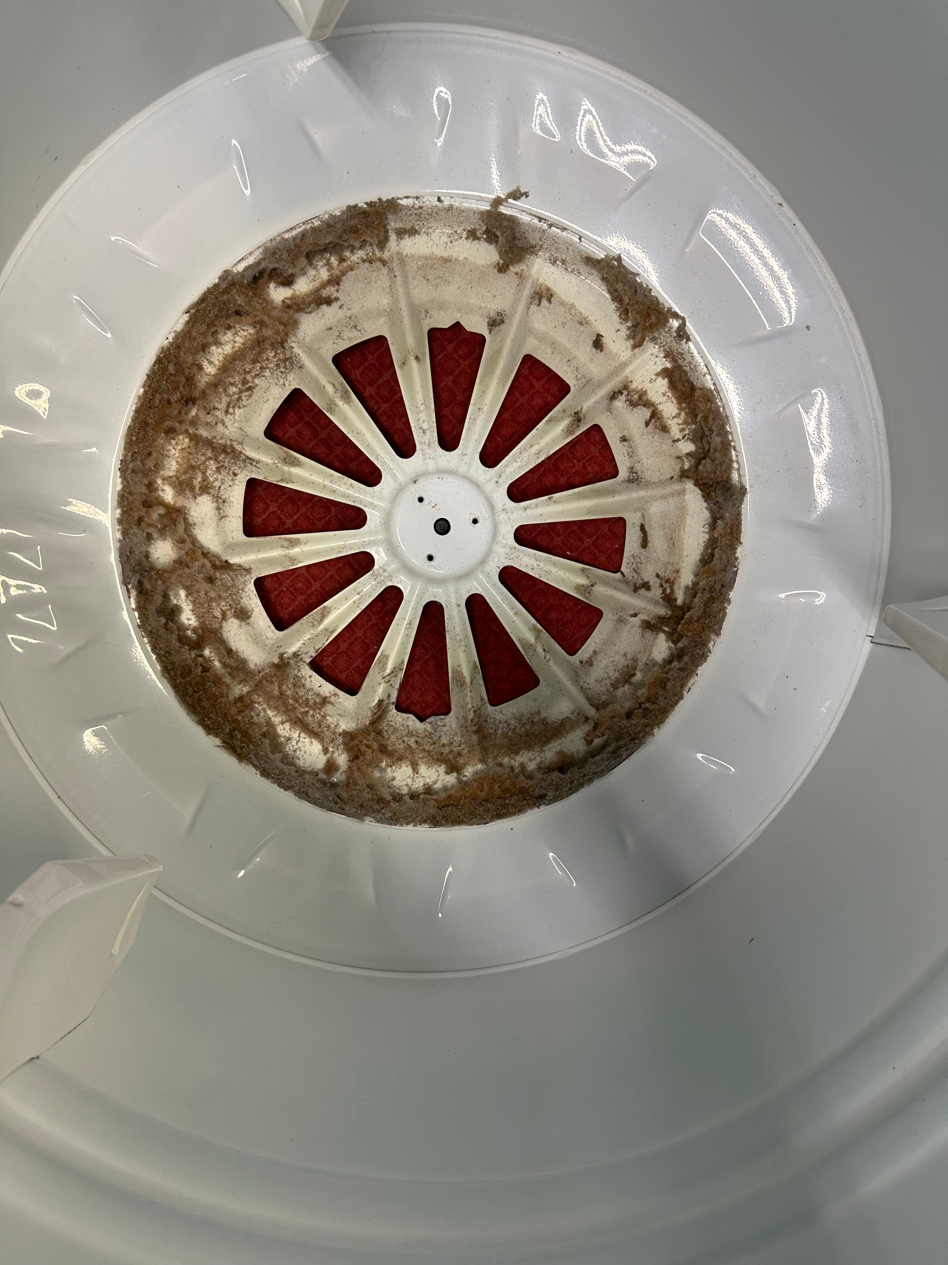

A few years ago, I did some repairs on a dryer in the parsonage of the church I attend. I had to remove the drum so I could replace the bearing in the back. To do that, for this particular dryer, I had to remove the cover inside the back of the drum. This is what I found between the cover and the drum!
My guess is no one ever removes this cover to clean or vacuums the inside of the dryer. I had never done it in the 52 years of owning a house. And being that it is at the vent exit from the drum, it ss the hottest part of the exhaust path
Fire trap, maybe??
"is" not "ss"
Fabric softener leaves a sticky mess on its way out ..

I just realized I had the direction of flow backwards! The hot air comes into the drum from the back and exits at the screen in the front of the dryer. As the youngsters would say, "My bad!"
With this realization, my statement that the air is the hottest at this location is even more true as the air has not yet gotten to the clothes.
Thanks EBEBRATT-Ed, your comment brought me to true reality, making my concern even more valid.
