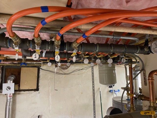

A few years back I redid the boiler and ran home runs of pex al pex to pick up each of the radiators in my house and its been running really well. I left the piping up to the radiators intact and picked up the piping in the basement but I'd like to take it to the next level to make it a little more efficient distributing the heat. All the radiators heat well so I don't feel like I am trying to solve a balancing issue. Just trying to turn on and off flow once a room is satisfied. Front rooms get plenty of sun during day where as back rooms are more shady kind of control.
I have good old cast iron radiators and I am a little reluctant because of the cast iron and the age of the radiators to go cranking off the old valves and installing the TRV right at the radiator but I'll give it a try if that's the way most of you have successfully done it but I was wondering if any of you have rigged up actuators or zone valves or some other powered valves that turn the heat on and off to each radiator based on the rooms temp. I am going to do this in the bedrooms first since those 3 rooms get the warmest since they are really not large rooms and I'd rather have the most heat on the main floor since it will still eventually make its way to the 2nd floor anyway.
It's a small house so I was not looking to do every room/radiator as an individual tradition sense of a zone, turning on and off the boiler so I wasn't considering connecting the end switches if I did use a zone type valve device at the manifold. I am really just looking for ideas to use some type of electric operated valve to open and close based on a room temp/thermostat once the temp is satisfied.
or if thats all really over complicating it, I will just give the radiator TRV a whirl and cross my fingers the old valve threads comes apart without wrecking the radiator.

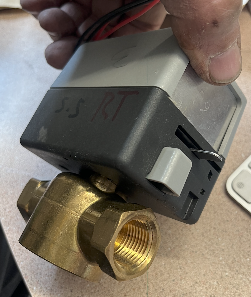

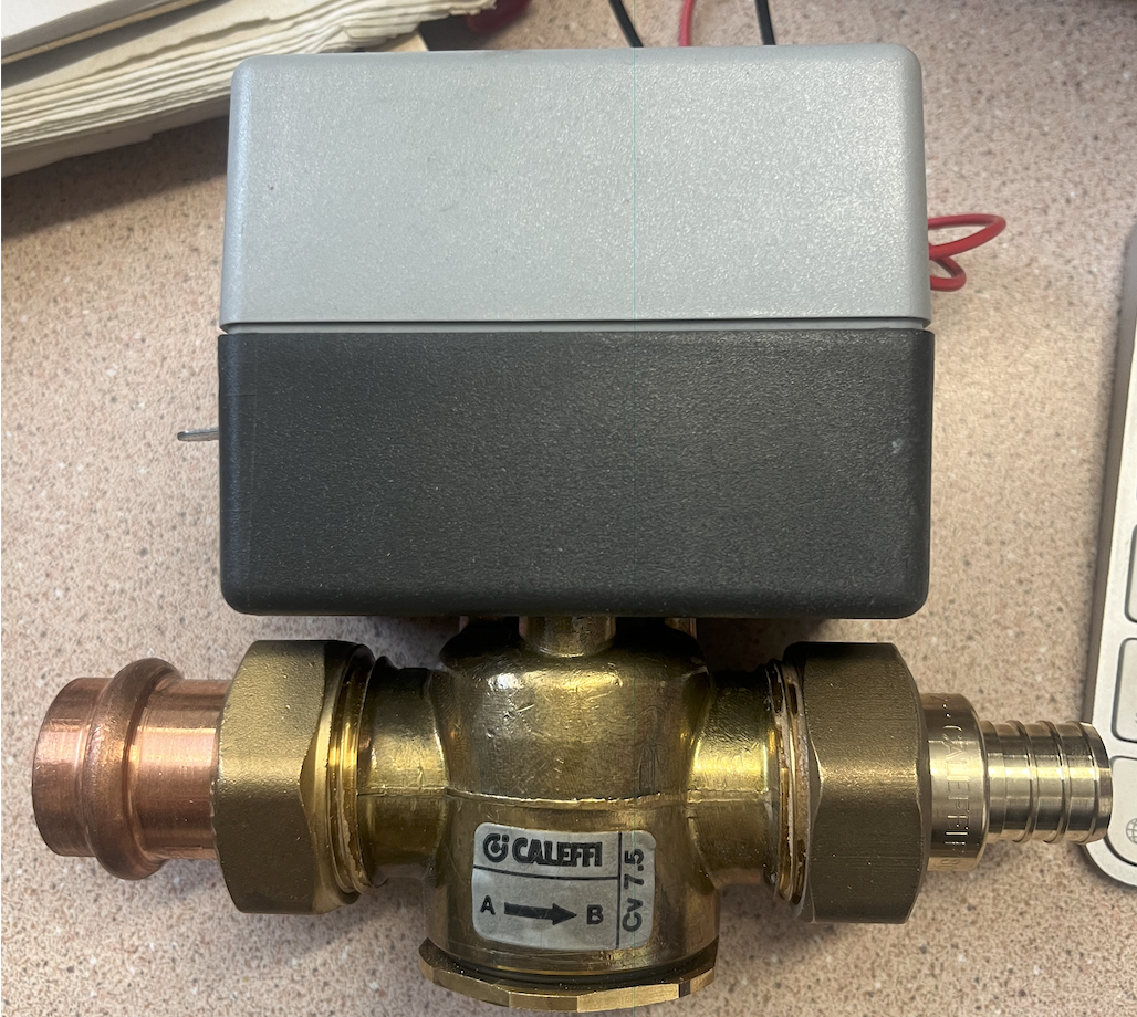

    Do you have a manifold that accepts actuators? If not solder in or crimp in regular zone valves. You can get ZVs with crimp pex connections.
    Then you need to run a wire to the thermostat location.
    And yes, as zone valves close off, the remaining zones get more flow. The rule of thumb with a fixed speed circ,is with 4 or more zone valves install a pressure bypass valve, or a variable speed, delta P circulator
    If you zone and hear excessive noise with only one or two zones, then you need to address that.
    Here is an example of a copper press by pex zone valve. You can mix and match press, sweat, pex crimp or expansion, or threaded adapters.

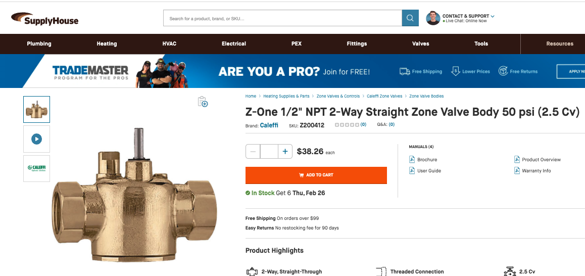

    @hot_rod I could certainly make it work if the ends in and out of the valve body were 1/2 threaded female because then I could just nipple into the ball valve on one side and then directly screw in the pex al pex compression adapter on the other side. Does that valve come with female threads on the union connectors also?
    hot_rod Posts: 28,789
    Z-200412 is 1/2" FIP connection zone valve body
    Z-151000 is a 24VAC actuator with end switch and terminal block connection for wires
    ZVR104 is a 4 zone relay box, gives you one spare if you are zoning 3 loops?
    Supplyhouse.com has them
