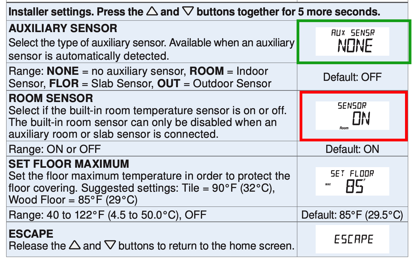

    More info request:
    is the floor sensor in the basement floor?
    Is the Tekmar 519 setup to measure floor temp sensor only?
    Is the green box set to FLOR
    Is the Red Box set to OFF

    I have a feeling that the Slab Sensor only setting may be working off of the Floor Max setting and not the floor temperature setting. It is a little cryptic in the manual but afteer you understand how the folks at Tekmar write their manuals, you ca nusually fond the clue to how the item works. It may be hidden in the text somewhere if you take the time to read each section about 6 times.
    SET FLOOR
    Set the floor minimum temperature. Available when an auxiliary floor sensor is connected and the built-in room sensor is on.
    This tells me that the  SET FLOOR does not do anything when the ROOM SENSOR is set to OFF.  See how that information is hidden in the wording of this one section?  It does not specifically say that anywhere, but it is in there by way of this one sentence.  That being the case, the FLOOR MAX is what the Tekmar 519 is looking at to operate the system.  So moving the 519 to the actual room it is controlling and setting the control to ROOM SENSOR to ON should solve your problem.
    That way you can set the minimum floor temperature to something lower like SET FLOOR. to 72° and let the room temperature dictate when the circulator pump will operate.
