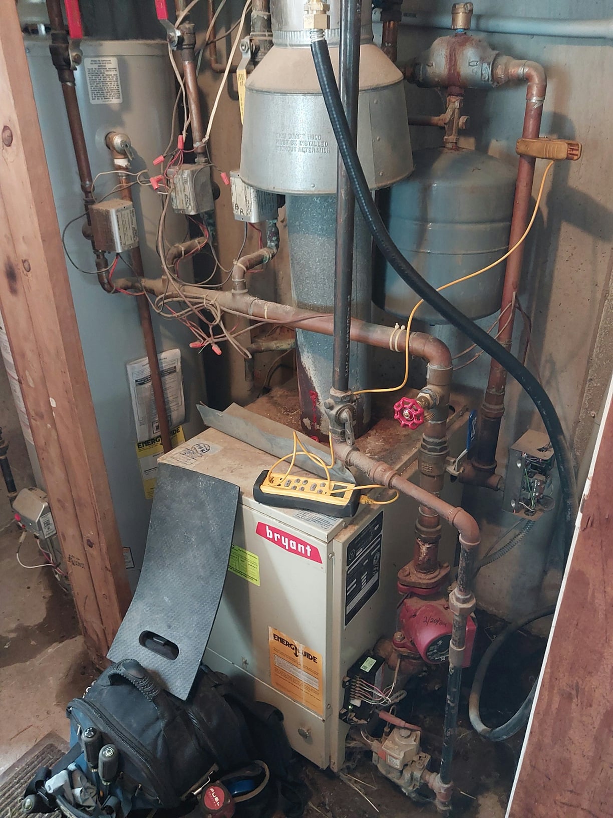

Hey just wanted your opinion on this system. Im here for an intermittent issue. Im getting 22 volts at the spark box but unit isn't firing. I reset unit and its been working fine since. But it has 3 zone valves. No external transformer, they're all powered by the aquastat. Could this be whats causing intermittent issues? I feel like 22 volts is a little less than usual. (My kneeling pad is covering company sticker in case that causes issues).

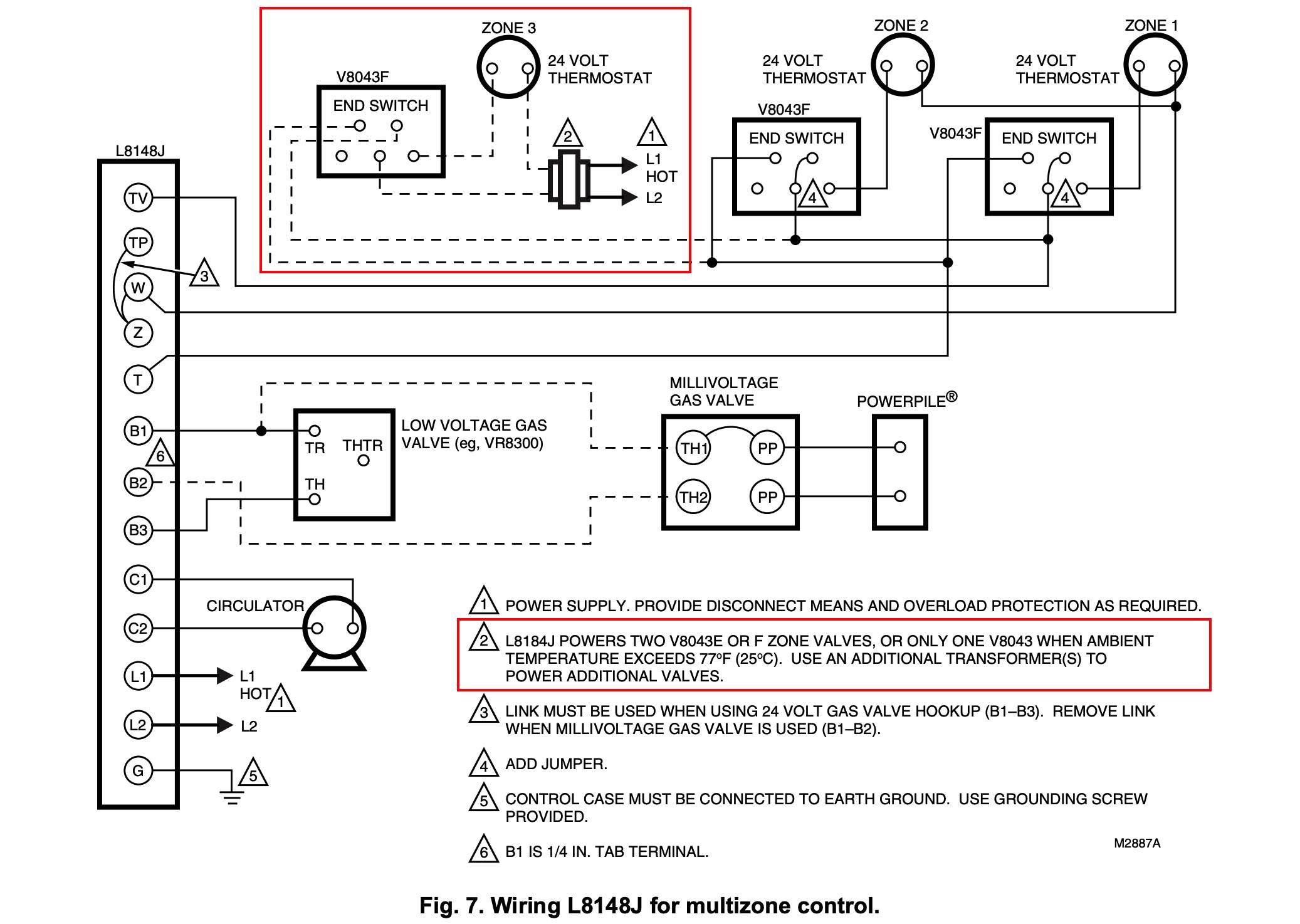

Some Aquastats are designed for operating zone valves. What is the part number of the Aquastat including the last 4 numbers?
If you happen to have the L8148 J 0000 which seems likely, there is a note in the instruction manual that states that you can connect 2 zone valves. Your system has three zone valves, therefore you may have a point with a low voltage problem.
But it appears that your system has operated before "as is" with 3 zone valves connected to the L8148J. So the question is "What has changed?"
You may have a defective ignition module (spark box). Try to operate the boiler with only one zone valve energized (the other two zones not calling for heat) and see if it works. The voltage to the spark box might increase to 24 or even 27 volts.

Thanks for the info. I dont know the model of the aquastat. I changed the ignition module last year. The boiler is from 1990 so he's going to replace it pretty soon. I wish I did what you suggested and had only one zone calling to check voltage again. Im already off site. Thanks again for the info!
22v should still fire that intermittent ignition module. One, or more of the end switches isnt making contact on those old Erie zone valves. When you go back, take a Pic of how its wired inside the L8148. It looks like there are 2 sets of wires between the zv and the relay? Does the circulator start and the burner circuit doesnt? Or both?
it also notes 1 zone valve if ambient is 77f or higher, which is likely under the cover of that control on a hot boiler
Those Eries would be similar to the HW they mention, about 5W each

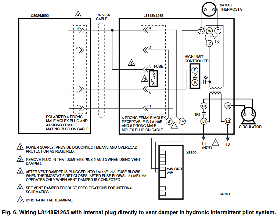

Assuming the 120 VAC is good, if the 24 VAC is at 22 VAC at the transformer, Z to TV the Aquastat's transformer is probably mildly overloaded. Also the solder joints for the relay 1K where it is soldered to the circuit board go bad causing intermittent problems and eventual failure.
