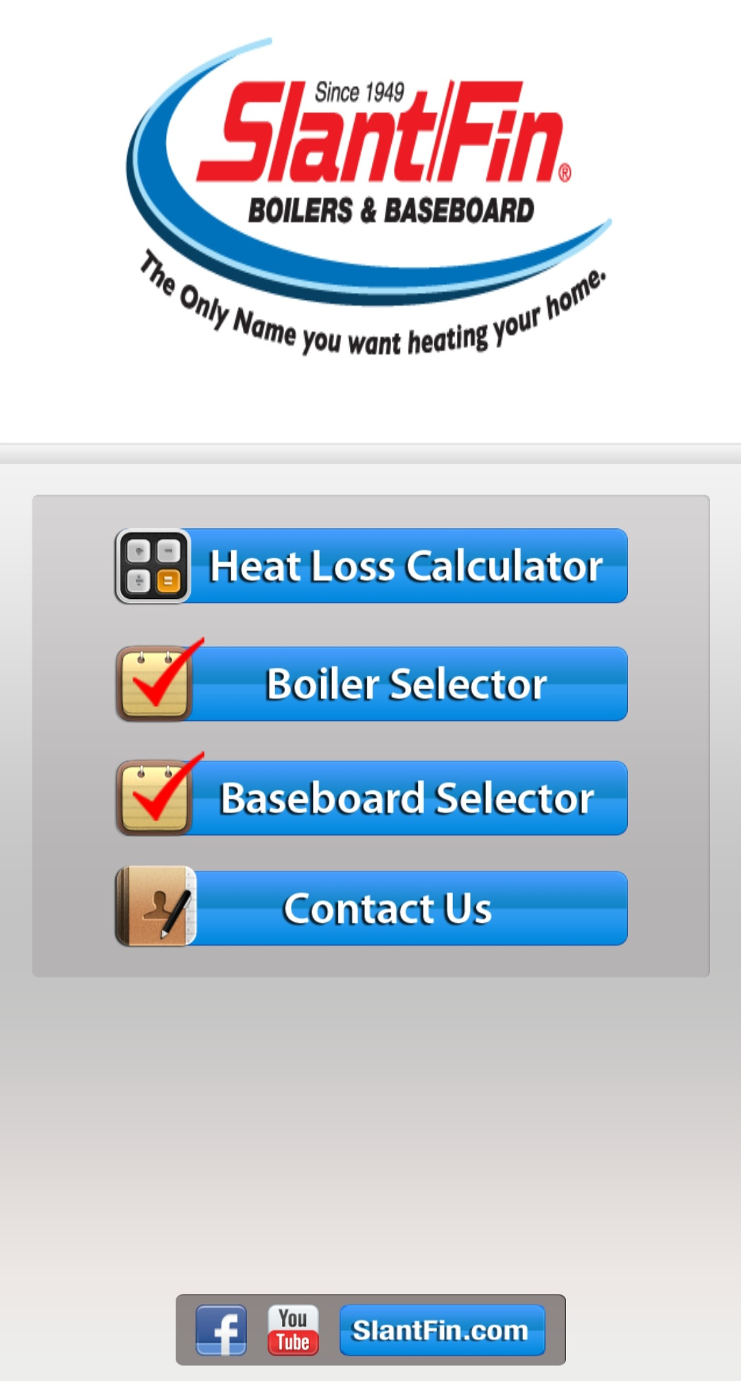

Somehow I recently misplaced my heat loss info that I used for sizing heat emitters for a room and rather than spending time looking for it I just went on line and searched for "heat loss calculator". The resulting list gave me some WILDLY different recommendations of what was needed. Some I didn't bother finishing because of all the fine technicalities they wanted and others gave me no way to make even ballpark inputs for things like wall insulation and windows. I mean really, "no insulation, mediocre insulation, very well insulated…" I couldn't even differentiate between 4" and 6" walls. One even told me I needed twenty some thousand BTU of radiation for one bedroom. If anyone can point me to a reliable free online calculator I would appreciate it. More than likely there will be others that will use it too. Meanwhile I have to go hunt for the SlantFin app I had years ago and see if it's still around.

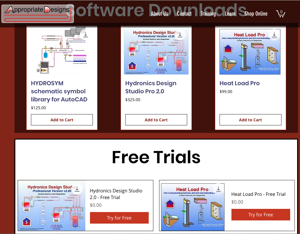

    I use Siggys HeatLoadPro. There is a free demo that may give you enough info? Simple to use, allows you to build various walls, etc. It is a very affordable program :)
    https://www.hydronicpros.com/shop-online

    Builditsolar.com has a free calculator that takes some getting used to, but is usually within 5% of the professional programs when the appropriate values have been entered. Slant/Fin was well known to pad their numbers by sometimes up to 25%, so be aware with this one that it's going to look low in comparison. I have used it many times and it hasn't let me down yet.

    I still have the Slant Finn CD. Had to get an external CD drive to use it on a newer computer. Haven't used it in a long time but I thought it was accurate enough. I don't feel it was oversized.

    what about charging $$for design help to pay for a program?
    Look at the package at hydronic pros with the heat load pro and HDS hydronic design suite.
    So much guess work is eliminated if you use the modules in the HDS pipe-sizing, pump sizing, expansion tank calculator, glycol correction, fin tube calculator, buffer sizing, etc
    Great for troubleshooting also.

    I still have the app on my phone.
    I haven't opened it probably since before Covid.
