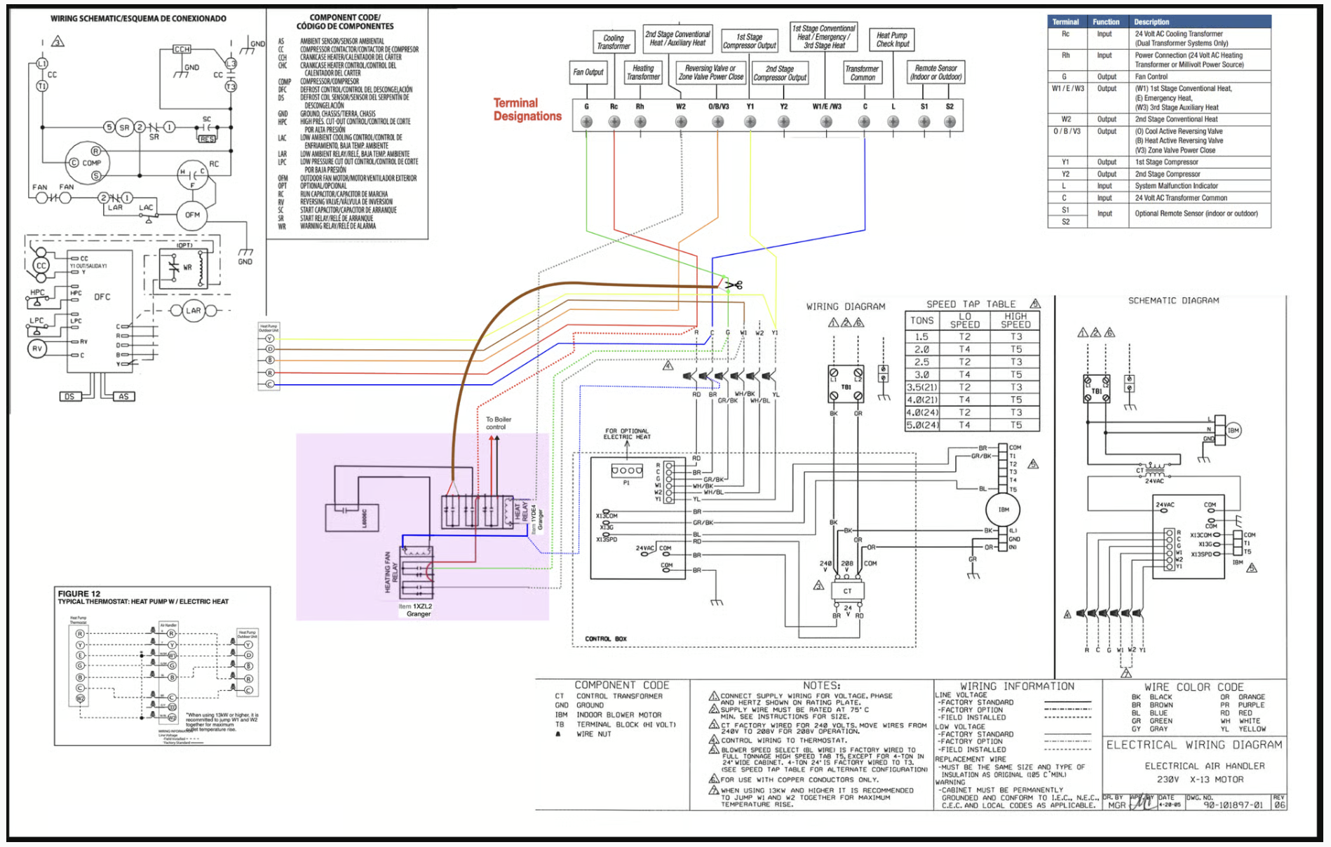

    Without knowing if the air handler is a variable speed ECM blower motor or a standard PSC two or three speed motor, I can’t give you the wiring diagram that you will need.  But If it is the PSC motor then the fix is easy. Just place a strap on aquastat on the hot water pipe that has the return water to the boiler from the air handler.   If the water in the air handler HydroCoil is cold the fan will not operate until the return water gets hot.  Once the water in the HydroCoil is hot the fan motor will operate.  I have done this many times to solve the “Blowing Cold Air” issue on HydroCoil equipped air handlers.
    If you have the ECM motor air handler then you will need a more complicated wiring schematic that I have in this post:
    The area in the Violet Highlighted area is the complicated fix needed to keep the fan from blowing cold air
    This is a heat pump system. You are only using the AHU for cooling only and HydroCoil heating only. The diagram is the same in either case, just the thermostat will not operate the compressor and reversing valve for part of the heating season.
    Once I know the AHU specifications I can get you a custom diagram for your son's system.

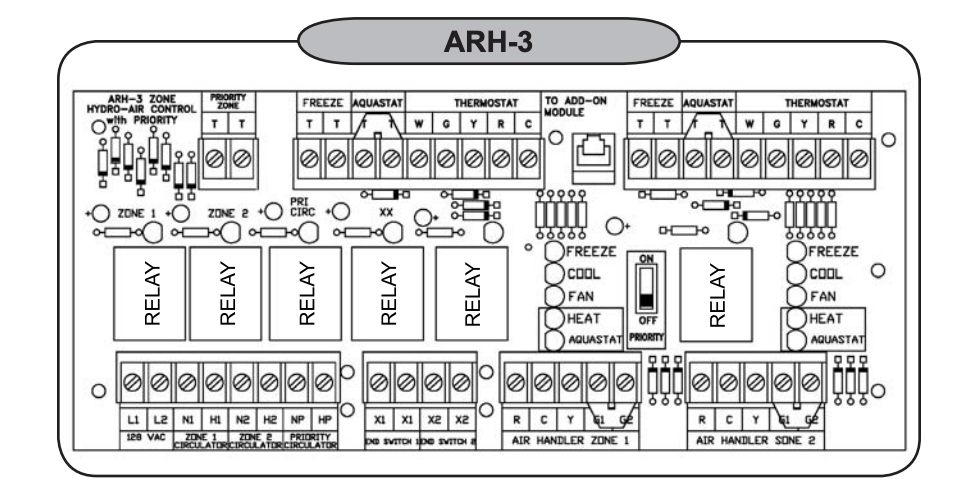

    Since I retired in 2018 and stopped actual installation work a year earlier I was not aware of the Argo AHR-3. (Looks like it has been around a few years now.)  It appears that it has everything you need to solve the blowing cold air problem with 2 HydroCoil air handlers and one indirect water heater.  It may work on ECM motor air handlers but I have no definitive proof of that. That will depend on how your ECM air handler handles a call for blower on from the thermostat if there is no call for cooling.  Sometimes that blower speed is too slow for effective heating.  Other times they can be set for higher air flow on a call for “blower on” only.
    There is a place to wire each thermostat from the AHU space heat zone that includes heating and cooling.  There is a place to connect the AHU wires.  There is a place to connect the aquastat that keeps the blower from blowing cold air.  There is even a place to add a freeze protection thermostat if you have an attic air handler unit that might be subject to freezing if there is no call for heat for an extended time, and there are end switches to operate the boiler
    The third zone for the DHW priority will stop circulators for zone 1 and 2 from operating during a call for DHW.  If you are using zone valves with one circulator for space heat zones then you need a work around to operate the 24 VAC zone valve motors that can open and send the signal to operate the boiler via the zone valve end switch.
