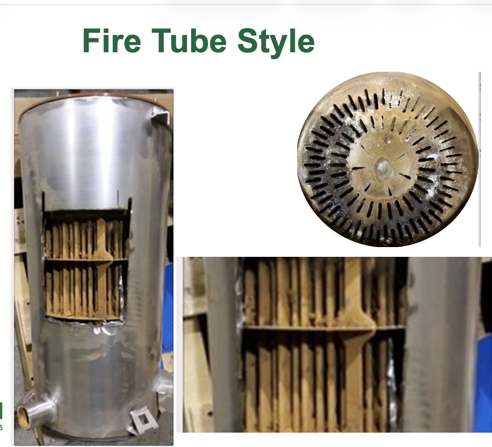

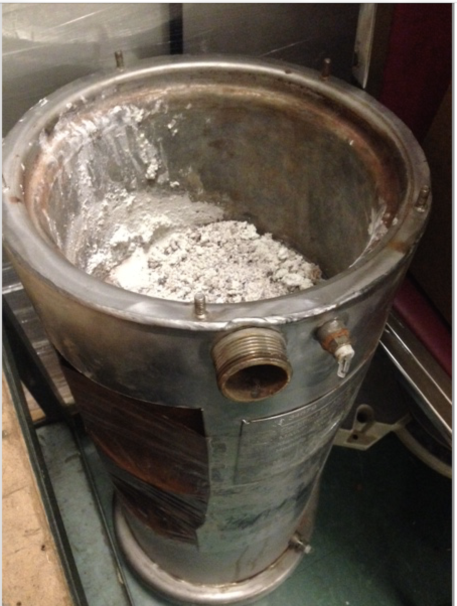

    hot_rod Posts: 28,708
    I'll bet you can find You Tube vids on how to clean a TT boiler. An example video from Jake at Simple Hydronics in Bozeman
    As @tim smith mentioned the top needs to be removed to check and clean. Example of a poorly neglected boiler below, and example of how the water side fails.
    Conditions like this are not the boilers fault, or design issues. It's lack of proper maintenance and water quality control.

    Every 1-2 yrs the combustion chamber needs vaccuming out, the tubes need good flush, we also found that we needed to clear the tubes as best we could of the (coffee ground like) build up in the tubes. It stacks up in the tube and finally becomes compacted to such a point that tubes will be fully blocked. Its amazing how many tubes can be blocked and these units will still run. But reality is your stack temp is going higher due to less airflow through heat x. back pressure building up and will finally blow out gaskets. The cleaners on the marked dont really break to the crystalized deposits enough to flush them out. We would use flat silfos brazing rods and on the 1st gen Triangle ps boilers we could get the rods all the way down to verify clear. Then the factory changed dimpling pattern on tubes offsetting every other dimple where as original were right down the middle ever 4-6 " appx. So when punching them out on early models could go down either side of the dimple. Later versions we could only get down maybe 10 - 12". The build up is what we found to be the boilers demise more often than other items. Build up would also retain condensate, making a corrosive build up where this occured. Just my .03 worth.
