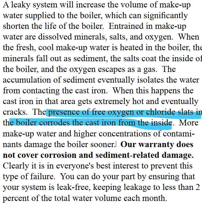

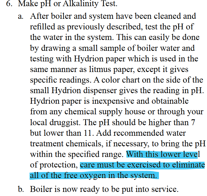

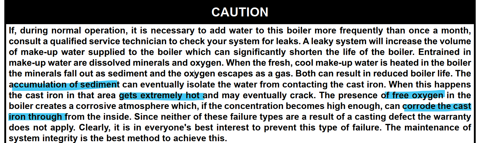

the operational manual highlights the risk of failure to be contaminants in make up water
  1. dissolved minerals and salts
  2. free oxygen
minerals leech out and accumulate as sediment, coating inside of boiler sections, risking overheating and cracking. oxygen and salt corrode the iron through from inside.
with these concerns in mind, why not add water filters such as Catalytic Carbon Filters before the feeder, to remove some oxygen and minerals?

    the manual mentioned oxygen and scale/lime buildup multiple times. the warnings are given upfront, and in the system cleaning section, and at the end of the servicing section.

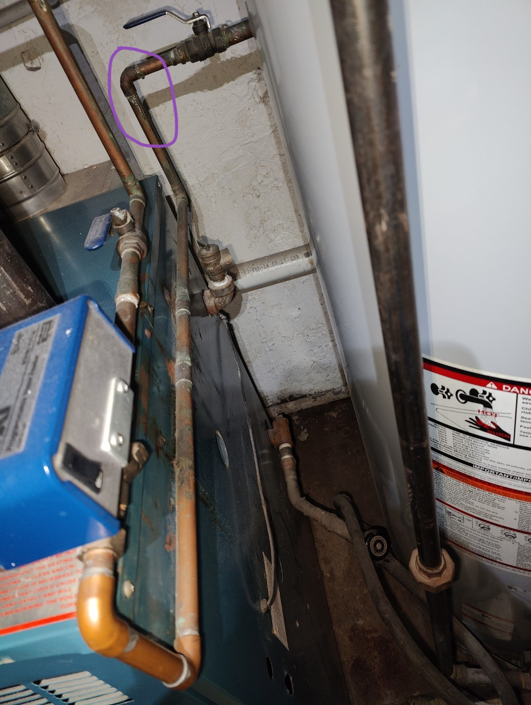

    In the picture circled above appears to show a soldered joint that simply needs to be cleaned.

    how to clean the soldered joints?
