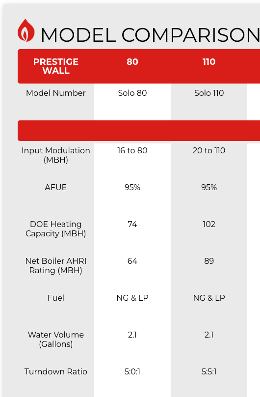

  • Thanks guys for the suggestions. I called Webb and they said they don't have any PS60's, Another question if I were to get a bigger boiler like maybe a PS110, what would I have to do to my system to make it work properly. I have already done a heat loss when I installed my PS60. Would it short cycle beacuse a bigger boiler? What boilers use a fire-tube HX so if I have to change brands?
    hot_rod Posts: 28,699
    TT boilers are mostly 5.5-1 turndown, what is your smallest load. Ideally the boiler turns down close to the lowest load. But any modulation helps with cycling. The PS 60 was also 16K on its lowest turndown.

    I'm pretty sure a 110MBTU model TT boiler would be fine.
    Many of the mod con boilers allow you to limit and lock the boiler to a lower output. If your heat load is say 40K, lock the boiler to around that. That helps eliminate the cycling.
    Additionally some boilers have step firing where you limit the firing by steps and time. Keep it at 10% for 10 minutes, 20% for 10 minutes, etc. That fine tunes it even more.
