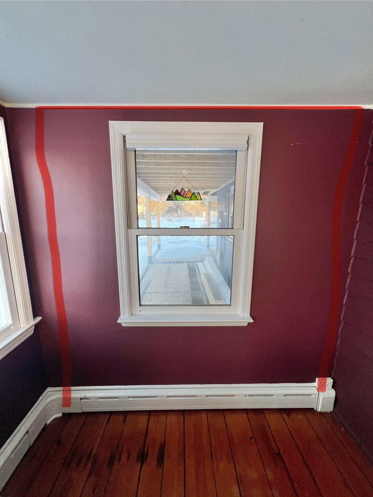

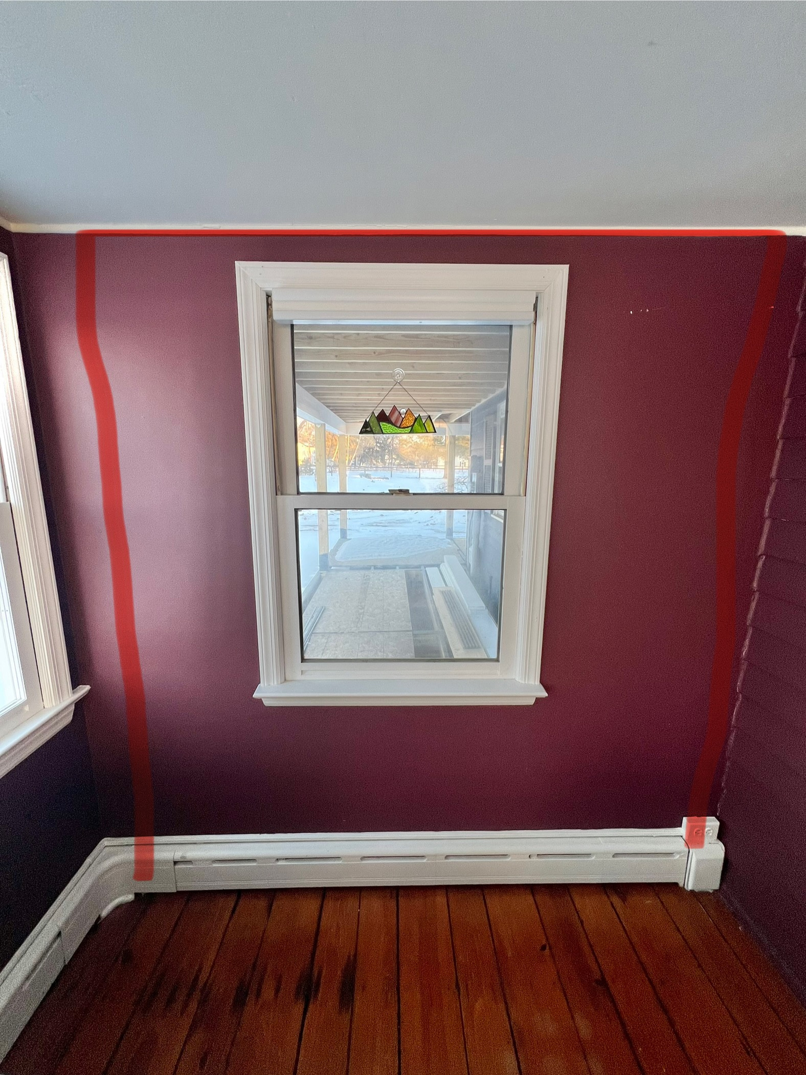

Hey fellas. I’m looking to install some French doors out onto a new wrap around porch I built, but i currently have cast iron baseboards running all the way around the current enclosed portion of the porch. What would be the best way to route this section of the piping? Am I thinking along the right lines by going up over and back down again? Any feedback would be appreciated.
    edited February 7
    do you have access underneath? usually that is easier. if you go above there will need to be space between the header and top plate to run the pipe and depending on the height of the door and the size of the header needed frequently there isn't space between the 2. i would also either spray foam the cavity up to the pipe or fill it with rigid foam if that is an exterior wall.
    if you run it in to the attic because you don't have space in the wall above the header then protecting it from freezing especially where it gets from the top plate in to the attic will be difficult.
  • Access underneath is very limited, less then a foot from the ground. I thought about installing the new door then packing out a false wall to the inside just thick enough to run the piping, this way I don’t mess with the header for the door and don’t have to go into the ceiling. I would loose a little room inside the enclosed porch though.
    edited February 7
    furring it out would solve many problems. just make sure you plan your door trim for it, probably just wider extension jambs. i would also take caulk or foam in a can and seal up the wall surface of the existing wall to the floor and the new door and anything else that has a gap before closing up the furred out wall so there are no drafts in to the cavity to freeze the piping.
  • I hadn’t thought about potential drafts with the false wall, good idea with the caulk. Only other issue is I’m eliminating nearly 1/3 of the baseboard in that room and it’s always freezing cold in there as it is.
