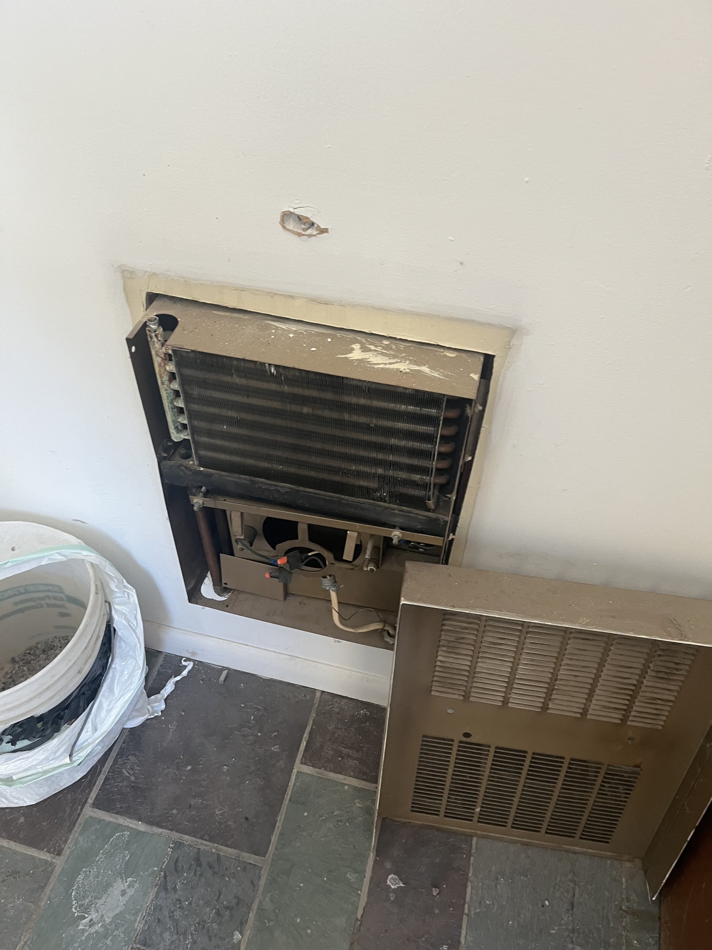

Any of you guys ever run into these old units. I am getting ready to retrofit the boiler system in an apt complex that has these in, I can't find any BTUH cap data on them. Any chance anyone here would have that info? They look very similar to the Burham DUO RAD
Do a heat loss calculation
Looks like they are nominally 10K BTU rated, but the info is from an ad that doesn't provide temperature deltas, flow rates, etc.
https://www.usmodernist.org/AB/AB-1955-07.pdf page 136
Given that the label you show say that PEBCO is a division of Burnham, and that the unit looks very very similar to the Burnham B50 units (from Lancaster, PA even) shown in on page 89, I would bet a couple of beers that they are the same.
1 -
I'd bet @winnie is right on the money. It's hard to say what temp and delta they are basing the ratings on but often you will see it based on a 180 with a 20 delta at 68 entering air temp *this is an assumption*. That being said if you are trying to add up all these units to get the boiler size that's not the right way to size a forced water boiler system. Size the boiler for the load not the emitters
