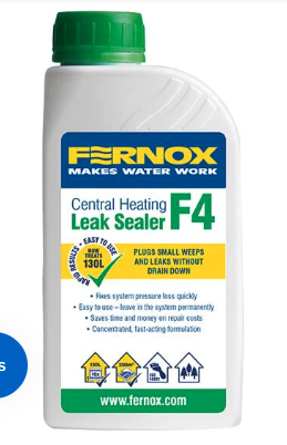

    hot_rod Posts: 28,704
    If you do determine it has a small leak, in the tube you could try a hydronic leak sealent. It could buy you some time, maybe years if it is only one small leak.
    A plan B as someday the system could develop more unsealable leaks, would be a good idea.
