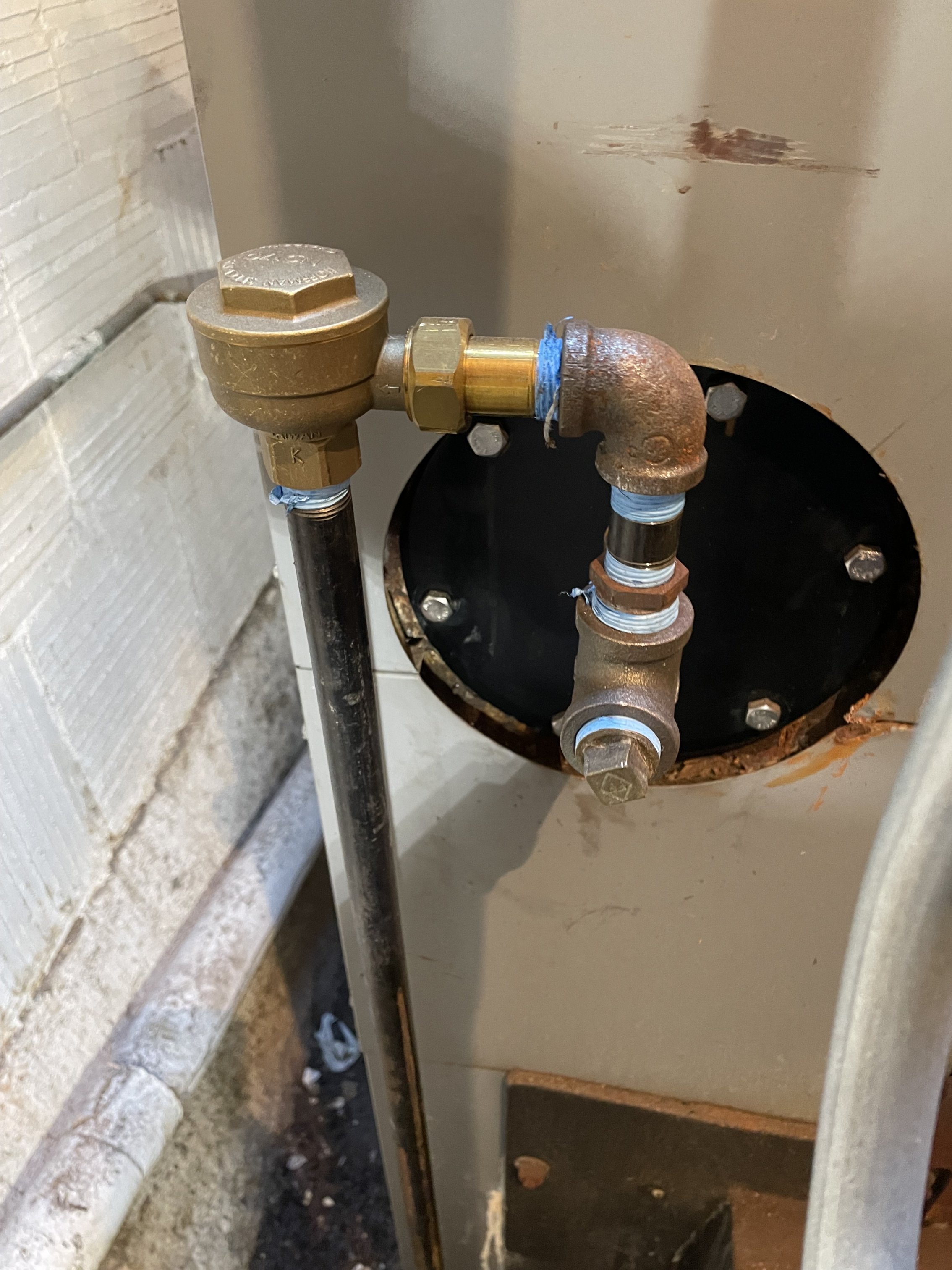

Steam trap on boiler above water line
Has anyone seen this before? 1/2” Steam trap only slightly above water line tapped into a control plate. I assume the original installer was concerned about the boiler / system flooding? Peerless Lc-4.
This is a 12 unit apartment building in San Francisco. Of course the trap is slightly passing steam.

    Well that is different. Probably doomed to always lose some water. I wonder if there is a flooding issue that can't be resolved if a water trap would loose less water over time.

    it does nothing. steam can't get down that pipe anyhow because of the water seal, unless there is a big differential between the main and return and the equalizer is supposed to take care of that.
    oh, i see now, it is open, not connected to a return. it is probably a hack because the water is leaving the boiler and the auto feeder is overfilling the boiler during a cycle. it will kill the boiler if it is constantly dumping water.

    A set-up similar to this has been done on systems with multiple boilers that insures that a down or shut down boiler will not flood. The down boiler or boilers will slowly fill due to steam above the water line condensing. A steam trap or a "liquid drainer" as it is called is installed slightly above the normal water line and the drain pipe is routed back to a condensate receiver or condensate tank so as to not loose the water. This way when that down boiler fires it's water level is close to normal.

    A dump trap used to keep the boiler from flooding but it should go to a boiler feed tank or condensate pump. But it seems that doesn't exist
    If it is dumping water and adding MU water the boiler is doomed.

  • Yeah. I think your right it's definitely some type of hack to compensate for something. Boiler is piped correctly I can imagine the boiler not being skimmed off properly and was surging causing the boiler to flood. Either way trap was removed. no flooding issues i'm aware of going forward.
