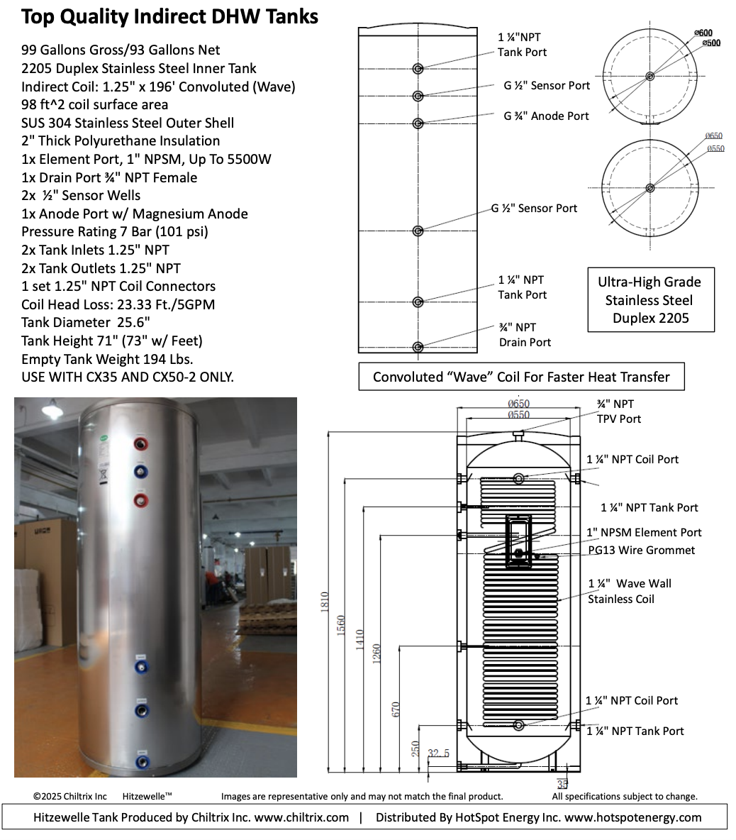

I have seen more and more companies drop the double wall, though ASME appears to still require them. I am especially interested in those that work would as a hot water loop off a standard low pressure steam boiler. I see Laars has some, but the coils are carbon steel…so probably more prone to corrosion. It would be nice to have stainless steel coils. The Triangle tube units will tend to collect sludge at the bottom, with no way to drain it.

Chiltrix has some stainless versions. Turbomax for copper coil type.
I would not suggest a steel coil inside a steel coil. They tend to condense and corrode away between the layers.
