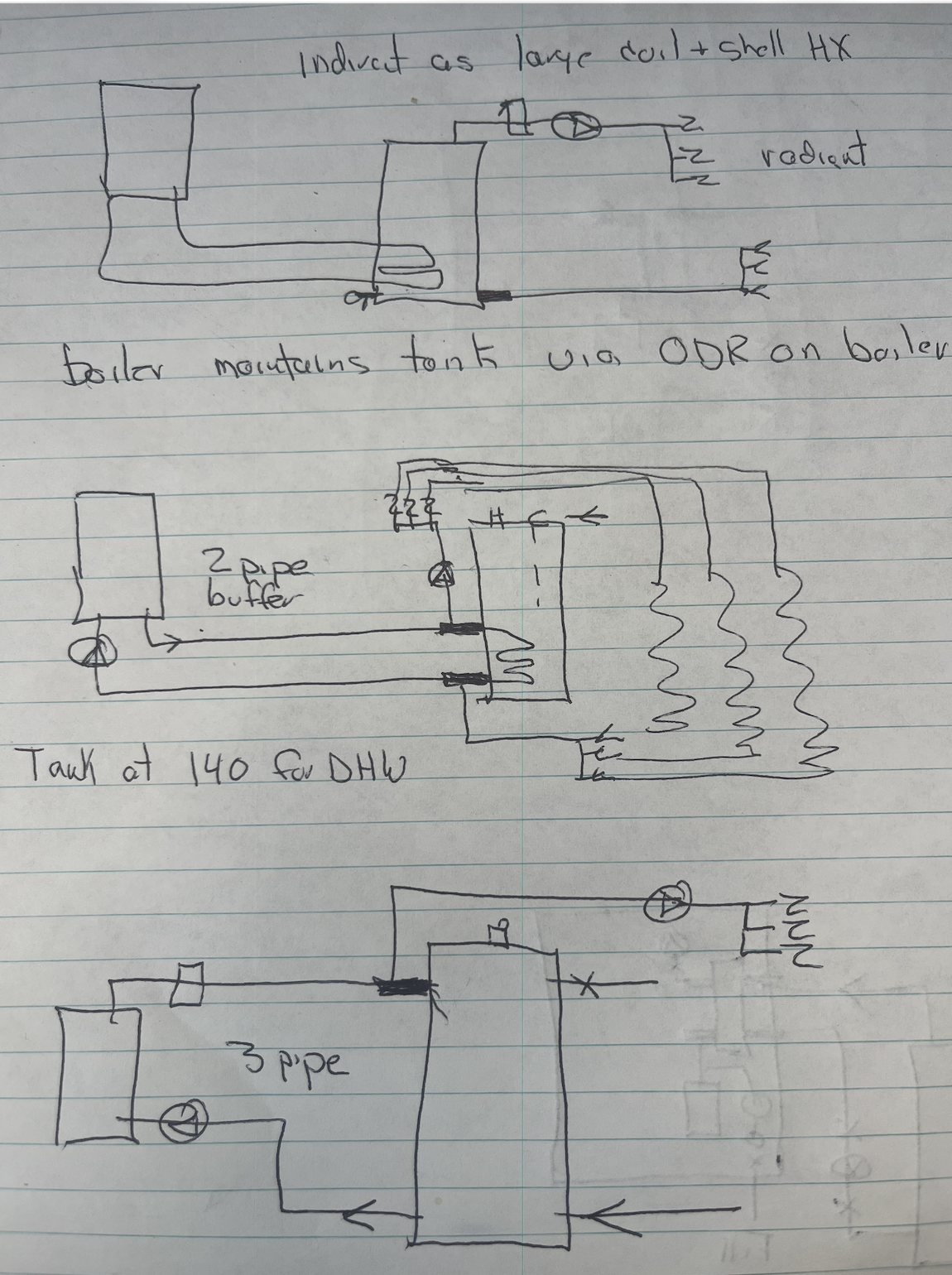

So to try and resolve problems 1 & 2 I just picked up a used 50 gallon stainless indirect water heater, with the intention of using it as a buffer tank. All 4 connections are 1 inch and it has a 3/4 in t&p high up on the side of the tank. Hot water out is on the top.
My plan is to do a major reconfiguration of the system. Install the water heater as a buffer tank and replace all the circ pumps feeding the zones with a single auto adjusting Alpha 15-58f ECM pump with zone valves on each zone. My intention here is to tightly control the temperature of the tank and have the temperature as low as possible. I am hoping the water temperature in the pex could be much more stable hence less noise.
If you have any thoughts on this please point them out.
So on to specifics about connecting the water heater as a buffer. Given the connections to the tank I can either connect it as a 2 pipe or as an upside down 3 pipe buffer. So as 3 pipe what I'm thinking is the system return and boiler in teed together as close as possible at the bottom port. System supply comes out of the top of the tank, and boiler out is connected to the 3/4 in t&p port. I know this will cause some mixing in the tank but maybe that a good in that I want to tightly control the temp to the zones to avoid large swings. The coil ports will be left open as they are not needed.
Does this sound like a good plan?
Do you have any suggestions?
For the control end of things I have installed an outside thermistor for the boiler. Not that I think I get any benefit from it in the current configuration but I do have a Bosch FW200 that I could install and believe I could use it to maintain the buffer tank at a variable temp based upon the outside temp. I am not sure if it would tightly control it the way I would like it to be though
Any thoughts here? I do have a bit of a controls background (not in the HVAC world) so I could build my on system but maybe using off the shelf components (aquastats ect) would be best when I cannot be the one fixing things in the future.
Again please any suggestions.

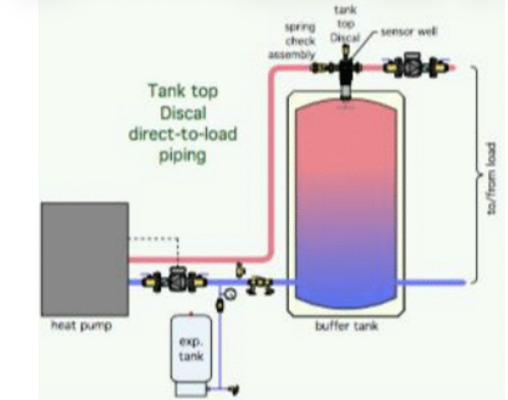

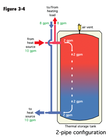

    To best use the tank you might connect the radiant to the tank itself, the 50 gallons. Then heat the tank with the boiler. You would not have a DHW function from the tank however.
    A reverse indirect works well, as the entire tank top to bottom has coils.

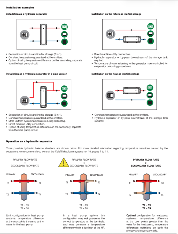

    Caleffi has buffer tanks in the European market, this is a drawing they use showing various piping options.

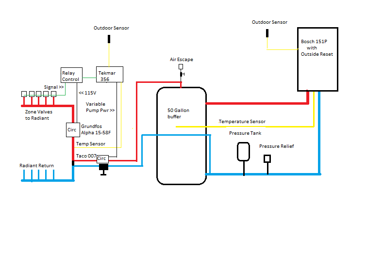

  • Hi hot_rod

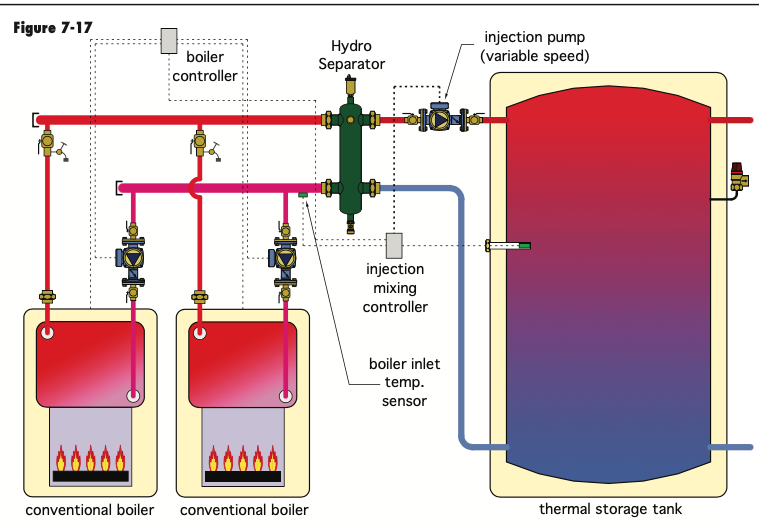

    The attached image is what I came up with using variable speed injection. For simplicity I have left off a lot of shutoff valves ect. At this point I am totally ignoring the fact that I have an unused coil which I may in the future us to my benefit for DHW.
    Do you see anything in my plan that stands out as a bad idea?
    The Tekmar design essay e021 said I need closely spaced tees on both ends of the injection circuit. I did not think that was needed on my tank side of the circuit, but I do show the 1/2In Dia ( size from their design doc) injection pipes dropping down for a heat trap. Any thoughts about that?
    The components I chose are pretty much the first ones I came across that seemed reasonably priced. If you think there are better choices that I should be looking for please let me know.
    Again thanks for all your help.

    I suppose the cold water to the DHW side of the combi could run through the coils and pick up some heat.
    I would connect that the supply from the tank off the side port like you have the return. It is probably a 1'"?
    The piping at the tank is the hydraulic separation function. You have more of a 2 pipe method.
    The 3 pipe concept is more about the return piping. It brings the coldest water back to the HP or boiler and also engages some of the the tank without top to bottom mixing.
    We have done injection mixing from boiler loops to a tank, or tank to load without close tees at both ends.
    7-17 runs the tank temperature and offers boiler return temperature protection.

  • Hi hot_rod,
    That side port up high is 3/4inch it was for the T&p. Does that change your opinion that I should connect the feed to the injection pump there as well as the hot water from the boiler? I kind of feel the 3/4port with 1inch pipe coming to it from the boiler probably does not really function well as a sort of closely spaced tee configuration.
    I do wonder if it makes sense for me to be running 1in from the boiler to the buffer tank and back considering the injection circuit will be only plumbed with 1/2inch. Do you think 3/4 would be adequate? That would save quite a bit of money but might look wrong.
    I realize I cannot do a proper 3 pipe as my ports don't allow it

    The size of the injection loop depends a bit on the temperature of the tank. The hotter the tank, the less flow it needs, the smaller the pipe.
    So if you know the required temperature for the radiant and what the tank will be, you see the pipe size. I suspect 3/4 would be plenty.
    If your tank has two 1" connections up top, one must be the cold with a dip tube? The coil connections are on the side?
    Or is it a HeatFlo, they have all 4 connections on the top, coil and tank?
    You already have ODR built into the boiler. It may be simplest to just let the tank temperature be controlled by the boiler. It limits the tanks "buffer" capacity a bit, but much less $$ and simple piping.
    You are basically building a 50 gallon boiler.
    Maybe a pic or link to the tank info would help see the best option. Is the Greenstar a combi, or how do you make DHW?
    Your 3 goals that a buffer will help with
    1-reduce cycling
    2-reduce pex expansion noise, the ODR will handle that with near constant circulation.
    3-As long as the main room has enought tube it should heat. Getting the high temperature setting on the ODR should cover that.

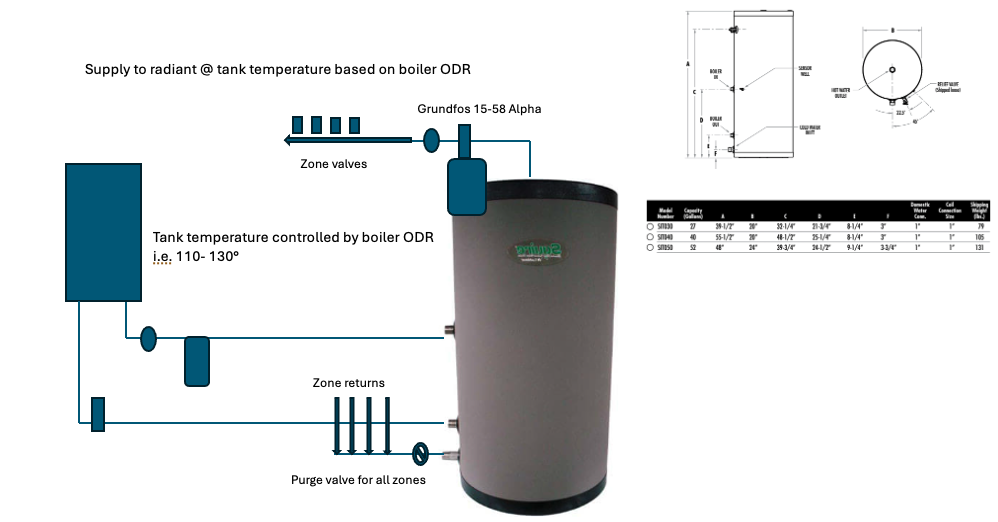

    This uses the buffer as a heat exchanger/ buffer. It's temperature varies based on the boilers ODR
    It does require two air purgers, expansion tanks and fill valves.
    You want to add heat emitters to that great room so all zones can heat adequately with the same supply temperature.
    Boiler supply to the bottom coil connection, radiant return to bottom tank conection for counterflow direction.

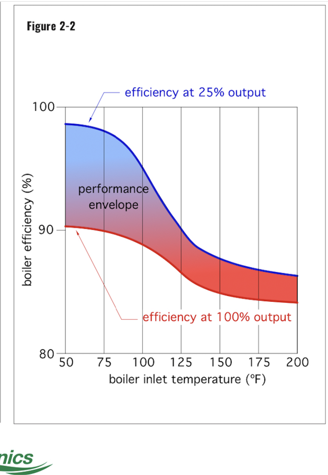

    This graph shows how efficiency changes as you run the boiler hotter.
    Notice a couple things, as the return drops below 130 the curve goes up quickly. 130 and below return is about where you start condensing.
    Also as the boiler modulates down its firing rate efficiency goes up also.
    That is why you want to use the boiler ODR and I would also limit the firing rate to that 40- 50,000 btu/hr rate. If that is the heat loss number?
    Using the upper blue curve there will be many days where you run below design temperature. If you get to a point where the boiler has modulated down to it's lowest firing rate, maybe ODR targets 100 or so, now you are running mid 90% efficiency.
    If you lock the boiler at a higher SWT to make injection mixing numbers work, you are sliding down the efficiency curve.
    These point gets overlooked a lot with mod cons. The lower the SWT, more importantly the RWT, the more efficient. The lower the firing rate the more efficient.
    Even IF the boiler was running 200°F, lowering the firing rate gets you a few % better efficiency. The blue curve vs the red curve.
