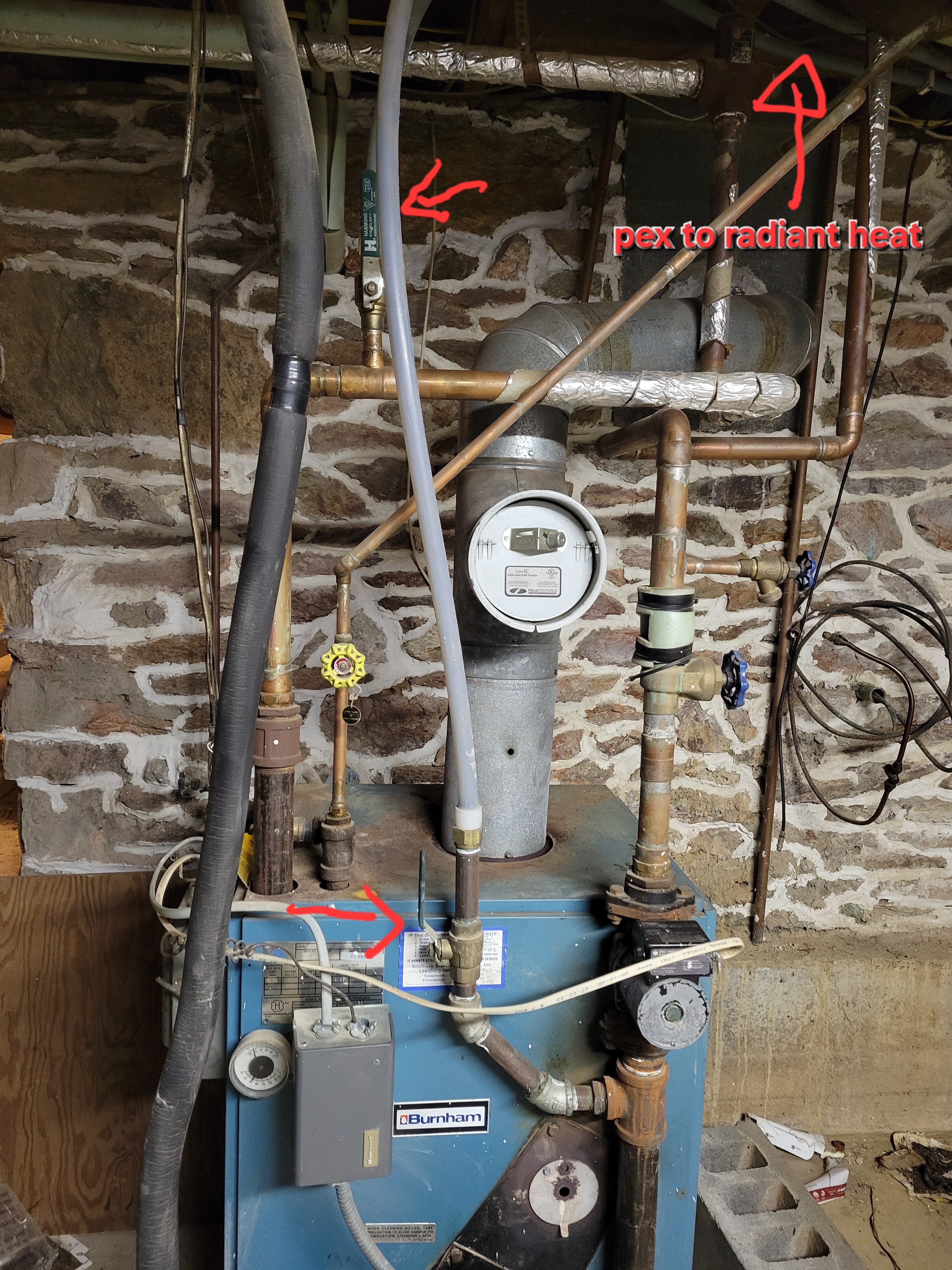

for my lack of knowledge here, but I rent a very old house with an oil boiler in one basement and in another basement is the mixing controls for radiant heating for a small portion of the house. It's never really worked, because we never really fooled with it.
Real question here is that it appears that the intake and output valves at the boiler are closed. Im always a bit hesitant to just open valves. My question is for the radiant heating would opening those valves likely solve the radiant heat issue. Both valves noted in picture attached to the pex tubing that is run through the house to the radiant heat. Attached pics of
boiler and mixing setup.
    mattmia2 Member Posts: 17,563
    the valves connected to the pex appear to be open in the picture, the valve is usually open when the handle is in line with the pipe.

    beardo99 Member Posts: 3
    Thanks you are correct. Tooscatterbrained today with my head looking at the horizontal pipe on the mixing valve and forgetting inline vs perpendicular. Problem must be elsewhere
    the heat motors in those zone valves can burn out, the circulator can stick, the thermostatic mixing valve can stick, the system could be air bound somewhere.

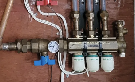

    hot_rod Member Posts: 27,904
    Turn off the blue handle and you can purge thru the hose valve at the end of this manifold.
    Either call all the zones on, or remove the actuators to open the manifold branches.
    make sure the fill valve is on and working to purge.

    bburd Member Posts: 1,319
    edited January 29
    It looks like one end of the pex to the radiant part of the system connects to the main boiler return pipe after the circulator, which if the circulator is pumping into the boiler will force cool return water back up into the radiant system.
    I don't see how that ever worked correctly.
