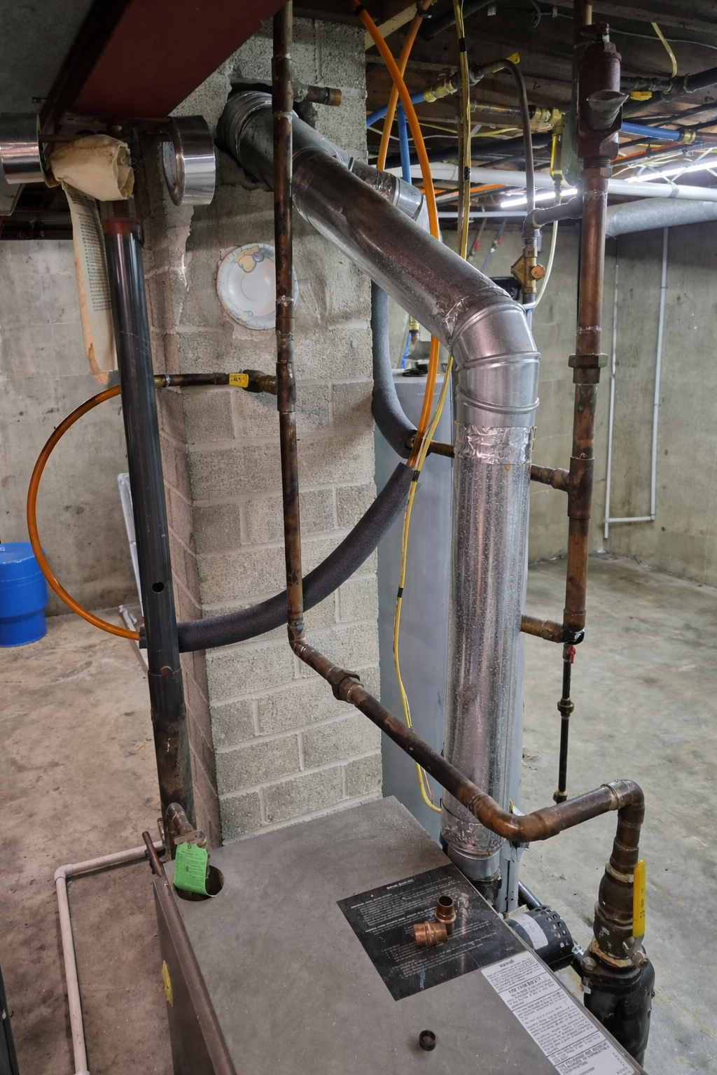

    It is currently 1 zone. There is a ball valve above the boiler that runs to underfloor heat between the joist in 1 bedroom. The rest of the house is ran in series to all the baseboard radiators. The 2nd ball valve is behind the exhaust vent.

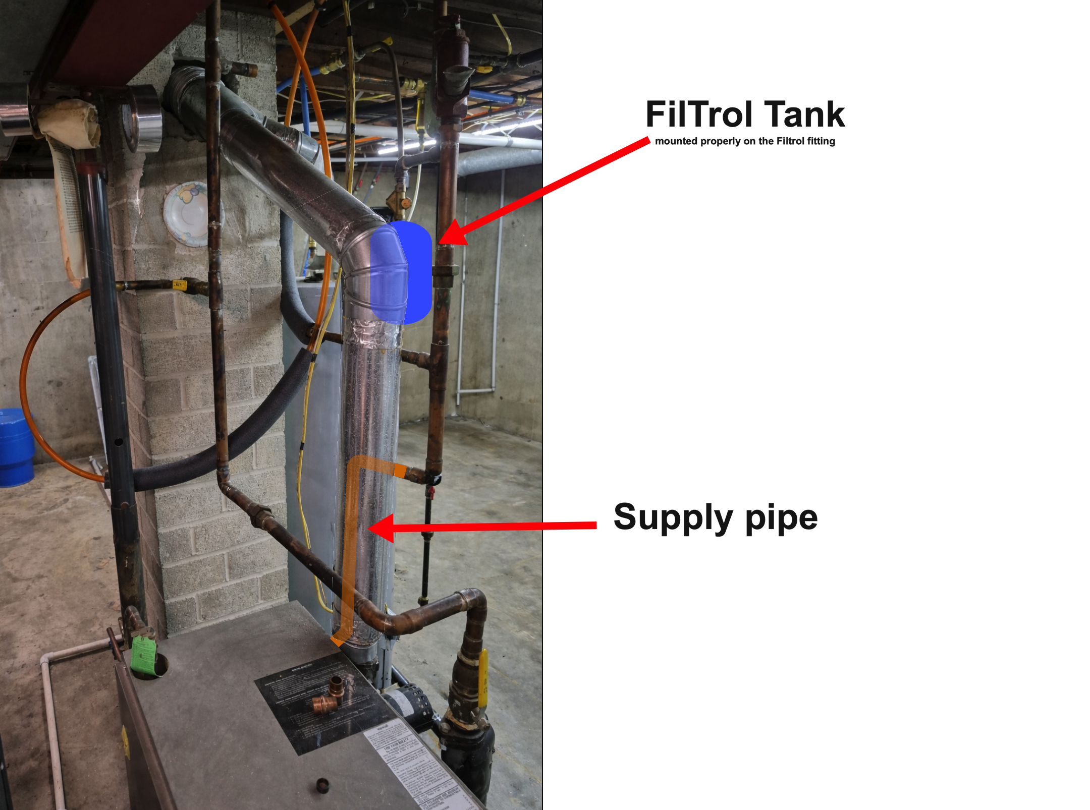

    I see a Filtrol® valve with no Filtrol® tank, and what appears to be a loop of some type of heat added at some point after the original system was installed using orange PEX with about 3 feet of foam pipe insulation  on the tee near the supply and the tee near the return.  I do not see an expansion tank in the photograph. It might be hidden behind the vent connector pipe (smoke pipe) This near boiler piping needs an upgrade and this additional garage zone is the time to do it.
    If the Filtrol expansion tank was still operating properly, the vent connector would not be covering the expansion tank completely. (the blue tank is where it would be)
    There is also a Taco Air Scoop hidden behind the B&G Flow Control Valve. No need for the "B&G Flow control valve" if it is only one zone. This system has been worked on by several people over the years. Time to make it right!

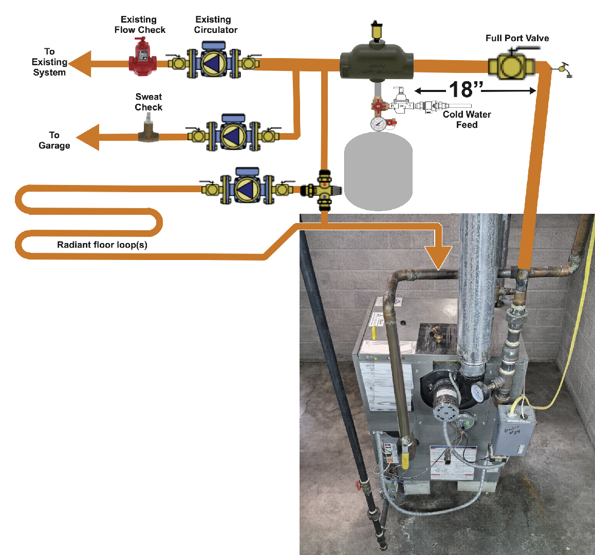

    Here is an idea of what I might do in your situation:
    This uses a separate circulator pump for the garage zone. I also added a mixing valve for the radiant floor zone which requires a separate circulator pump to work the mixing valve. I can't see that putting 160°+ water temperature in the radiant floor loop as a good thing for the floor covering or your bare feet

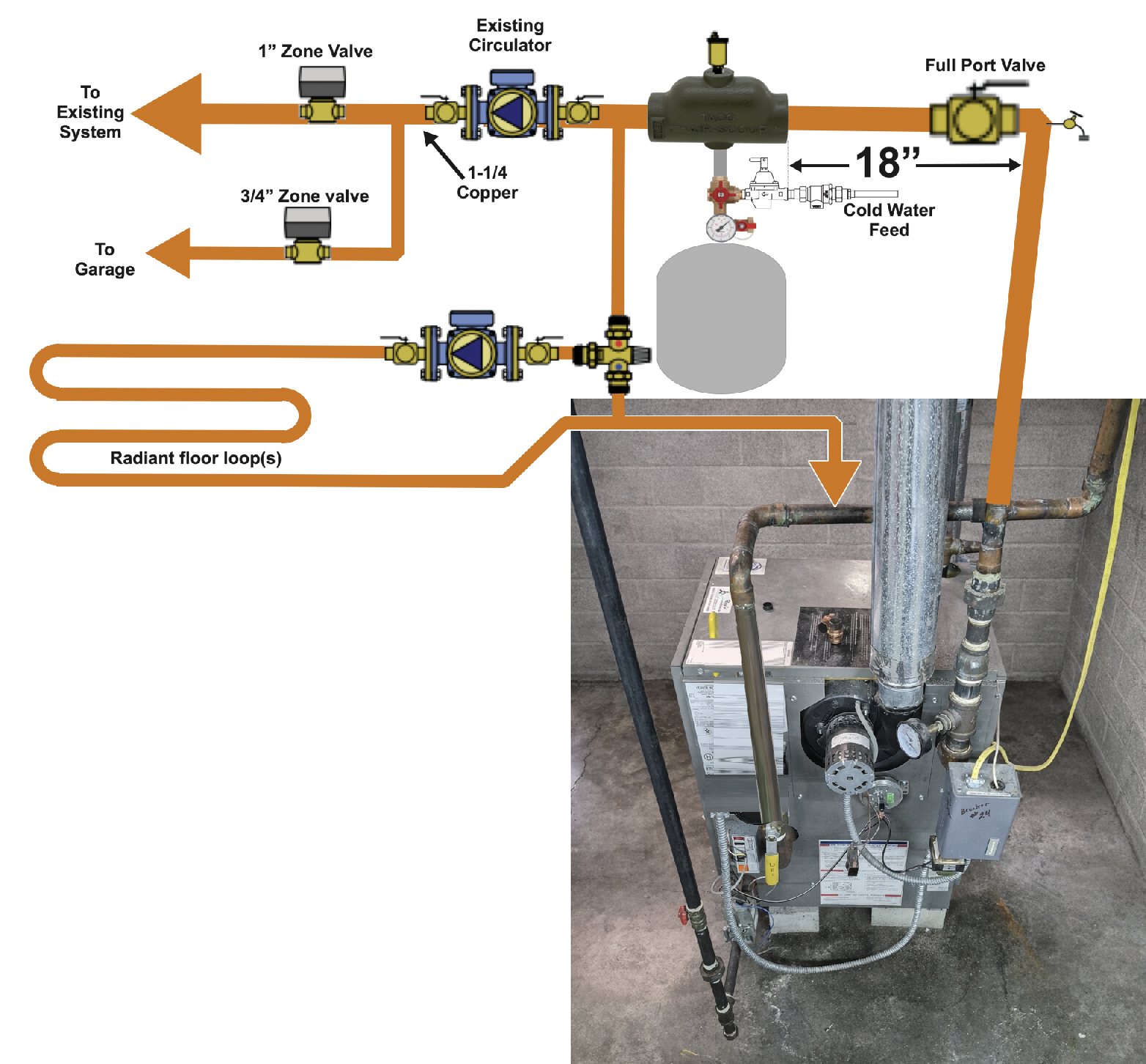

    Another idea if the existing pump can handle it:
    This uses zone valves and the existing pump. No need for flo-check since each zone valve uses the same circulator. You will need to verify flow rates to see if the existing pump can handle the extra load.
