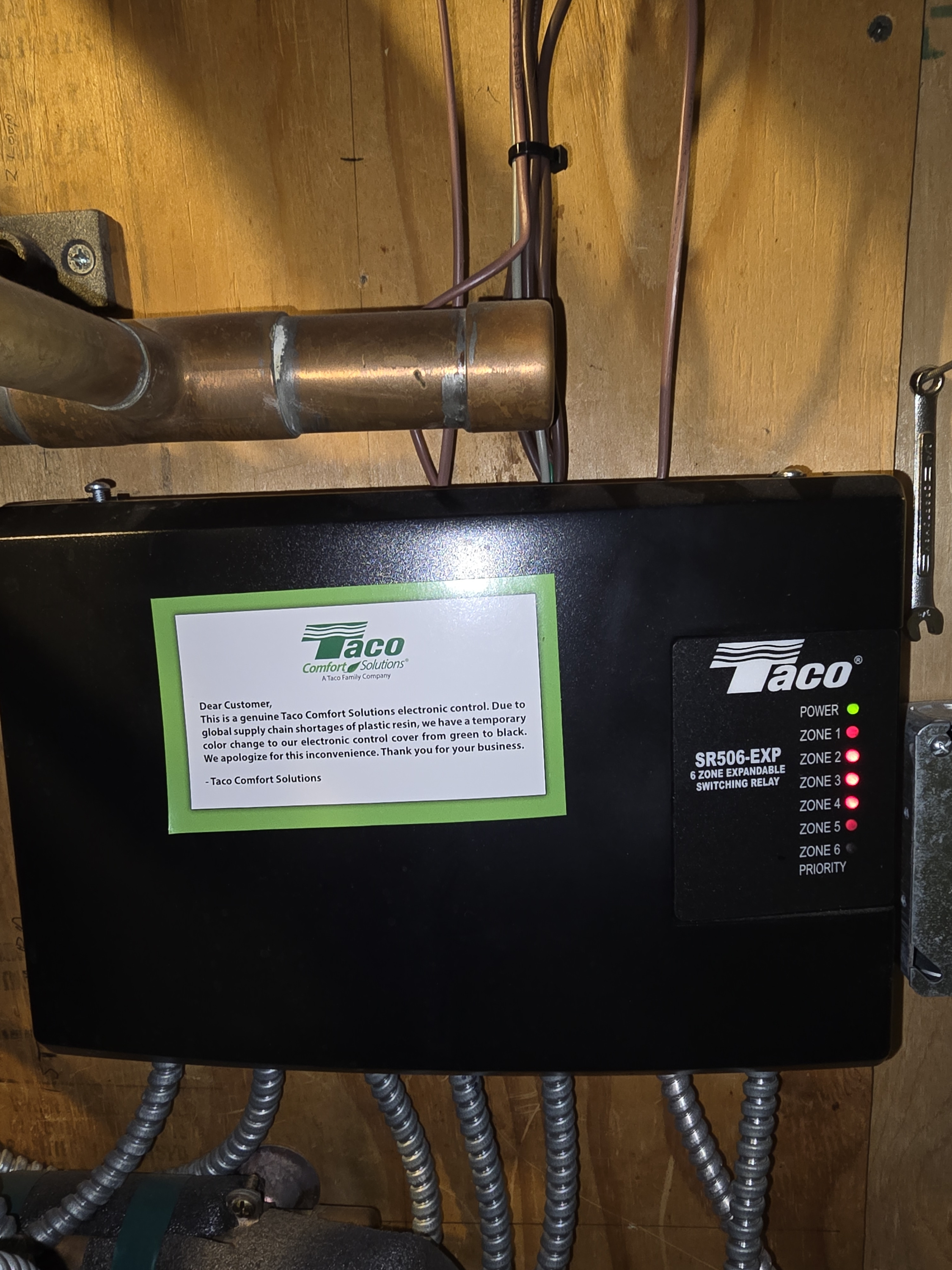

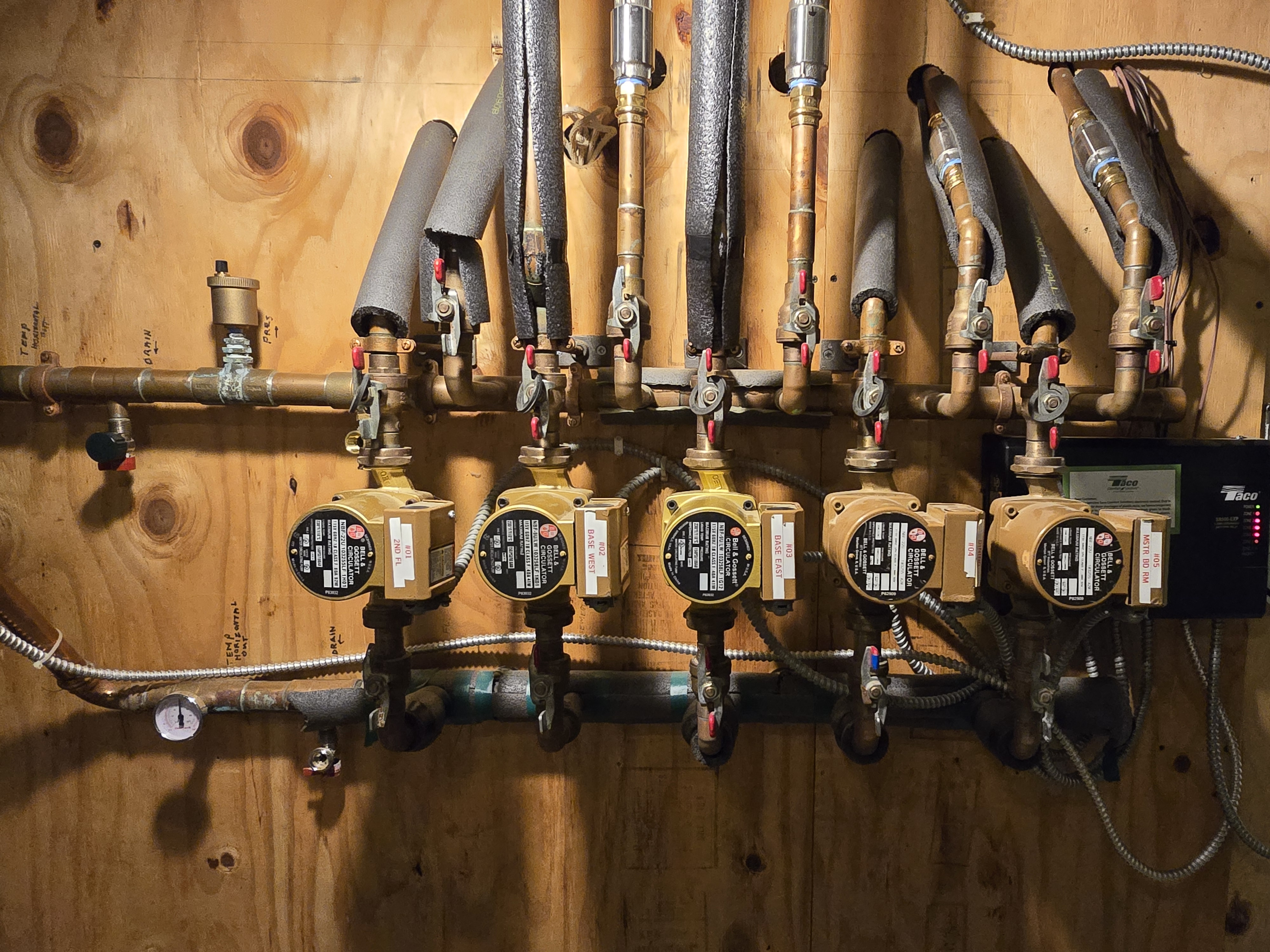

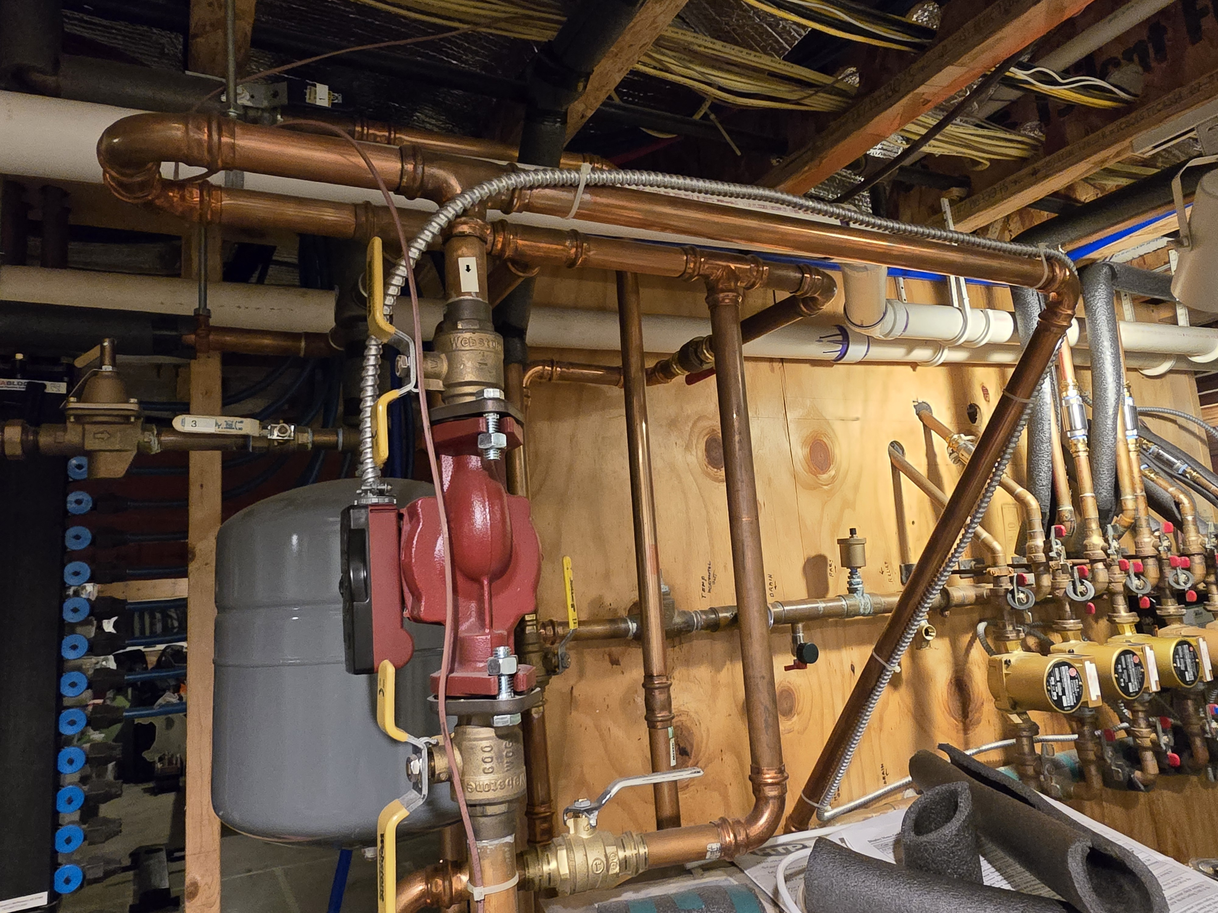

I have an issue with certain radiant heat zones not pumping hot water through the zone when other zones are on.
House that was built in 2002 with floor radiant heat (basement, first, and second floors). There are a total of 5 zones. A couple years ago we had plumbeds install new Taco SR506-EXP 6 zone expandable switching relay. They also installed a few control valves near the pumps that supply the radiant floors to prevent back flow. Each of the 5 zones have their own Bell & Glossett circulators (NBF-9U). This winter we’ve noticed that when certain zones are working, others are not, even if the switch relay is calling for heat (light is on) for that circulator. When a particular zone shuts off, the other one will then start working.
We just had another plumber come out to ensure that there's no air in the system, but it doesn't appear to have solved the issue. It appears that the circulators are working when the relay calls for heat, but when I check that zone with a thermal gun, there's no hot water traveling through the zone.
It seems that last year things were working better. The newest plumber said that it may be the circulators, as they are the old style, and recommends upgrading to newer more powerful ones.
Thoughts?

    those look like bronze DHW recirc. It really depends on how many gpm each zone requires when you size a circulator, plus the radiant loop tube size and length. Any ideas on loop size, how many on each pump?
    Those pumps, 1/40 hp are probably a bit on the small side

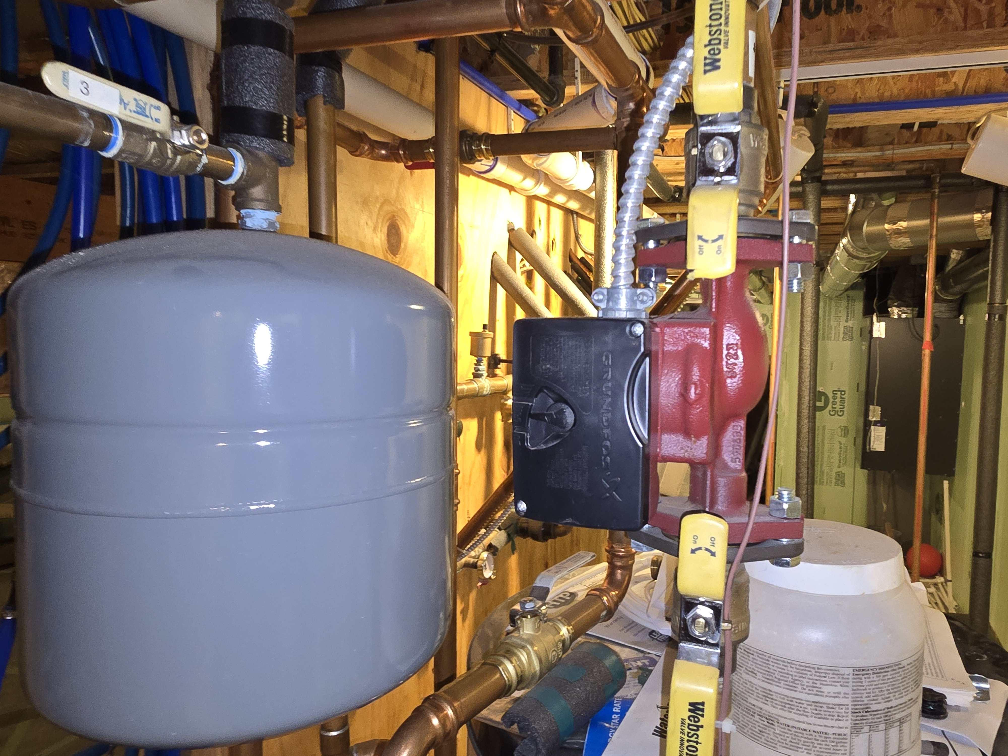

    It looks like some one reduced the piping feeding the existing manifold or at least it seems so being i see a press fitting attached some older soldered fittings.If you operate your trouble non heating zones alone and they work then i would conclude that some one who had repiped it made a mistake . What type of tubing was used pex , rubber and what are the radiant zones in concrete or plates and staple up being i see no mixing valves unless the home is all radiant and the boiler is programed for such operation . I would gather that the boiler was replaced recently and that the issue never happened w the old boiler and piping and pumps ? If the ghost flows and need for the check valves where only needed later then i would say some body screwed up and most likely are clueless when it comes to basic hydronic piping . I see a Grundfos 15-58 is that piped feeding or attached to your radiant manifold if so that may be part of the ghost flow and need to add check valves . Also where the pumps changed due to heating issue as to fix which it did none of? i think you may have the wrong guys working on your system it happens every body knows all until they don't know but they charge for there mistakes and learning on your dime . Also those pumps look like bronze body extra$ which if not a open system is a total waste of money . In closing i see some soldered stuff and then some press i would the press guy changed /repiped something and screwed it up or possibly it been wrong forever and working possibly not as well as it should be . I would say the quality of the work does not appear to be a show case being when i ve done radiant i would make sure that everything was beautiful and functioning and basic pipe sizing gpm where adequate for the load . Not bashing just putting it out there .

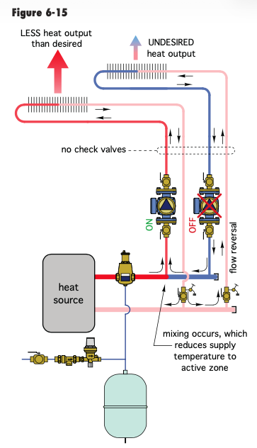

    Assuming the checks are on all circulators, and working properly, not leaking across, then cross flow should not be the issue.
    You would need to know the total gpm requirement, or how many gpm those circs are moving to size the header. Is it a 1 or 1-1/4" header? What is this pipe size reduction at the pump header?
    If 1" 8-10 gpm would be reasonable.
    But if it has worked fine in the past? It worked fine without checks? When were the checks added?
    Those union body pump connections will not allow many pump upgrade options and they will probably be stainless or bronze options $$$$. Unless you source some union body cast pumps from Europe.
    Any filters or strainers in the system that could be restricting adequate flow?
    How does the boiler connect to the pump header, is it a primary secondary, if so there will be some temperature blending going on.

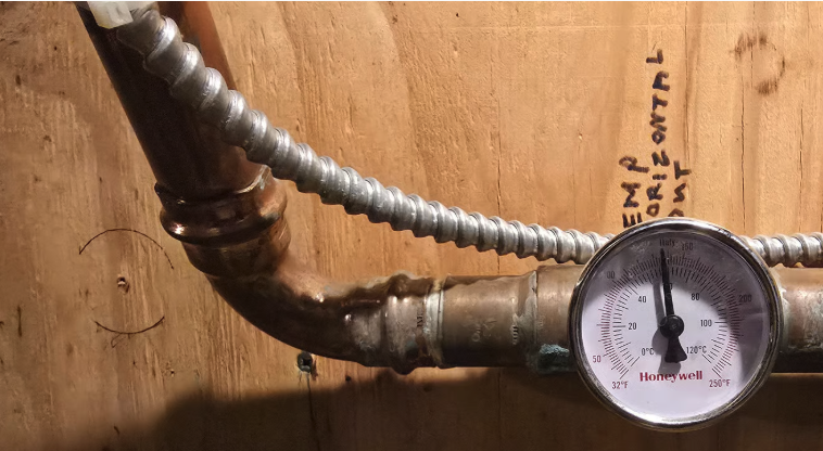

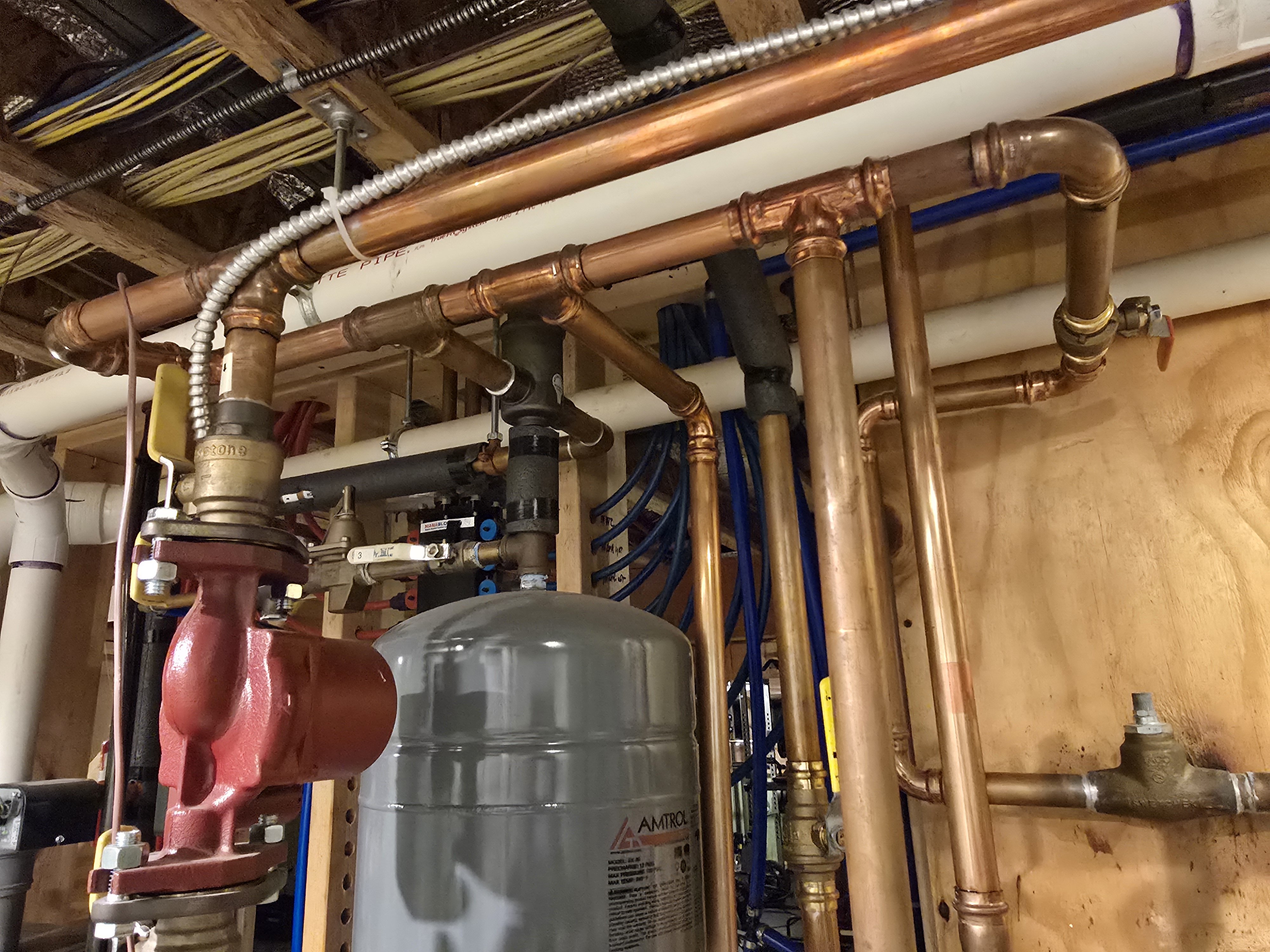

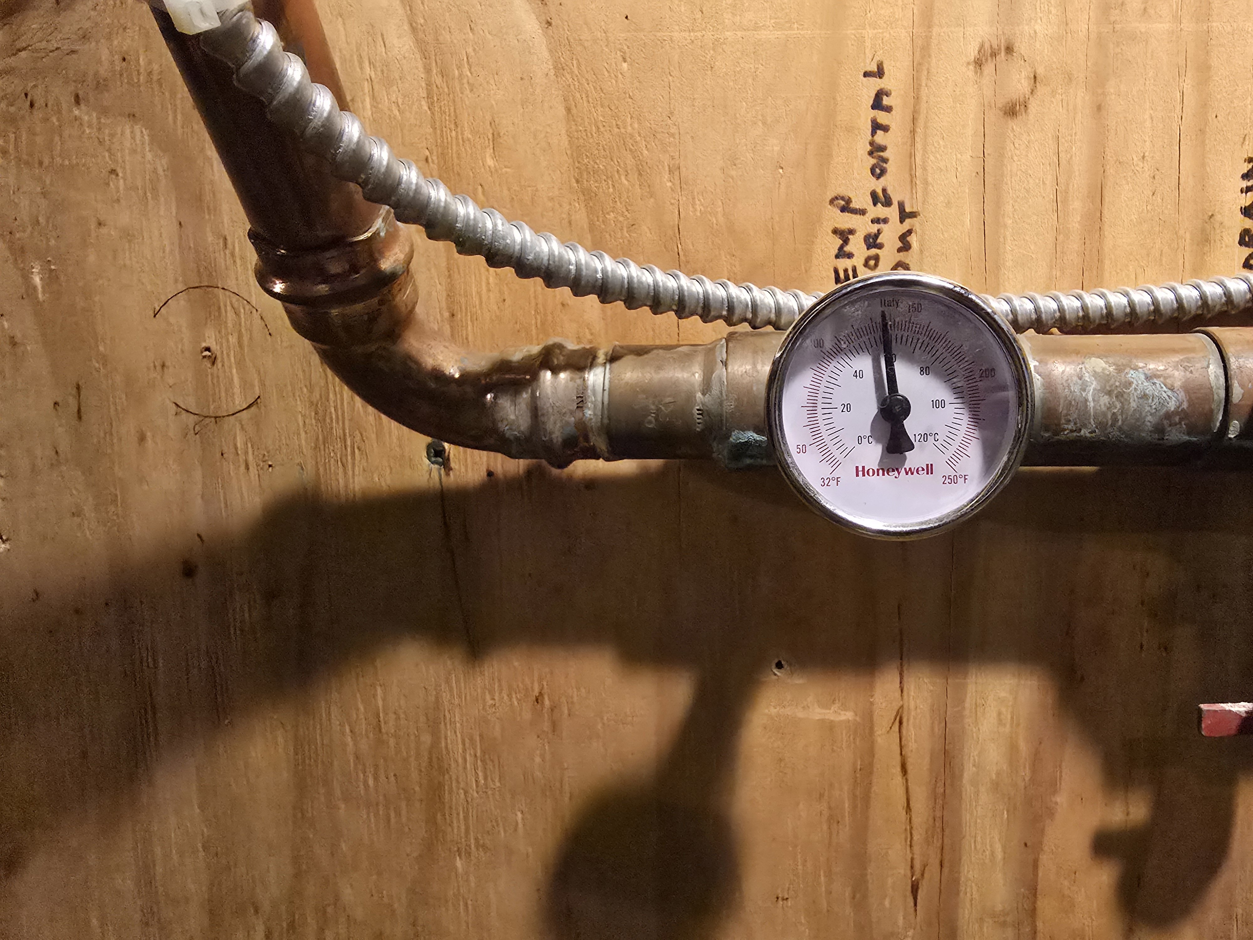

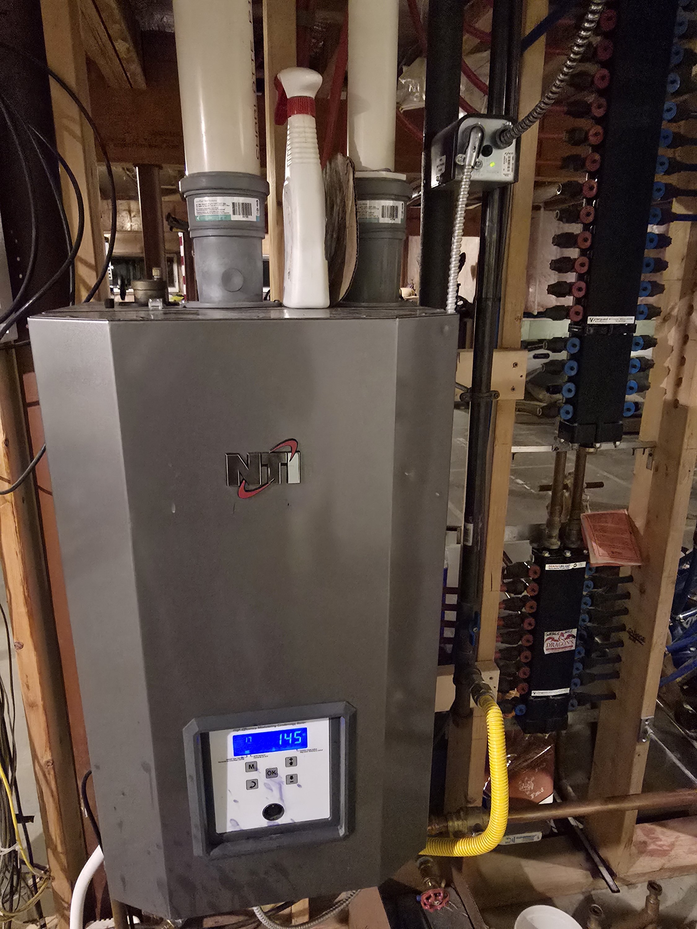

    This is in the US. Yes they are the older union style. House was built in 2002. Below are some pictures of the rest of the system. I'm a surgeon, and overall good are mechanical things, but this water flow has me going bonkers.
    Did have check valves installed on all of the return lines a couple years ago. At that point, the mean reason to have things replumbed with who separate the drinking water from the radiant heat to avoid diseases. Also made it so we can take hot showers regardless of the radiant heat is on, as the domestic water takes priority with the new relay.
    Our basement has the lines running through the slab. Our first and second floors has it running just under the subfloor using 1 in clear plastic line. Not exactly sure what it's called.
    The profile pic is of my 16yo white cat 😺 🐈, nice catch haha.

    Just fwiw usually mod con are piped primary secondary using 2 closely spaced tees or as most do a hydroseparator which none of which i see which just about any body installing mod con correctly would not install without using so to cut to the chase who ever installed needs to place the tools down and chose another profession . Also stating that your portable water had to be separated from your heating system is some thing in my part of the woods no one would think of doing w out be sued and the one or two set up i ve seen where all by home owner diy and worked horribly and cost a fortune to operate and work terrible . i could see some using a tankless water heater and trying to get it to work but they never do it to well . I think i would toss those b n g pumps install some grundfos 15.58 pump w checks for starters and get some one who truly knows hydronics to be repiped.While operating the heatings zones ae you getting thermal migration from the domestic hw tank ? Business is quite savage and most never have a idea of whether there getting ripped or even if the guy has a clue really rough out there . I personally do not claim nor ever to be the worlds best mechanic but it dont take being one to see that your install was sub par lacking really proper planning and execution ,it may work w issues but most professional installed system do not have these issues .It s the one installed by the rule of thumb and low ball pricing that are full of issue some which can not be straighten out because money was saved for other things in the home that seemed more important . The pic of your system is basically why i dont even bother trying to sell radiant to the people because done properly its costs alot $ so i dont argue and haggle i let some one else do it for way cheaper and usually it works like crap also being older and on the final end of a given life span why would i waste my time even figuring it out being they will not like the price and i certainly am not working for free . Radiant done properly isn t just in the boiler room thats the cheapest area even going top of the line its all the other stuff like tubing lay out surface contact the r valve of flooring and insulation and box and end beam closure and manifolds .all this is whats the most important and usually hand off to some one else that say it does not matter . Being you seem to have light style plates and larger tubing for the staple up is a issue to me being those types of system usually have to operate at a high temps to work properly plus there the cheapest type of fly by night not real radiant usually installed for about 1/3 the price of a real plate system and the plate system operate at a much lower temps and lower fuel usage . None of this is a rant just a clear expression of what really goes on out there and what some call a professional install done by some without a clue ,this is a reason why hydronics and radiant is such a small section of the heating industry and getting smaller . Sad to see that real pride and quality done by peopel is crap . This why some don t even bother because how do price against some one who really does not care about what they do or is it that they just don t know and are following what some one told them to do clearly they get paid . sorry state of the heating industry peace and good luck clammy
