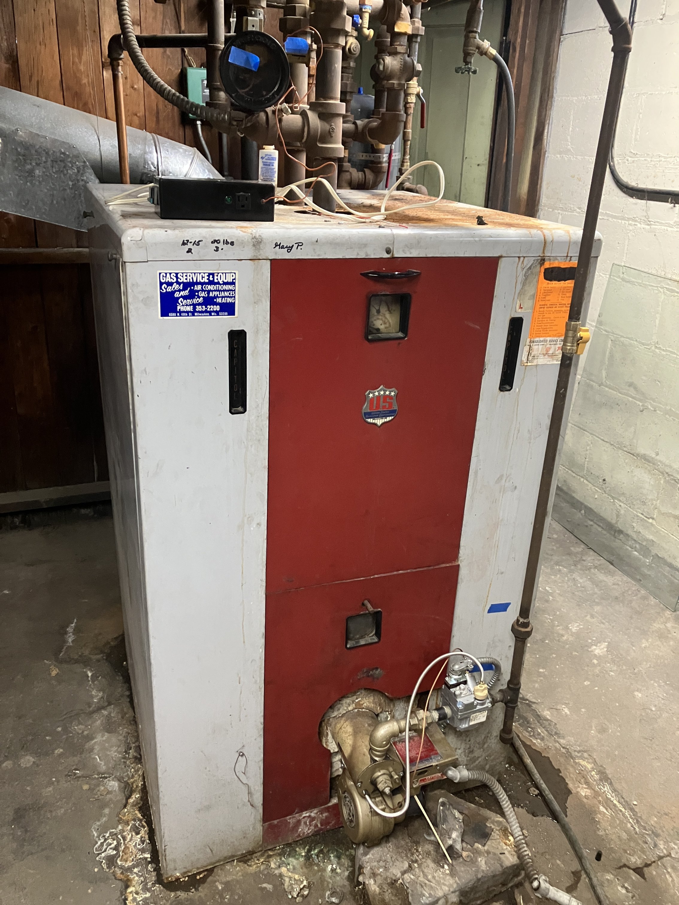

    Maybe off topic but what is leaking ?
    mattmia2Bernie_the_Brewer

  • Nothing now! :) That was an old picture from when I was bringing the old girl back up to snuff from the previous owners. It had a vastly undersized expansion tank (presumably because they didn't take the large volume of the gravity system into account). The HH forum helped me figure out a number of things, including that.
