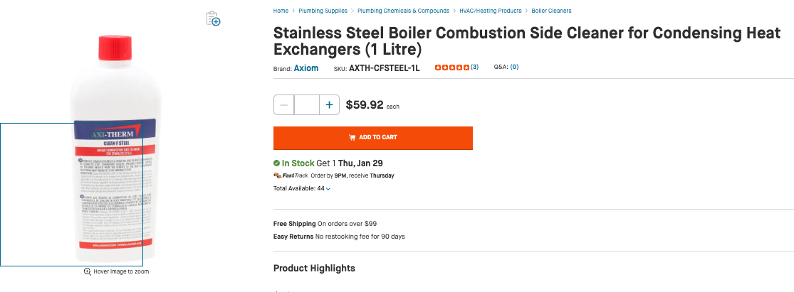

If you are in doubt just get a bottle of the cleaners designed for the boiler.
Most important is to try and isolate the boiler and run the cleaner. If you add the cleaner to the entire system it dilutes it to the point of little usefulness.
Personally I would open it up and clean the fire side along with the internal waterways. There are a number of brands available
