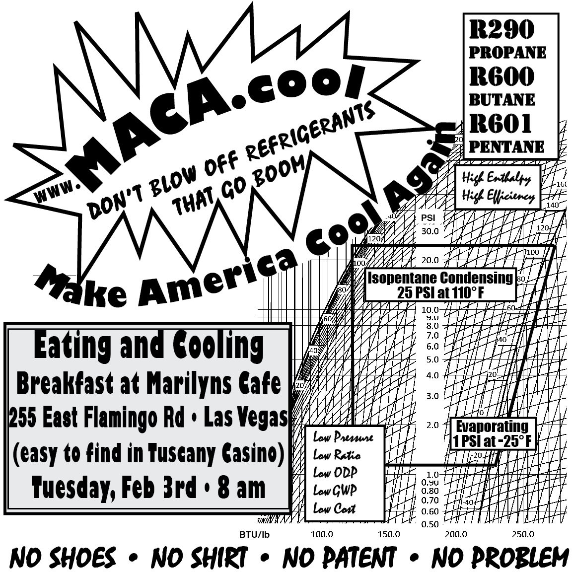

Been talking nothing but steam lately and I sure am steamed up about the insane refrigerant regulations. So I'm back propounding flammable refrigerants that work on small fixed charges at pressures as much as an order of magnitude less than the junk they're pushing on us and are non-patentable naturally occurring compounds. And otherwise want to talk about whatever you want to talk about instead of grinding my axe.

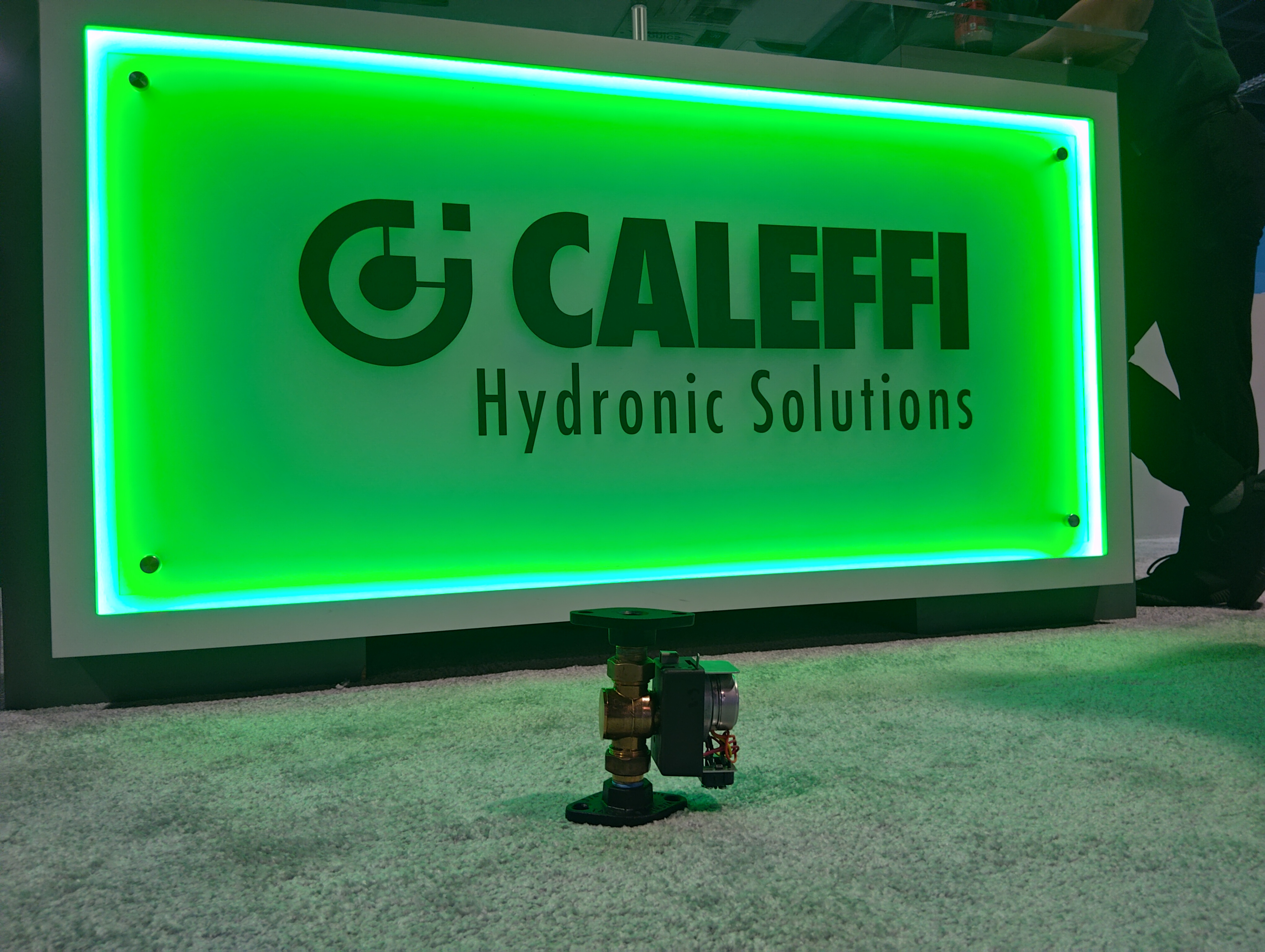

    had coffee without caleffi today for the first time in a few daze cause i'm home, but look what @hot_rod cooked up besides the cappucino. convert from multiple pumps to multiple zone valves:
    albeit coolest find of the show because of my interest in flammable refrigerants was spacepak R290 5 ton chiller style heat pump. still waiting to get the COP curves but 167deg F out. once they get me a cut sheet and availabilities i'll post.
    they recommend 35% 1,2 propanediol (PG) for burst vs freeze protection since you are going to be in heat mode enough to keep it from slushing anyway unless something goes wrong in which case you want to protect against burst because of the portion of the hydronic circuit that is outside (although 1,3 propanediol (PDO) has lower viscosity. a little harder to find a direct specific heat comparison although AI says the thermal properities of PDO are superious. it's more expensive albeit less toxic. I wish I had spent more time at a few chemistry booths although we got installer show at javitts and eastern energy at mohegan sun coming up. don't know how many chemists will be at those.
    I'm really impressed although i'll be even more impressed when they start using the lowest pressure isomers like isopentane because I think with the lower pressures you could even more easily make service compenents with isolation and modular unions that wouldn't be subject to leaks in the comparatively lower operating pressures. but guy at booth (damnation thought i got his card) said they didn't want to be too exotic seeming and propane has bigger installed base at the moment. true isopentane is more expensive but we're talking $400 for a metric ton of propane, $1300 for a metric ton of isopentane and $55,000 for a metric ton of R32- just sayin'.
