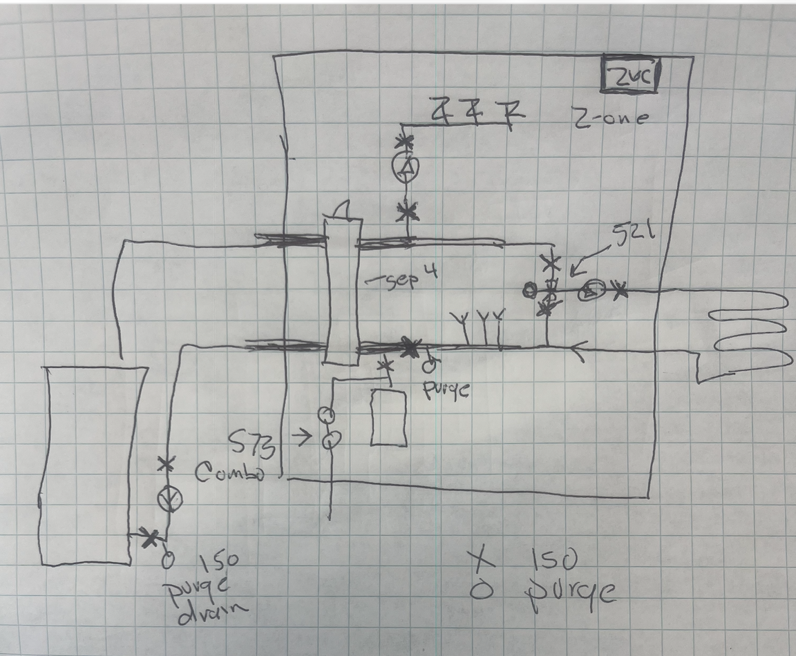

If you have access to an experienced pipefitter, build your own. Build it on a bench and pressure test so it is ready to hang and connect.
Probably fit all those components on a 4x4 sheet of plywood, maybe smaller if you are squeezed for space?
Relay box in upper right above all the piping
Sep 4, a 1" if the boiler is 100,000 btu/hr or smaller
Z-one zone valves
573 combo fill backflow
#30 expansion tank
521 mix valve
2- Alpha 15-58 circs 1 high temperature, one after mix valve
ZVC relay box 4 zone so you have a spare

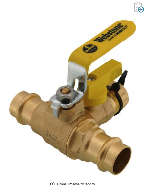

2- 1" Webstone purge iso valves at sep and at boiler return
misc iso valves
3 fin tube zones would not need a boiler protection device
