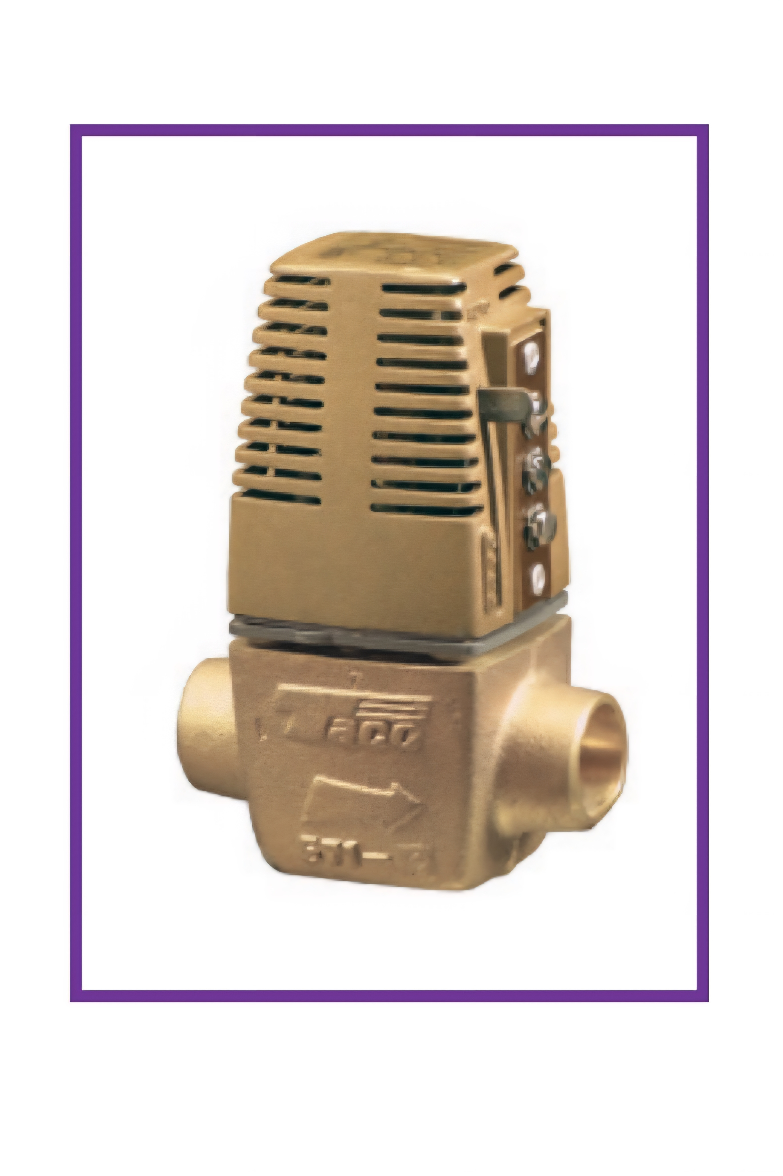

I have a 35+ year old Burnham boiler that had been working well. It is not heating one of the zones. Temperatures are freezing cold with blizzard on the way. I am hoping to troubleshoot. It is set to automatic. Oil tank full. The filter is relatively new. Thermostat is 1 year old and basic. It may be zone valve. I just switched to open and heat pipe heated up. Any suggestions?

    bburd: hot water. Two zones I just opened the zone valve on the one that had cold pipes. It is heating up now. I think I might have found it. But why in open position? Thermostat room temp is currently 50 when set to 68

    Most likely the zone valve power head has failed, or it could be a problem in the thermostat circuit or zone valve end switch circuit. You can check these things with a multimeter if you are handy with electricity. If not, it might be best to call for service.
    For now, since the weather is very cold, I suggest you leave the zone valve manually opened. That zone will heat at the same time as the other zone, so you should be protected from frozen pipes.

    BBurd: The heat is on but very slow. Went up from 48 degrees F to 55 in 12 hours. Leaving the switch to open works but very slow. Filters new last year. We checked the zone valve 3 wires (red, white and green) with a multimeter and it appears to be working same as other. Zone 2 upstairs is working beautifully. The boiler heats and then shuts off, even when it doesn’t get to set point. But I am happy that it is warmer- we just prevented pipe bursting. 55 and slowly rising. Should I buy a new zone valve at some point? They predict we will have about 16 inches of snow starting this afternoon and frigid cold so may need to wait. I so much appreciate your help.
    check if there is 24vac on the zone valve motor terminals when the thermostat is calling for heat. is the valve open if there is? if there is but the boiler is not firing, check the end switch terminals, it should be 0 vac because they should short together when the valve opens.
    the other zone that is cold will be slow to heat with the valve open but no call for heat, it will only heat when the other zone is calling and that zone is up to temp so it is only calling for heat to make up for loss, not to increase the temp. the system may only be able to provide the heat lost, not also increase the temp if you are at the temp the system was designed for.
    bburdsnickers
    HVACNUT Posts: 7,784
    Can you post a picture of the zone valve? Is it this?
    If so, you likely just need a replacement head. Double check the plunger moves freely and there's no corrosion around the pin.

    Yes. It is a taco that looks like that. Ok. Replacement of
    There was an error displaying this embed.
    the head. I will check it. Here is a photo.

    that heat motor type zone valve has a common terminal between the heater for the heat motor and the end switch so you test from that common terminal for 24vac to open the valve and shorted terminals to call the boiler.

    Your Taco 570 series zone valve can cause the best of plumbers and electricians to go batty trying to understand how they get it to work with only three wires.  The motor needs 2 wires and the end switch needs 2 wires.  That adds up to 4 wires.  So don't feel bad if you don't understand what is happening.  You are not the only one!
    What you have described is a classic problem when a power head goes bad.  Replacing the power head with the identical power head is the best repair for you.  You don't even need to leave the house to get one.  You can get it at SupplyHouse.com if you have a computer or smart phone.  (I guess you do if you are on this forum)
    Click here for the info: Taco 555-050RP
    Take a picture of the wires before you take the wires off the old power head.

    hot_rod Posts: 28,704
    the speed at which it catches up depends mostly on outdoor temperature and amount of heat emitters you have
    If the boiler cycles off when both zones are heating you have more than enough boiler capacity
    It is not unusual for that ZV motor and the valve piston operation to be comprised
    Buy an entire new valve do you have both components if needed
